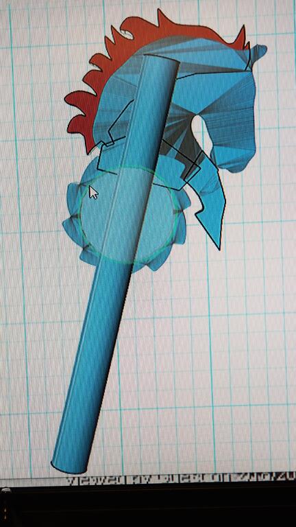

As long as theres enough thread to work with, thats a perfect solution. I had planned the shaft to go deeper into the head though, with a portion of the bottom as a collar. Figured this would distribute the forces of shifting better.20220319_153126.jpg.373f73932a9b65f09299ce74b0d818b3.jpg

Yeah, I see where you are going on this and it's a good idea.
More involved, but a setscrew through a small hole in the "wheel" part to grip the shaft solely to prevent rotation? Could still use a dab of purple loctite just to prevent wiggling?
Last wacky idea: ship the mandrel and the horse separately so the owner can thread the mandrel onto the shifter (again, purple loctite?) and then use their favorite adhesive to glue the horse to the mandrel with the horse positioned as they want it.

Thats an interesting thought! A bit of acetone would be all that would be required.

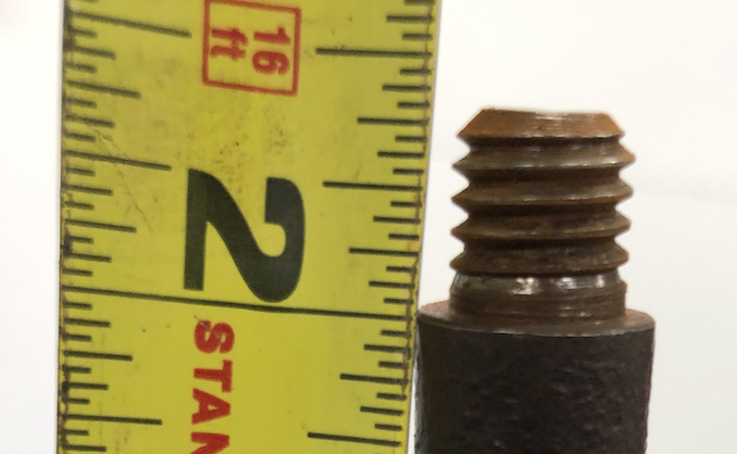

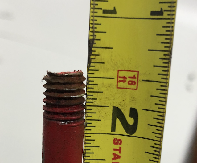

The more I think on it, this may be exactly what is needed. Could then use a standard thread on insert, and apply it to all different shapes of custom shifter. Can anyone verify for me the shifter thread size, thread length, and diameter of the unthreaded portion of the shaft?

⅜-16 on both R-1-2-3 and H-L
~⅜ of usable thread on each
Hi-Low on ⅜" shaft
R-1-2-3 on ½" shaft

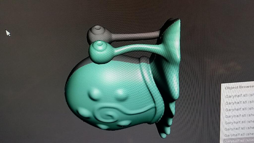

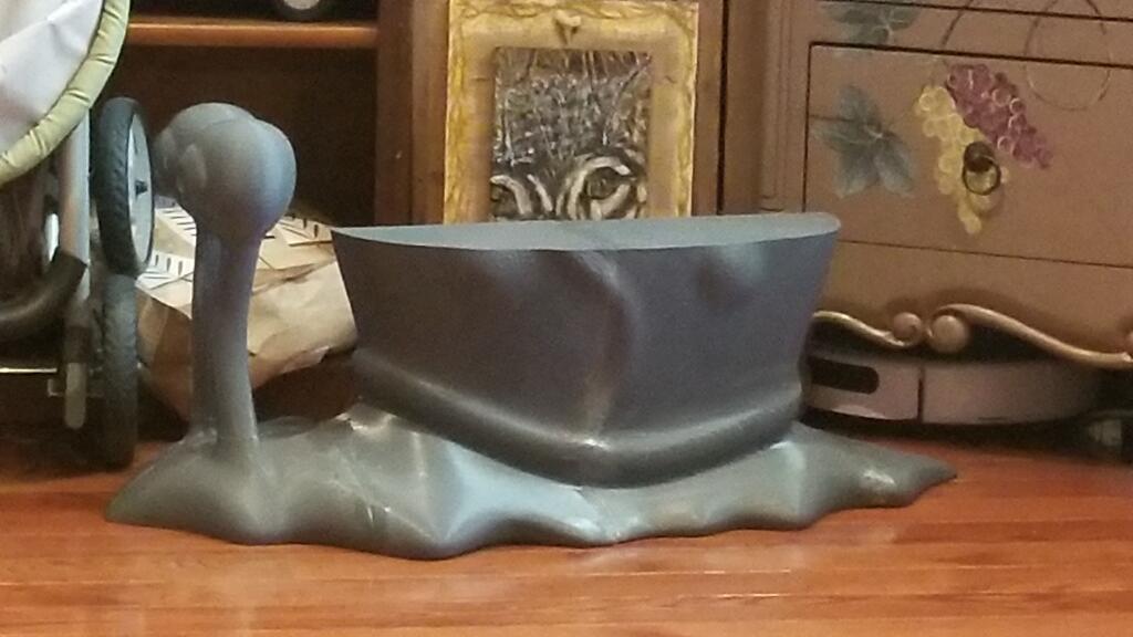

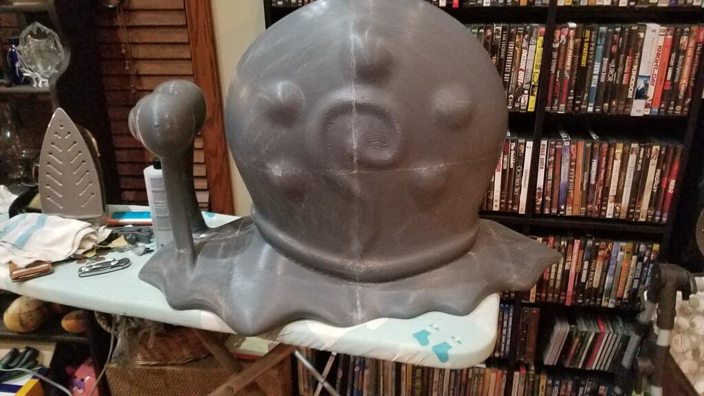

Latest custom order.....a 20" tall Gary the Snail ??????!!!!!!!! Will take 14 individual pieces some weighing almost 2 lbs and requiring 2 days to print the larger pieces. Yikes!
  • Haha 2
  • Heart 2
Gary the snail is the most awesomest
Wheel Horse 3D

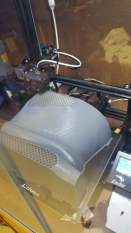

Almost done. Now to repeat this 13 more times lol
  • Confused 1
Wheel Horse 3D

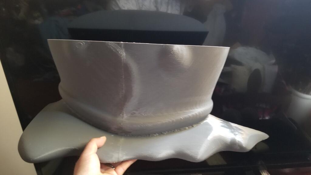

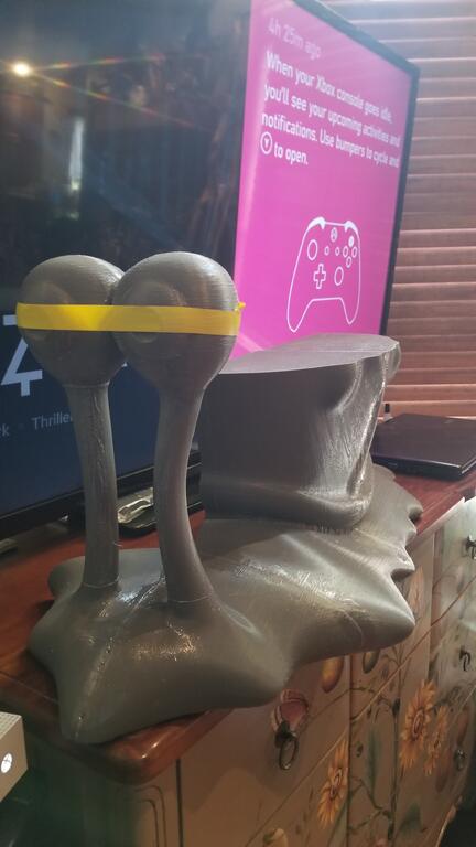

And the fun continues!
Wheel Horse 3D

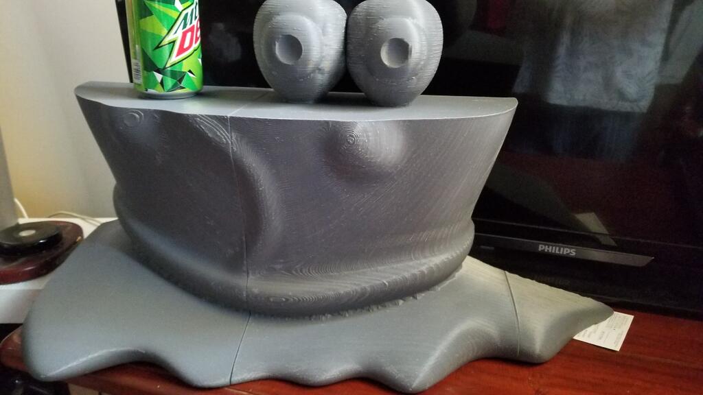

Today got some more done! One of the upper shell pieces is almost finished as well.
Wheel Horse 3D

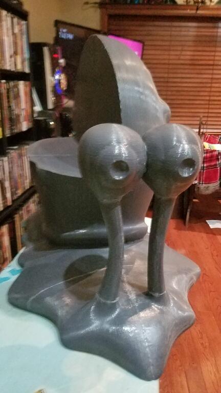

4 more pieces to go!
  • Excellent 3
Wheel Horse 3D

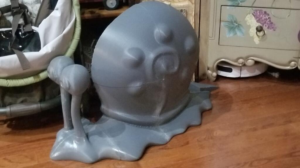

Only 2 left, and did some assembly, welding and filling

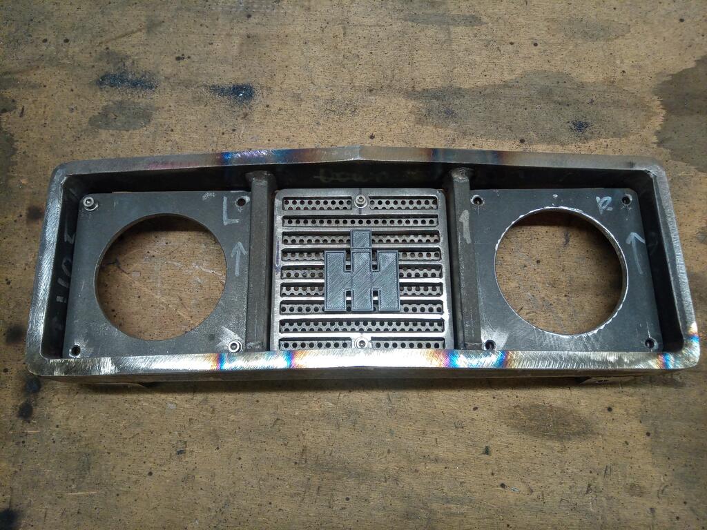

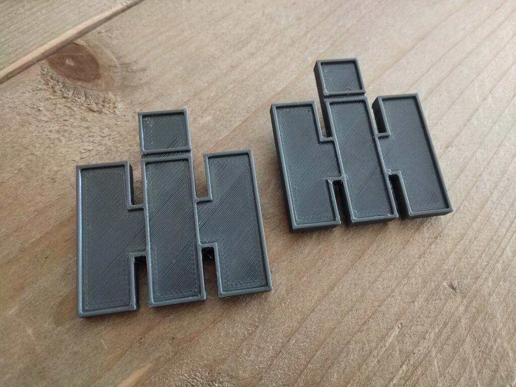

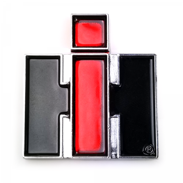

Since Gary is acceptable I thought you might also enjoy my custom 3D printed IH logo I made for my 'Murray to IH 1568 project'.
Couldn't find a suitable off the shelf logo in the right scale so decided I would try to 3D print it.
I drew this myself in fusion360 and then had somebody else print it for me. Came out pretty good.
Plan is to paint it in the correct colors obviously ;)

Could also be done as a multi color print! Just now tinkering with manual filament changes mid print. Eventually i intend to get at least a 4 color multi material type unit.
sjoemie himself
Funny you should mention that. The man that printed the logo for me said exactly the same!
I opted to not go that route so that I can match the paint with the rest of the tractor.
When I sent the example he said "well maybe it's better to paint it if you want it to match precisely".. :dunno:

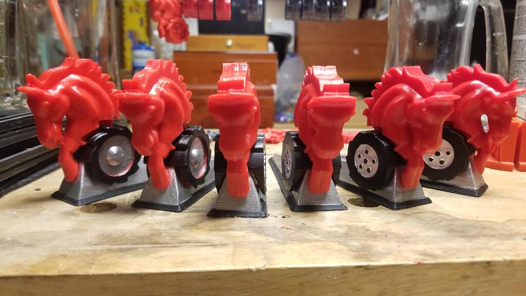

Getting a filament to match a color like RED is a pain, in here somewhere is documented the search for a decent "Red". We had orangy red, reddish orange, blaze red, iron red, brick red till i finally came across "Enzo Red" from one specific manufacturer that was the same color as regular red testors enamel.
sjoemie himself
Than i'm glad I chose the paint route.
Seems to me the red fillaments turn out a little 'flat' or 'bleached' once printed.
Wheel Horse 3D
These horses were done in the enzo red..but again, getting that correct color was a pain
