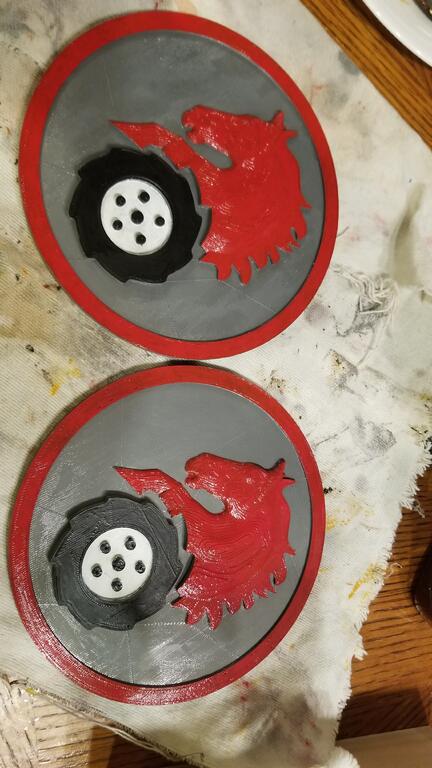

I finally found a few minutes to start finishing my hood ornaments.
First one i'm getting ready for a rusty finish. This primer has to dry until tomorrow. Then I will be painting it with a paint that contains iron dust.
Second one is getting ready for a chrome finish. This high gloss black will have to dry for about a week before the chrome finish can be applied.
I'll keep you updated with my progress.

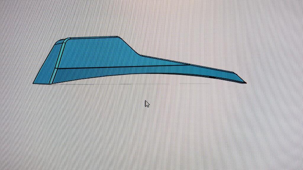

Next project.... thinking 12x12x4"

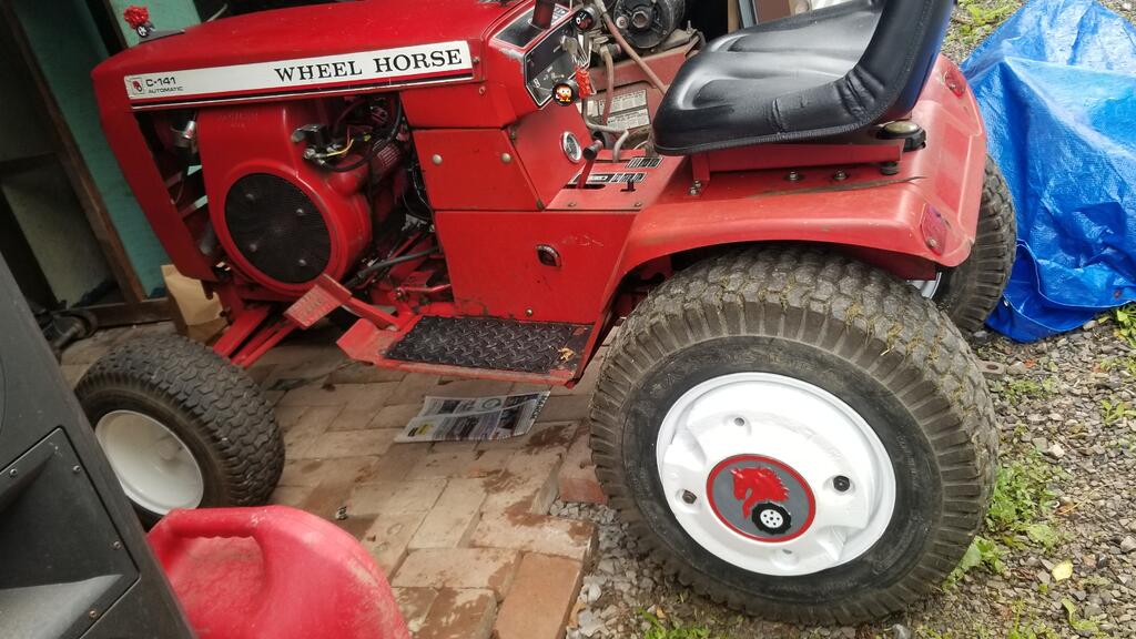

6 inch hubcaps for wheel weights
Wheel Horse 3D
Wheel weight Hubcaps done! Made an error somewhere in diameter that resulted in a better overall design. The plastic still provides the spring but added screws make the tension and depth adjustable and the disk fits just inside the rim of the weight!

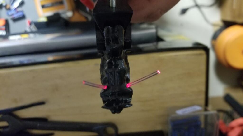

A few weeks ago I posted that I was starting to finish my hood ornaments. Tonight I was finally able to work on the chrome finish on the second one. So far I am quite impressed with the product that I choose.
The Horse head still needs a little light buffing in some areas to remove some over spray.
I'm sure that you are all wondering what I used and I am more than happy to share.
http://www.motostorm.com/Motochrome-chrome-paint.html
Edited by Achto
  • Excellent 5
  • Heart 3

So lots of sanding, 4k gloss black URETHANE, then your finish?
Achto
The Chrome is sprayed in multiple light coats. First coat did not even look like I did anything, 8 coats of chrome paint to achieve the final finish.
Tomorrow it will get a couple coats of Moto Storm MototClear to protect the finish.
