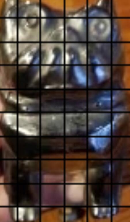

Tryin to figure out how im gonna duplicate and modify. Maybe take a marker and divide him into 5mm slices, measure and duplicate each slice and stack em up.
Wheel Horse 3D
Maybe i could drop some pics of him on a grid in blender.
Wheel Horse 3D
Take me piece of plexi, put a grid on it, and put him just behind the grid! Then some pics and I've got something to work with!
Drop the patent pic behind rhe grid too. Should show me the mods needed for the original 30s model. Then just have to get the size correct.

Or i could just find an app for that!
