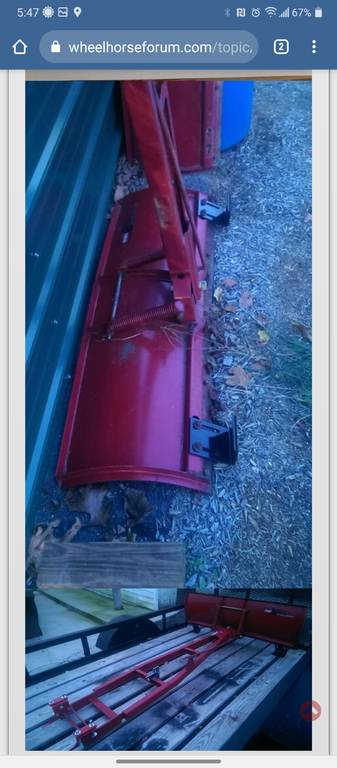

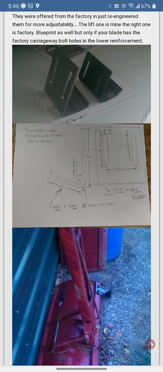

WVHillbilly520H 10,379 #2 Posted January 27, 2021 With the snow blower you have to keep the skids adjusted as low as they go for maximum scraper height, and the top deflector pointed down to only throw short distances, there is a wire stone "deflector" that was used on the WH tall chute singles but its was mediocre at best. As I posted in the other thread the skid shoes for the blade if you have the factory carriage bolt holes... If you lock closely at the blade with black shoes in back of it is another blade you can see the holes for mounting. 4 Share this post Link to post Share on other sites

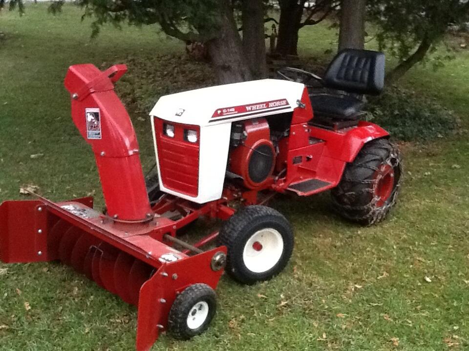

squonk 48,215 #14 Posted January 28, 2021 I put wheels on a walk behind years ago. Worked good. Stole them off a push mower. Share this post Link to post Share on other sites

Jeff-C175 7,211 #17 Posted January 28, 2021 (edited) 19 hours ago, squonk said: Remove the blower skids and install pneumatic wheels Actually, the blower does pretty well. The only time there's an issue is with a wet snow before there's a hard freeze and I'm going too fast. Then I end up pulling up chunks of the wet snow with the rocks embedded. I don't think there any way around that though. I DID give thought to tires / wheels on the end of the plow blade though! In fact, the rubber sweep and the 2" PVC pipe works fairly well too. Best / and cheap like me / thing I've tried yet. So good in fact that I'm considering putting a full length across the bottom of the blade. I think it might 'ride up' and pack the snow though so I might need to go to solid link so I can provide some down force. 4 hours ago, WVHillbilly520H said: his is a walkbehind blower. Indeed it is, POS Craftsman / Murray with the really crappy gear box on the auger drive. Next time it breaks I'm pulling the engine and scrapping it. Or maybe I'll put a piece of plywood on the front and use it as a walk behind plow. I only use it for the walks so I don't tear them up with the tahr chains. Edited January 28, 2021 by Jeff-C175 Share this post Link to post Share on other sites
Ed Kennell 47,597 #18 Posted January 28, 2021 2 minutes ago, Jeff-C175 said: wheels on the end of the plow blade though! 2 Share this post Link to post Share on other sites
