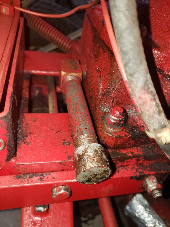

CB1993 34 #1 Posted January 24, 2021 Has anyone seen an engine oil drain like this? This is on a k241 engine. This might be common but I am new to wheel horse. I can't seem to find any pictures of a drain plug like this. Thanks! 3 Share this post Link to post Share on other sites
ebinmaine 80,767 #2 Posted January 24, 2021 Yepp. Grabation by pliers. 'Bout blew my mind first time I saw a round one. 2 Share this post Link to post Share on other sites
rj35hunter 309 #3 Posted January 24, 2021 Yes completely stock for certain years maybe mid 60’s to early 70’s range....I know by 72 and up they changed to hex head 1 Share this post Link to post Share on other sites
squonk 48,163 #4 Posted January 24, 2021 Yup. More than once. I think that's 3/8" pipe. You can go to a hardware store and get a pipe coupler and a square head pipe plug. Then change the oil and you will be able to use an adjustable wrench next time 4 Share this post Link to post Share on other sites

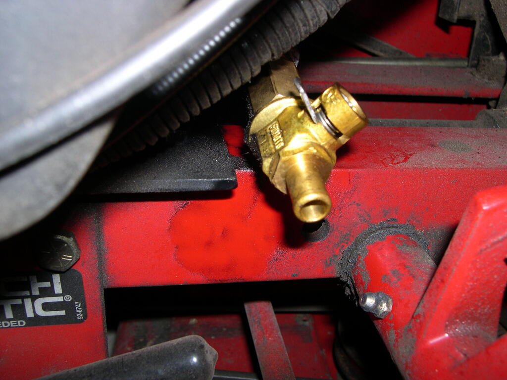

Racinbob 13,200 #5 Posted January 24, 2021 I've had a few like that years ago. Now I replace them with this: 5 7 Share this post Link to post Share on other sites

roadapples 6,987 #7 Posted January 24, 2021 2 hours ago, Racinbob said: I've had a few like that years ago. Now I replace them with this: What is "this" called.. 2 Share this post Link to post Share on other sites
Racinbob 13,200 #8 Posted January 24, 2021 It's called an EZ Drain. A piece of tubing slides on that nipple and into a jug. I have one on my truck too. Love them. 6 1 Share this post Link to post Share on other sites
Achto 32,795 #9 Posted January 24, 2021 1 hour ago, roadapples said: What is "this" called Another company that makes them is Fumoto valve. They can be purchased in several variations. https://www.fumotooildrainvalve.com/?gclid=Cj0KCQiA0rSABhDlARIsAJtjfCdEVRsOW2JHYVwssVs9HYbsh10zgbCuVkKobwi-5FH3iQ9eJ9K0ZHYaAilTEALw_wcB 3 Share this post Link to post Share on other sites

Racinbob 13,200 #16 Posted January 25, 2021 16 hours ago, Achto said: Another company that makes them is Fumoto valve. They can be purchased in several variations. https://www.fumotooildrainvalve.com/?gclid=Cj0KCQiA0rSABhDlARIsAJtjfCdEVRsOW2JHYVwssVs9HYbsh10zgbCuVkKobwi-5FH3iQ9eJ9K0ZHYaAilTEALw_wcB That's where I get mine. I just call them EZ Drain. 37 minutes ago, Achto said: Only down side of a normal 1/4 turn valve is that the handle does not lock in place. On the EZ drain and Fumoto valves you have to lift the handle to be able to open the valve. This gives less chance of it opening by mistake. Excellent point. A fairly recent addition they include with their valves now is a little plastic piece that prevents you from lifting the lever out of the locked position. I don't use it in my applications but I'm sure there are some situations that would warrant using it. 1 Share this post Link to post Share on other sites

Racinbob 13,200 #20 Posted January 25, 2021 1 hour ago, 71_Bronco said: I need to add some pipe to my engine to make the drain come out the side. Transplanted engine just has the plug in the center. I'm going to be trying out one of those EZ valve that @squonk posted. If the 3/8 NPT is correct, it's part number EZ-110. On a side note, my '68 Commando 8 has the round "plug" as shown in the original picture. Had to use pliers to get it off due to it's smooth round body. The hex cap looks like it would be a much better option. EDIT: Looks like that "EZ Drain" brand all have male threads, so a coupling would be required between the extension pipe and the valve. Did you need a coupling on yours @Racinbob? Yes, I did use a coupling. From the galvanized 90° on the back of the engine I installed a short brass nipple, a brass coupling then the valve. I didn't use an EZ brand. It's from the link that Dan posted. Fumoto. Share this post Link to post Share on other sites
briankd 833 #21 Posted January 26, 2021 On 1/24/2021 at 11:25 AM, CB1993 said: Has anyone seen an engine oil drain like this? This is on a k241 engine. This might be common but I am new to wheel horse. I can't seem to find any pictures of a drain plug like this. Thanks! my 857 has the same plug and i never changed it all these years just use a vise grip and screw it off and put it right back on no problems Share this post Link to post Share on other sites

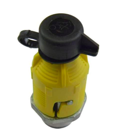

Chestnut 315 #22 Posted January 27, 2021 This drain valve came on a tractor made by that 3 letter company that's acquired so many brands. My MIL bought the tractor a few years ago. It is certainly easy to use, push and twist action. Don't know what threads. I know a lot of members here would much rather a metal valve body rather than CPS, but it could be another option. 1 Share this post Link to post Share on other sites
Jeff-C175 7,211 #23 Posted January 27, 2021 (edited) 1 hour ago, Chestnut said: Don't know what threads I believe that's the typical 3/8 pipe thread. I've got one on a snow blower and it seems to work OK. Been on there since I got it quite a few years ago. No leaks. Hint to those who still have the pipe caps, if you get a 90° elbow, you can use a plug with a square head as a stopper, and point it DOWN when installed. The nipple won't try to unscrew when you pull the plug to drain the oil. Might need a longer nipple to reach past the frame rail though. Edited January 27, 2021 by Jeff-C175 2 Share this post Link to post Share on other sites
Chestnut 315 #24 Posted January 27, 2021 1 hour ago, Jeff-C175 said: I believe that's the typical 3/8 pipe thread. I thought so but didn't want to commit. I think the oil filter on that tractor has metric threads Share this post Link to post Share on other sites
