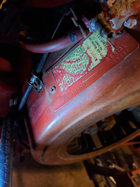

Berny 9 #1 Posted January 20, 2021 I have a wheel horse C-160 that I have been trying to fix up. It has the Tecumseh HH-160 engine. Today I found out it has low compression, which was a major bummer. I need to open up the engine and do the piston rings, head gaskets etc. I found the piston rings, but I haven't been able to locate a gasket kit for this engine anywhere online. It's tough because Tecumseh has been out of business for 20+ years. Also, it seems most C-160s had the kohler engine. I can't even find a good service manual for it! Does anyone know where I can buy the gasket kit for this engine? If I can't find it, should I try to swap out the engine? With what? Any idea where I can find a good service manual? Thanks a ton! Share this post Link to post Share on other sites

gwest_ca-(File Mod) 12,532 #4 Posted January 20, 2021 May be listed as HH-160 as it was later changed to OH-160 Parts lists https://www.partstree.com/models/oh160-170019-tecumseh-engine Garry 1 Share this post Link to post Share on other sites

Berny 9 #10 Posted January 20, 2021 7 hours ago, gwest_ca said: May be listed as HH-160 as it was later changed to OH-160 Garry, Thank you so much! Are you certain the OH160 is the same engine? If that is the case it solves a ton of my problems. On another forum I read another post about the OH being a much newer and different motor. However, looking at those diagrams, they sure do look like my engine. I do have that manual you posted, but it didn't include HH160 in the models it covered. You may have solved the problem. Thank you! Share this post Link to post Share on other sites

ebinmaine 81,138 #12 Posted January 20, 2021 6 minutes ago, Berny said: Garry, Thank you so much! Are you certain the OH160 is the same engine? If that is the case it solves a ton of my problems. On another forum I read another post about the OH being a much newer and different motor. However, looking at those diagrams, they sure do look like my engine. I do have that manual you posted, but it didn't include HH160 in the models it covered. You may have solved the problem. Thank you! Berny the way I understand it is that the early 70s 16 was an ohv of a very early type. @Stepney can you shed any light here? Not sure who else knows Sears tractors... @jabelman @ZXT ? Share this post Link to post Share on other sites
Berny 9 #13 Posted January 20, 2021 35 minutes ago, ebinmaine said: Berny the way I understand it is that the early 70s 16 was an ohv of a very early type. Thank you! A couple days ago I found a table of Tecumseh models and what the letters mean. Of course I can't find it now, but basically the HH is horizontal heavy duty, and the OH refers overhead valve. So mine is an HH, but it certainly had overhead valves, so the question is if it is the same basic engine as the OH160? If I buy a gasket kit for the OH160, will it fit my engine? Is the OH just an updated model number for the same engine? If you or the users you mentioned could shed some light on this, I sure would be grateful! Also, I will look into getting a rebuild kohler that fits, that is a good idea! Thanks! 1 Share this post Link to post Share on other sites

gwest_ca-(File Mod) 12,532 #15 Posted January 20, 2021 I don't know if there ever was a 16hp flat head engine. I know the first overhead valve models were labelled a HH160 and they changed the name to OH160 to better identify them. Garry 2 Share this post Link to post Share on other sites
Stepney 2,356 #16 Posted January 20, 2021 I've been around a lot of Sears, and Teccy in general.. AFAIK, there was, in the HH lineup, a 12, 10, 9, 8, and so on down the line. An OHV OH140 shares internals to a point with the 10hp flathead, and the 16hp OHV shares that of the HH120 12hp. As I remember it in my giant Tec book from the 70s. I think they planted an OHV 12hp in there for a short period.. But chances are, it's an OH160. I've never heard of an HH160 in any of my books, and they date that period. Tec could get weird with stuff though.. My best advice is study your engine and lots of pictures, and take measurements before so much as thinking about buying a single bit. I've seen many a botched-built original Tec with oddball oversize parts or undersize here or there. 1 Share this post Link to post Share on other sites
Berny 9 #17 Posted January 21, 2021 22 hours ago, gwest_ca said: I don't know if there ever was a 16hp flat head engine. I know the first overhead valve models were labelled a HH160 and they changed the name to OH160 to better identify them. Garry That is wonderful news. So I should be able to buy a gasket kit for an OH-160, and expect it to fit my engine? You might have just saved my tractor, I really appreciate it! Share this post Link to post Share on other sites
Berny 9 #18 Posted January 21, 2021 22 hours ago, Stepney said: I've been around a lot of Sears, and Teccy in general.. AFAIK, there was, in the HH lineup, a 12, 10, 9, 8, and so on down the line. An OHV OH140 shares internals to a point with the 10hp flathead, and the 16hp OHV shares that of the HH120 12hp. As I remember it in my giant Tec book from the 70s. I think they planted an OHV 12hp in there for a short period.. But chances are, it's an OH160. I've never heard of an HH160 in any of my books, and they date that period. Tec could get weird with stuff though.. My best advice is study your engine and lots of pictures, and take measurements before so much as thinking about buying a single bit. I've seen many a botched-built original Tec with oddball oversize parts or undersize here or there. Well, it is certainly labeled "HH160" I certainly understand the doubt. Google found me maybe 3 mentions of an engine called HH160 across the entire internet. They were all 10 year old posts on random forums. Maybe they just made a few before updating the label. So it sounds like I can be relatively safe buying a gasket kit for an OH160 and expect it to fit my engine. That is great advice on measuring everything before I buy, but I'm not sure how to do that on the internet. I think I will be hard know the exact sizes on all the different gaskets offered in a set online. I can probably manage it with stuff like pistons and rings because they are just circles. I really appreciate the help and advice. If you have more I would love to hear it. Thanks!! 1 Share this post Link to post Share on other sites

gwest_ca-(File Mod) 12,532 #24 Posted January 22, 2021 If there was a true flat head HH-160 and an OH-160 they would not have the same 170019 spec number. Garry Share this post Link to post Share on other sites
Berny 9 #25 Posted January 22, 2021 23 hours ago, gwest_ca said: If there was a true flat head HH-160 and an OH-160 they would not have the same 170019 spec number. Garry Right. Mine is definitely overhead valve. Then I suppose I can take that spec number match as confirmation that I can buy parts for the OH160 and reasonably expect them to fit my engine? Share this post Link to post Share on other sites
