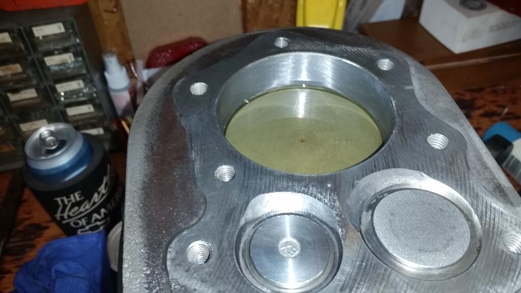

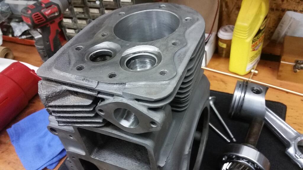

Greentored 3,220 #1 Posted January 18, 2021 30+ years building engines but very little experience with chrome rings. It appears Kohler used them, and most aftermarket overhaul kits have them, so the hopped up K321 in Hoss got a set. Guessing 25 hours on Hoss now, and it still puts out some blue smoke on startup and acceleration. Its making all the power haha and using VERY little oil, it's just annoying. No plans to tear apart. Would like to hear some personal experiences with chrome rings and break in times. Share this post Link to post Share on other sites

Greentored 3,220 #18 Posted January 19, 2021 (edited) Thanks fellas! @bcgold i finished off with 280 grit stones, slightly 'rougher' than the 400/red scotch brite (yep!) I do on standard moly rings. Hopefully was coarse enough, wondering if I should've gone 220. Research shows the same thing you guys confirmed- gotta load it to seat em, and this thing is hard to make 'grunt', it just spins the tires. I did hook a plow on it a couple times and yank it through the garden. Been thinking about whipping up some kind of 'sled', tossing a couple engine blocks on it and dragging it around for an afternoon, and even thought about throwing it in the 1277 and letting the hydro load it for a couple work sessions. Read a lot about the Bon Ami trick too- scary, but proven! Whatever the 'fix', I will update. At this point my concern would be if things have already glazed, then its game over and would need to be ripped down, honed, and tried again. Edited January 19, 2021 by Greentored 1 Share this post Link to post Share on other sites
