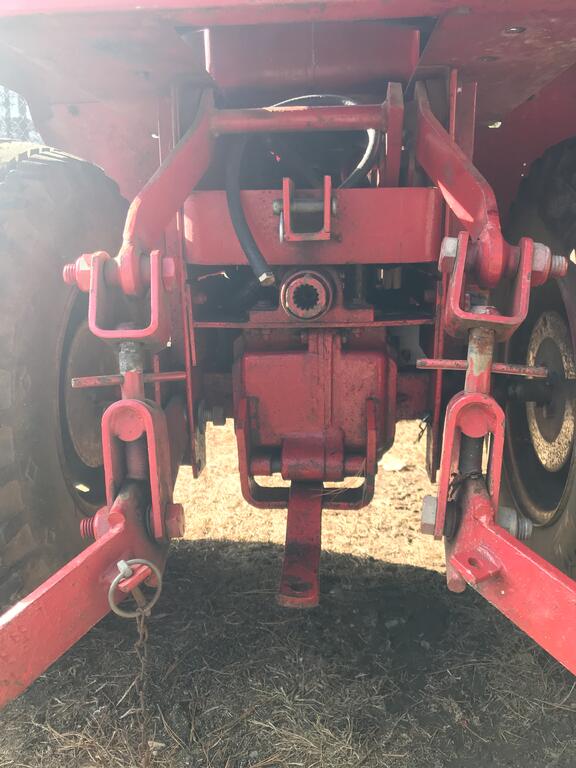

19richie66 17,932 #4 Posted January 17, 2021 (edited) As far as I know, only the lower arms and hydraulic cylinder are the same. Everything else is different. Top - D series , bottom - Gt14 Edited January 17, 2021 by 19richie66 1 Share this post Link to post Share on other sites

Old Skool 2 #6 Posted January 17, 2021 Thank you!!!! Richie. That picture helps me I couldn't find one of the D200 A close up like that anyway Share this post Link to post Share on other sites
953 nut 68,508 #7 Posted January 17, 2021 Everything on the "D" is heavier than the GT-14. You might call Lincoln https://a-ztractor.com/, he probably can hook you up with what you need. Share this post Link to post Share on other sites

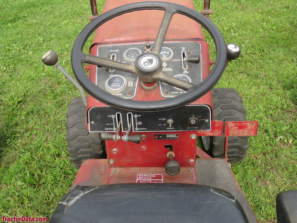

19richie66 17,932 #10 Posted January 17, 2021 Not sure about the levers. My D160 had both levers on the dash just as this picture. It had 3 point and pto when I got it. Share this post Link to post Share on other sites
Old Skool 2 #11 Posted January 17, 2021 Yes Richie mine looks just like that but no hitch. Does your hitch work off the same hydraulic cylinder as the deck? or is there another separate cylinder for the hitch?? Share this post Link to post Share on other sites

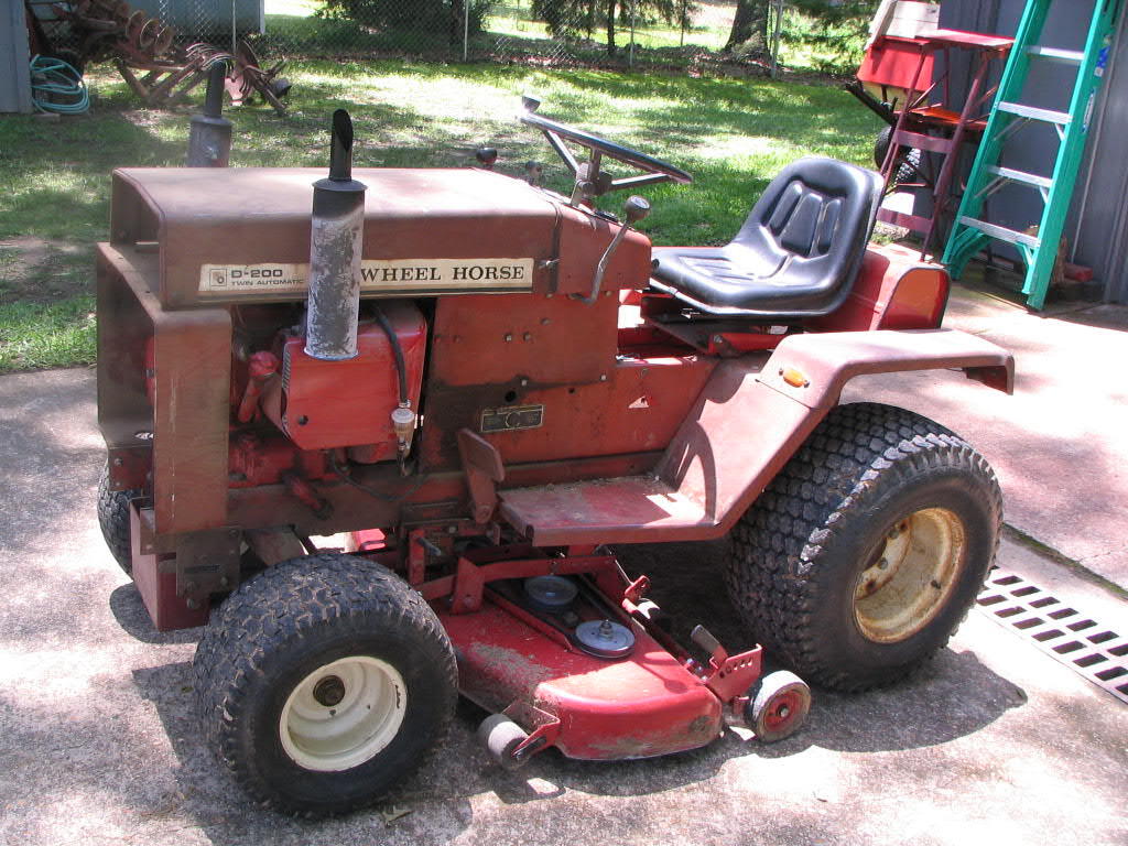

pacer 3,180 #15 Posted January 17, 2021 (edited) Nothing much to add, just may be welcome to the madness!! I too have a D200 that has neither the 3 point or PTO, and the PO said thats the way he bought it -- just a 48" mower deck. It does have the lever in the dash and also a hyd line to where the mounting point of the cyl would go. Kinda funny, here on the forum theres a ..... sorta 'love/hate' with the "Big D's"? Guess thats sorta strongly put, but there are some that just dont like them - seems the look maybe?? Any way the ones of us that DO love em, we do do it with PASSION!! theyre a beast!! heres mine shortly after I got it........... Edited January 17, 2021 by pacer 1 Share this post Link to post Share on other sites
