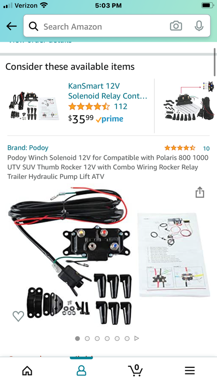

KrazeyOlDave 860 #9 Posted December 20, 2020 Scroll down to the reviews and you’ll see the video of my first attempt with using these. Basically, you just need mount it anywhere you can for intended purpose. You’ll need the ATV switch kit too. IP66 Electric Linear Actuator 12V – (4 in. / 400 lbs.) | Different Sizes Available | Innovative Motor, Durable Stroke and Water Resistant | for Outdoor, Agriculture, Solar, Home | Model: PA-04-4-400 https://www.amazon.com/dp/B00THPKJ28/ref=cm_sw_r_cp_api_glc_fabc_hoR3FbWVDWPDS?_encoding=UTF8&psc=1 Share this post Link to post Share on other sites

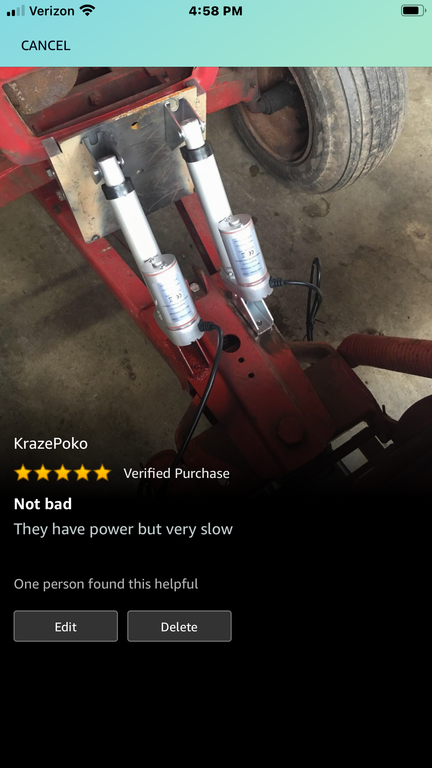

KrazeyOlDave 860 #10 Posted December 20, 2020 (edited) Here’s how I used them on the old pony, it worked fine but they were slow. The ones I gave you a link too, are much faster. Mind you, this was a hack job, just needed it for that winter. Edited December 20, 2020 by KrazeyOlDave 2 Share this post Link to post Share on other sites

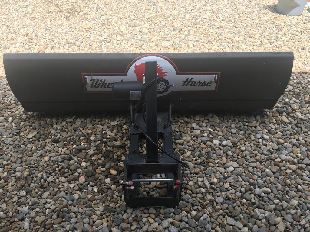

KrazeyOlDave 860 #11 Posted December 20, 2020 I still have this mount somewhere, but this was a very simple and effective setup. 2 Share this post Link to post Share on other sites

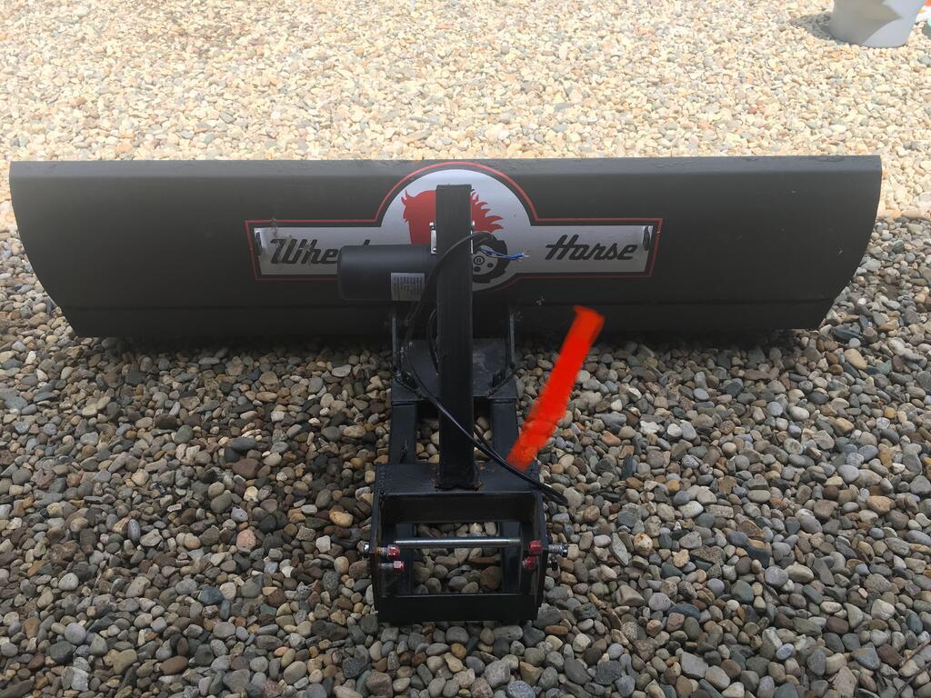

KrazeyOlDave 860 #13 Posted December 20, 2020 4 minutes ago, elcamino/wheelhorse said: @KrazeyOlDave Got any more pictures of the mount ? Were you able to angle the blade ? No sir I don’t, I will search through my Facebook photos and make sure tho. I opted out of auto angle because frankly, I didn’t have the funds at the time. However, doing it would have been super simple, just mounting it off the side. (See red line) 1 Share this post Link to post Share on other sites
ebinmaine 80,112 #14 Posted December 20, 2020 10 minutes ago, KrazeyOlDave said: No sir I don’t, I will search through my Facebook photos and make sure tho. I opted out of auto angle because frankly, I didn’t have the funds at the time. However, doing it would have been super simple, just mounting it off the side. (See red line) I've thought about doing that along with the lift. I'd have great concerns that the actuators wouldn't be able to withstand the push of plowing... Any thoughts? 1 Share this post Link to post Share on other sites
KrazeyOlDave 860 #15 Posted December 20, 2020 9 minutes ago, ebinmaine said: I've thought about doing that along with the lift. I'd have great concerns that the actuators wouldn't be able to withstand the push of plowing... Any thoughts? Yes, that is a high risk for sure. Only sure way to avoid that would be an actuator on both sides. Even then, I’d be scared of ramming a pile of old packed snow. 1 1 Share this post Link to post Share on other sites

ebinmaine 80,112 #25 Posted December 30, 2020 5 hours ago, KrazeyOlDave said: actuator in motion That type of speed is perfectly fine with me. The only thing I'd do different is keep it more vertical to keep the stress off the actuator and on the plow frame where it should be. VERY cool... 1 1 Share this post Link to post Share on other sites
