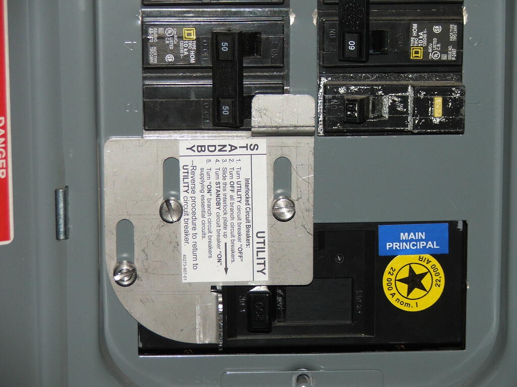

Sparky-(Admin) 26,316 #28 Posted December 6, 2020 8 minutes ago, JCM said: From what I have gathered for info on this From Inspectors and Licensed Electricians there is a device that goes over the Main panel breaker. This main must be in the off position before the power to the Generator is switched on. There is a bar that keeps the main off so the Generator does not backfeed. I just asked the inspector in town about this and confirmed it by several Electricians. Sorry for the poor explanation, Remember I am a Master plumber not electrician. Also this replaces the Transfer switch that used to be required. Does this sound correct @squonk You are correct, it’s called an interlock and is a legal way to tie a gen to a house. Just installed one at my in-laws place a month ago 1 1 Share this post Link to post Share on other sites

squonk 48,072 #30 Posted December 6, 2020 (edited) 6 minutes ago, Sparky said: You are correct, it’s called an interlock and is a legal way to tie a gen to a house. Just installed one at my in-laws place a month ago So it basically does the lock out portion that a full transfer switch does? Never seen them before. But I've been out of the emergency power part of work for 5 years. Just looked it up. Cool idea. Edited December 6, 2020 by squonk 2 Share this post Link to post Share on other sites

lynnmor 9,037 #34 Posted December 6, 2020 An interlock is just a piece of tin for a ridiculous price. Example While one should never run a generator while connected to the power grid, the whole idea that you can power up the neighborhood with your tiny generator is absurd. Your generator will trip out immediately upon connection from the high load. Only where there is little load can the generator cause a problem, and that would be a power outage that is very localized. Share this post Link to post Share on other sites

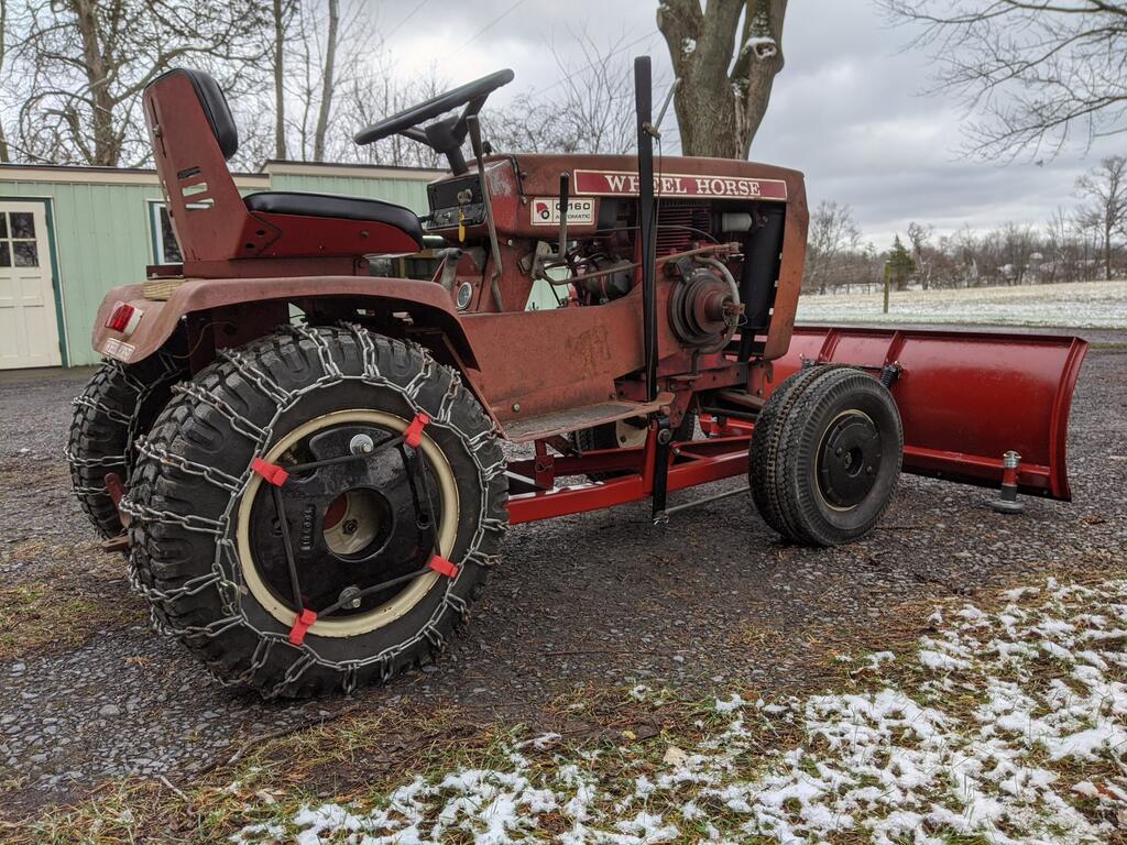

rjg854 13,341 #38 Posted December 6, 2020 To try to get this thread back on track, I know I kinda started it off I have one of them there Ç160's 4 1 Share this post Link to post Share on other sites

rjg854 13,341 #41 Posted December 6, 2020 No no, MINE That's my hedgerow tractor 2 Share this post Link to post Share on other sites
AHS 1,698 #42 Posted December 6, 2020 7 hours ago, JCM said: From what I have gathered for info on this From Inspectors and Licensed Electricians there is a device that goes over the Main panel breaker. This main must be in the off position before the power to the Generator is switched on. There is a bar that keeps the main off so the Generator does not backfeed. I just asked the inspector in town about this and confirmed it by several Electricians. Sorry for the poor explanation, Remember I am a Master plumber not electrician. Also this replaces the Transfer switch that used to be required. Does this sound correct @squonk Yup! Bingo! Geninterlock.com 2 Share this post Link to post Share on other sites

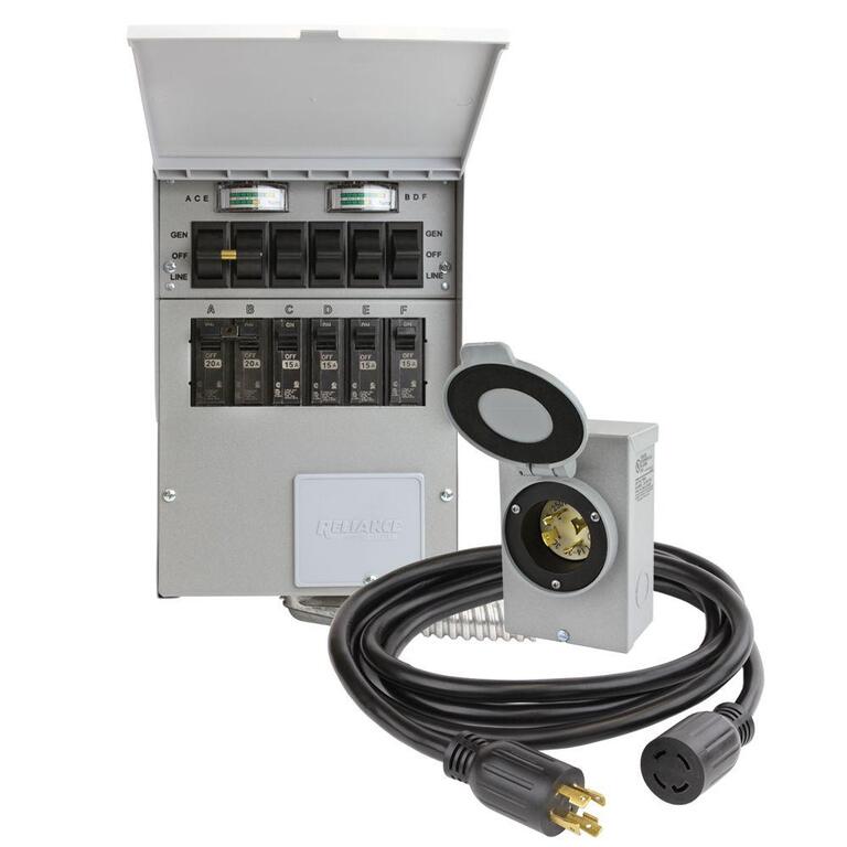

Roger R 473 #50 Posted December 7, 2020 As an Electrician for over 45 years I have installed countless legal and safe generator transfer systems. Bottom line is you cannot be able to back feed your power grid. several systems are available, including what I use on my house, (see the attached) This unit has to match the panel exactly, and genrinterlock.com has a unit for almost every panel in existence. It is also the best value for the price 6 Share this post Link to post Share on other sites
