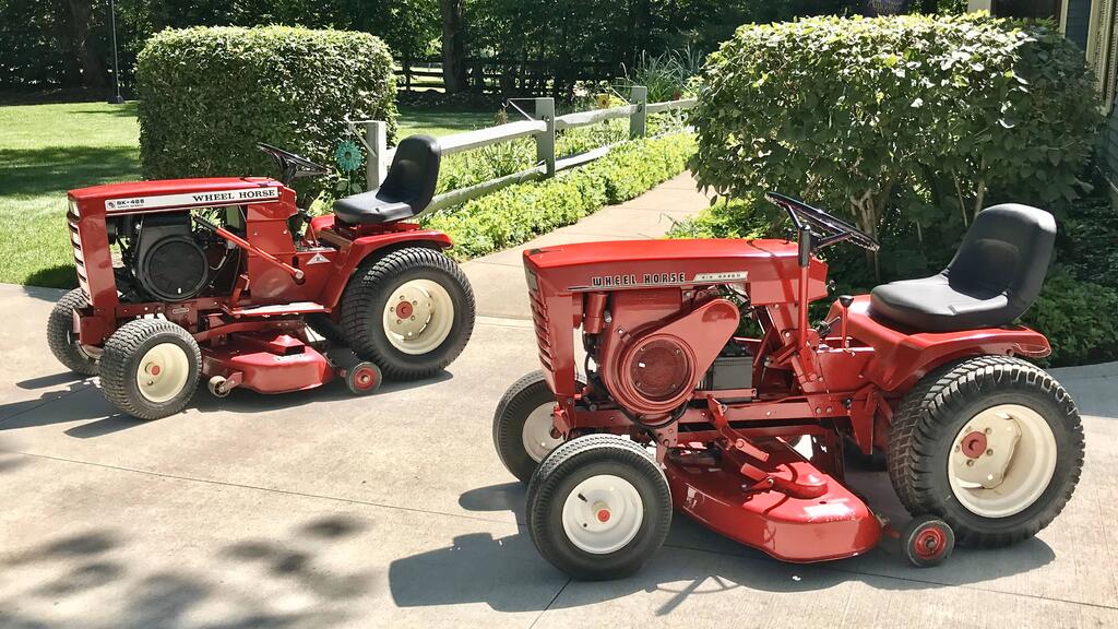

Al C. 1,429 #1 Posted November 19, 2020 I need a recommendation. I have a Wheel Horse 1067 (10hp) and a SK486 (16hp). Both are in excellent working condition. I’m 65 years old and I think this is the last year I can do fall yard cleaning with a hand leaf blower and rake. I am looking for recommendations on the most effective leaf collection yard cleaning system that I can attach to one of my Wheel Horses. I need something that can handle a half acre, six mature oak trees and a ton of acorns. Does such a solution exist???? 7 4 Share this post Link to post Share on other sites

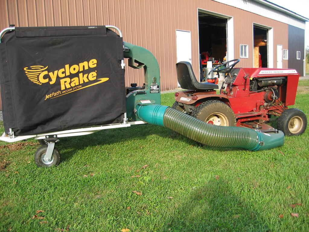

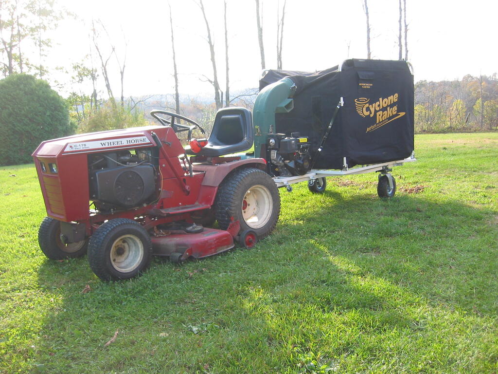

pfrederi 19,874 #2 Posted November 19, 2020 (edited) I have this rig. it works very well but your yard may have a lot of obstacles. The fixed attachment is better than a pure trailer but still requires some space to maneuver. I bought the optional sucker hose i would NOT recommend it. is heavy , bulky and you really need someone on eh tractor to move it as you use the sucker hose. Now i use eh leaf blower to blow eh leaves out of eh tight areas into the open then run over them with this, Edit: oh and it is noisy with that engine right behind you ear muffs are essential. Edited November 19, 2020 by pfrederi 3 3 Share this post Link to post Share on other sites
Al C. 1,429 #3 Posted November 19, 2020 Can it pick up acorns? Share this post Link to post Share on other sites
pfrederi 19,874 #4 Posted November 19, 2020 Don't have many acorns (squirrels get them up for me) The sucker hose will suck up the 3/4 crushed stone around the Koi pond but i doubt the deck would pick up you acorns Share this post Link to post Share on other sites
elcamino/wheelhorse 9,363 #5 Posted November 19, 2020 @Al C. I have a vacuum wagon similar to @pfrederi that is worn out from acorns. If the acorns are dry and not buried in the ground or covered by leaves it would pick it pick some up but it sounds like you are driving down a gravel drive. The acorns beat the heck out of the hoses and impeller . The acorns also dull the mower blades very fast . You may want to try a walk behind blower. Share this post Link to post Share on other sites
