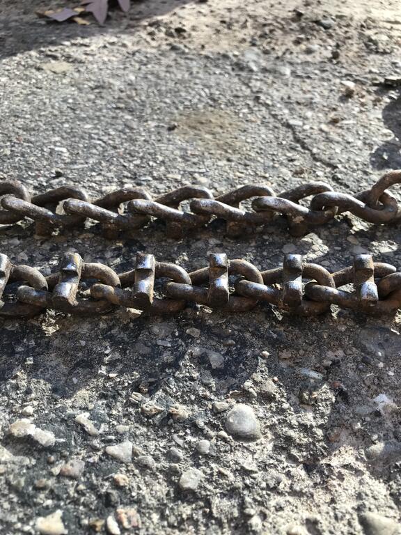

JohnD 145 #1 Posted November 12, 2020 I pulled my chains off last weekend and was surprised to see they aren't symmetric. These are fancier than the last set I picked up. Is the top (far) view the inside (diameter)? Is the bottom (near) view the outside (diameter)? I ask because the PO had them on opposite (inside out). Did they want to reduce the bite, or is there a reason to get better bite into the rubber? Share this post Link to post Share on other sites
echris 1,426 #2 Posted November 12, 2020 31 minutes ago, JohnD said: I pulled my chains off last weekend and was surprised to see they aren't symmetric. These are fancier than the last set I picked up. Is the top (far) view the inside (diameter)? Is the bottom (near) view the outside (diameter)? I ask because the PO had them on opposite (inside out). Did they want to reduce the bite, or is there a reason to get better bite into the rubber? The chain in the lower pic is what should be hitting the road. Those "barbs" are intended to dig into the roadway and pull you along. 4 Share this post Link to post Share on other sites
ebinmaine 79,700 #3 Posted November 12, 2020 6 hours ago, echris said: The chain in the lower pic is what should be hitting the road. Those "barbs" are intended to dig into the roadway and pull you along. Nailed it. Cleats Down. Around here we refer to those as "ice chains". I've run both. They do make a bit of difference on smooth ice. Not noticable on snow. 1 Share this post Link to post Share on other sites
