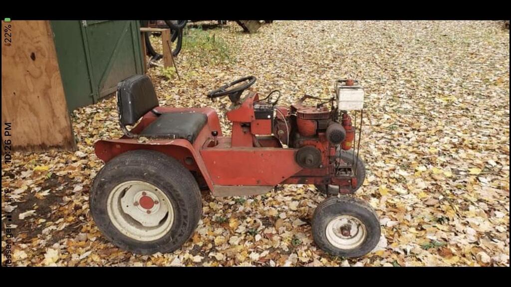

Pullstart 71,482 #5 Posted October 28, 2020 Well locally a 953 or 1054 (either way) came up for sale with a funky front up top mounted tank, no grille or hood. I have a few extra grilles, thought to myself “would it work easily?” Share this post Link to post Share on other sites
ebinmaine 81,048 #6 Posted October 28, 2020 Any pics of that? Share this post Link to post Share on other sites
Stormin 9,988 #7 Posted October 28, 2020 41 minutes ago, 8ntruck said: I don't think he will have any trouble pulling this off - unless the project stalls like his dump truck project seems to have. Dump Trucks gone to Maine to winter with Colossus. 6 Share this post Link to post Share on other sites
Pullstart 71,482 #8 Posted October 28, 2020 29 minutes ago, ebinmaine said: Any pics of that? It’s real attractive... 2 2 1 Share this post Link to post Share on other sites
ebinmaine 81,048 #9 Posted October 28, 2020 25 minutes ago, pullstart said: It’s real attractive... Uhhhhh. Yeah. 1 Share this post Link to post Share on other sites
8ntruck 9,368 #10 Posted October 28, 2020 (edited) 2 hours ago, pullstart said: It’s real attractive... Looks like a good starting point to me. If I were seriously in the market...... Maybe a forward raking grill and a 'power dome' to clear the gas tank? Edited October 28, 2020 by 8ntruck 1 Share this post Link to post Share on other sites

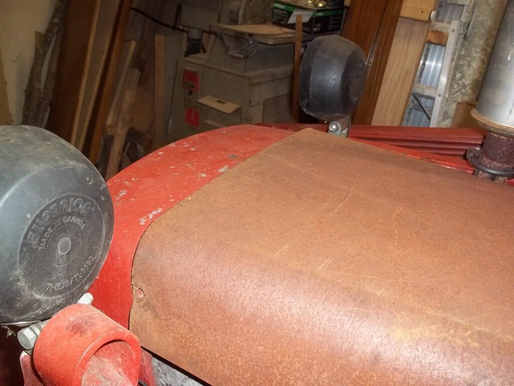

953 nut 70,064 #16 Posted October 29, 2020 I'm late to the party. Looks like a good project for you and the pit crew. Looking at the picture I think it is probably a first generation 953, the steering wheel and Ross steering shaft are apparent and the seat frame is definitely 953. GO GET IT! You could probably make up a spacer block to go between the 953 frame and GT-14 grill to make up the height difference and help with alignment. The top of the grills is the same, good to go there. Here is a picture of a 953 hood sitting on a GT-14 grill. 3 Share this post Link to post Share on other sites
