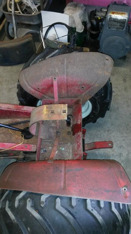

Chris G 3,369 #5 Posted October 28, 2020 (edited) Im building a custom right now, that has a 753 frame and i used a workhorse gt 1100 6 speed transaxle and i used the front axle as well. Also i ended up using 701 sheet metal and the last pic gives a idea of the mods made to tool box for the dipstick and u can get a general for were a hole was drilled for the hi lo shifter. Edited October 28, 2020 by Chris G 7 3 Share this post Link to post Share on other sites

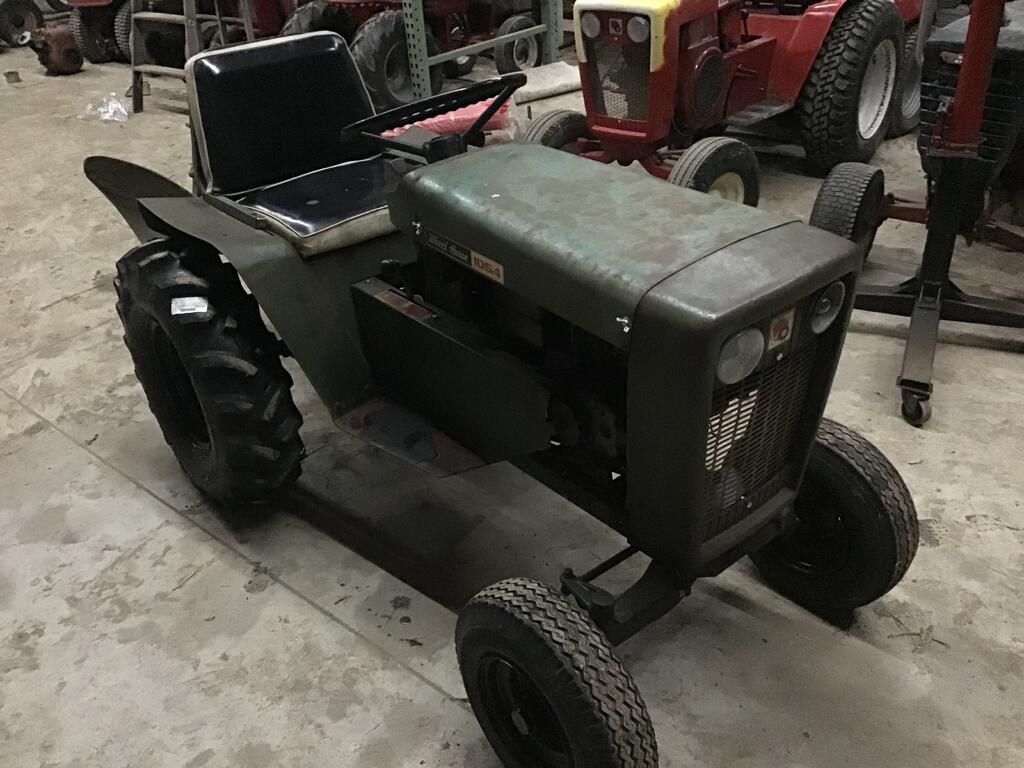

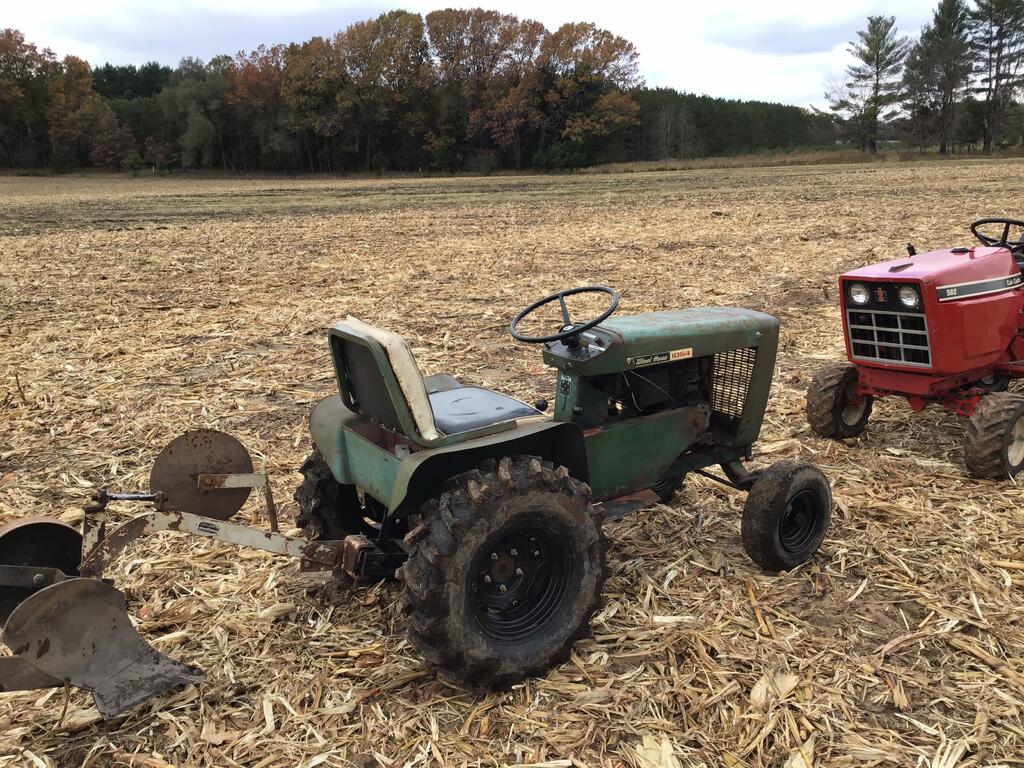

Pullstart 68,878 #12 Posted October 29, 2020 I know for auto tires, “siping” the lugs is commonplace for better winter grip. It is pretty much a ton of tiny razor blade cuts in the lugs of the tire to make each new section grip the ice and snow better. I’d love to see what siping some of my new Interco Interforce tires would do for wintertime use, but feel like the solid heavy lug is required for plowing fields even more. 2 Share this post Link to post Share on other sites
OldWorkHorse 3,130 #13 Posted October 29, 2020 1 minute ago, pullstart said: I know for auto tires, “siping” the lugs is commonplace for better winter grip. It is pretty much a ton of tiny razor blade cuts in the lugs of the tire to make each new section grip the ice and snow better. I’d love to see what siping some of my new Interco Interforce tires would do for wintertime use, but feel like the solid heavy lug is required for plowing fields even more. I love that shade of green on that tractor, I'm not a huge green fan but the shade and the wear Mark's just make it look that much tougher! 1 1 Share this post Link to post Share on other sites
Achto 30,991 #14 Posted October 29, 2020 8 minutes ago, pullstart said: I’d love to see what siping some of my new Interco Interforce tires would do for wintertime use, but feel like the solid heavy lug is required for plowing fields even more. That would be an interesting experiment. I know that dirt oval track racers sipe their tires for better grip, but then again they are on hard pack clay. I'd have a hard time cutting up new tires to try this out though. 2 Share this post Link to post Share on other sites
Pullstart 68,878 #15 Posted October 29, 2020 27 minutes ago, OldWorkHorse said: I love that shade of green on that tractor, I'm not a huge green fan but the shade and the wear Mark's just make it look that much tougher! I have no reason to change the look, shy of more power and functionality! 17 minutes ago, Achto said: That would be an interesting experiment. I know that dirt oval track racers sipe their tires for better grip, but then again they are on hard pack clay. I'd have a hard time cutting up new tires to try this out though. My in-laws race dirt... they have a siping machine for that in fact... 2 Share this post Link to post Share on other sites
