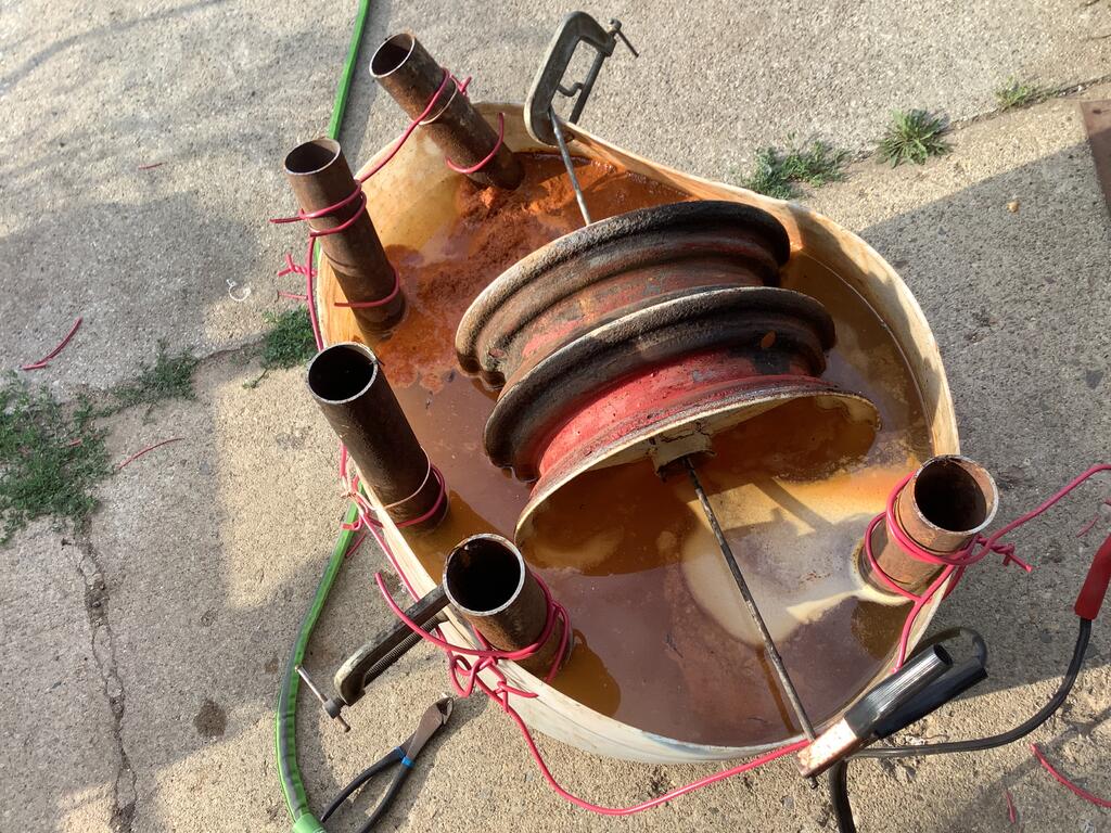

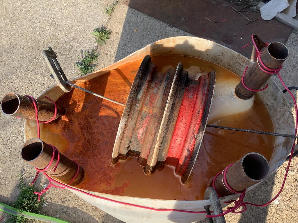

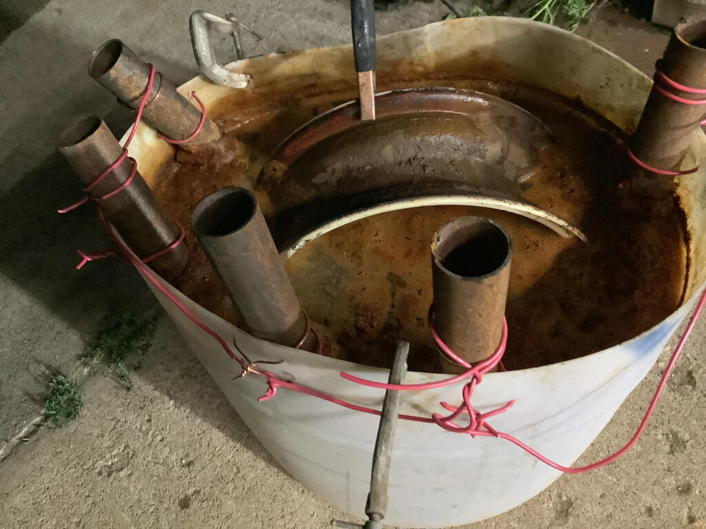

Pullstart 71,564 #126 Posted August 7, 2022 29 minutes ago, ineedanother said: I have to say, those are the BIGGEST anodes I've ever seen in an e-tank They’re working! 2 Share this post Link to post Share on other sites
ineedanother 2,885 #127 Posted August 7, 2022 They’re working! Love an e-tank! I wish I had known this when I was a kid wire brushing and busting my knuckles for sub-par results. 1 Share this post Link to post Share on other sites

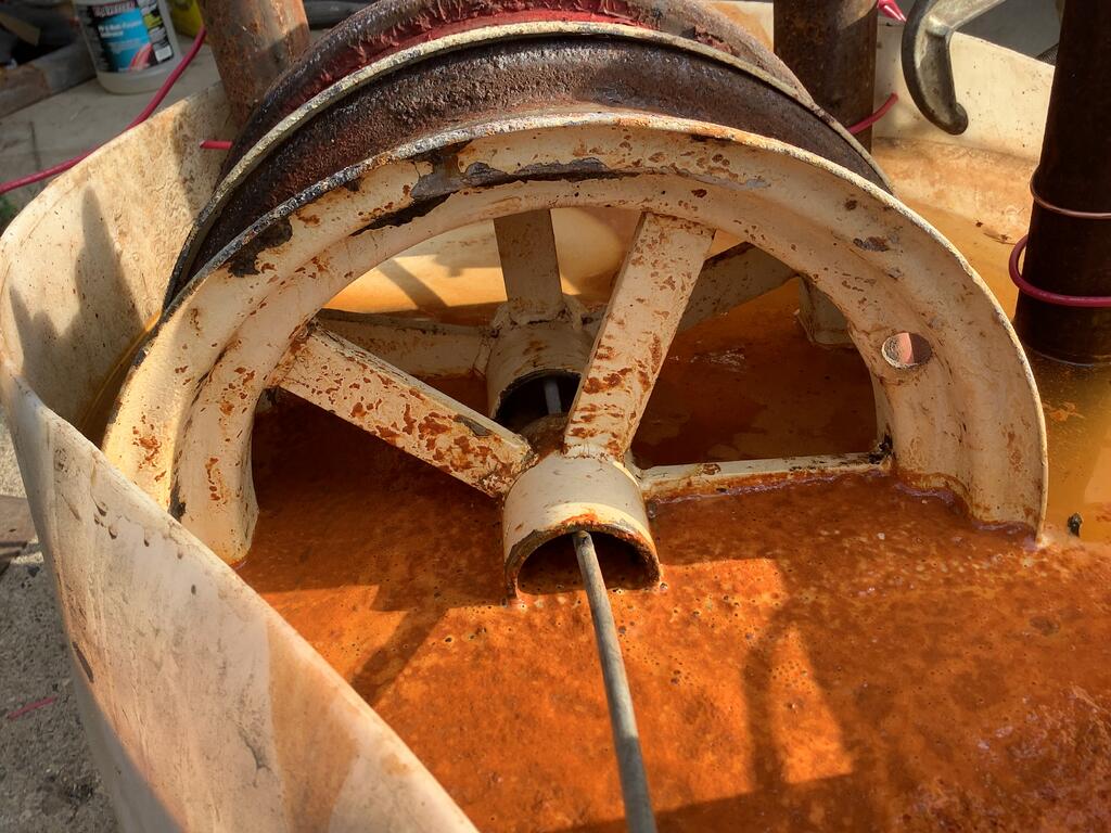

Pullstart 71,564 #128 Posted August 7, 2022 9 minutes ago, ineedanother said: They’re working! Love an e-tank! I wish I had known this when I was a kid wire brushing and busting my knuckles for sub-par results. I had an ah-ha moment last night. It seemed to have settled down from when I started the video. My ground Rod was submerged in the water. When I took 2 gallons of solution out of the tank, it pulled the rod about 1/2” out of the water and the results were amazing! 2 Share this post Link to post Share on other sites
ineedanother 2,885 #129 Posted August 7, 2022 9 minutes ago, Pullstart said: I had an ah-ha moment last night. It seemed to have settled down from when I started the video. My ground Rod was submerged in the water. When I took 2 gallons of solution out of the tank, it pulled the rod about 1/2” out of the water and the results were amazing! Makes sense. Current moving entirely through the part rather than directly between the anodes and diode. 1 Share this post Link to post Share on other sites

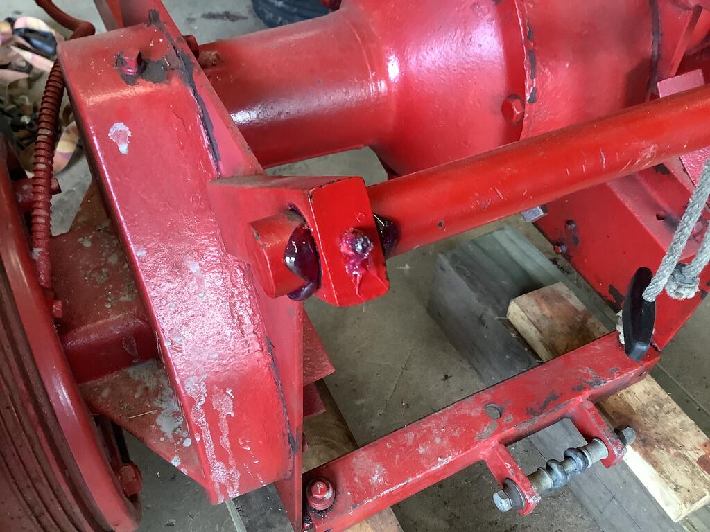

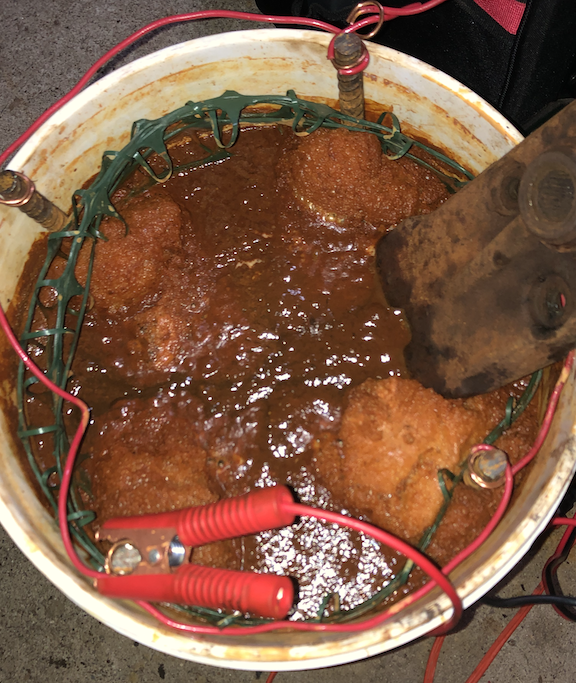

Handy Don 17,735 #130 Posted August 7, 2022 12 minutes ago, Pullstart said: My ground Rod was submerged in the water Anodes? The rod supporting the wheels?\ This is mine being busy on the cast iron main plate for an RM-366. Anodes are lengths of rebar wired together with 14ga solid wire and the green plastic mesh holds them against the sides. 1 Share this post Link to post Share on other sites
Pullstart 71,564 #131 Posted August 7, 2022 @Handy Don the rod supporting the wheels was under water. I added another anode this morning to clean the insides of the wheels. One thing I learned about anodes in the water heater business, is they generally work best when they have a direct line of site to the part they are working with. Any blockage (like a gas flue pipe in a water heater) is means for less coverage. In high end commercial water heaters, a powered anode kit is available to basically never end the cycle unlike most aluminum or magnesium alloys that eventually wear away. With multi flue tanks, there are generally more anodes for that purpose as part of the design. 1 Share this post Link to post Share on other sites

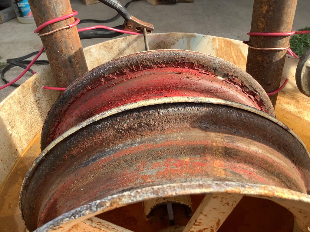

Pullstart 71,564 #132 Posted August 7, 2022 These wheels have been rotated 180 degrees in the water after sitting all night. Lots of rust still evident on the insides, where the paint is all bubbled on the outsides. 2 1 Share this post Link to post Share on other sites
Handy Don 17,735 #133 Posted August 7, 2022 1 minute ago, Pullstart said: the rod supporting the wheels was under water Yep, that'd slow things down a bunch! 2 minutes ago, Pullstart said: clean the insides of the wheels Yep, that line of sight business got me to make an extra piece of rebar that has a couple pieces of split plastic tubing as insulation that i can put down the center of a pipe or tube or put up against a particularly rusty spot. 1 1 Share this post Link to post Share on other sites
Handy Don 17,735 #135 Posted August 7, 2022 In your case, I'd consider putting the negative clamp directly onto the rim of the wheels sticking out of the solution. Do a bit of wire brushing to make good contact and clamp the two wheels together with the clamp. The rod probably isn't making that great of contact with the inner surface of the hub. 2 Share this post Link to post Share on other sites
Pullstart 71,564 #136 Posted August 7, 2022 13 minutes ago, Handy Don said: In your case, I'd consider putting the negative clamp directly onto the rim of the wheels sticking out of the solution. Do a bit of wire brushing to make good contact and clamp the two wheels together with the clamp. The rod probably isn't making that great of contact with the inner surface of the hub. I thought of that, but it is riding on clean bearing surfaces alone. I could likely thread the wheels through the spokes to dip them deeper too but this should work and it’s constantly mobile when needed. 1 Share this post Link to post Share on other sites

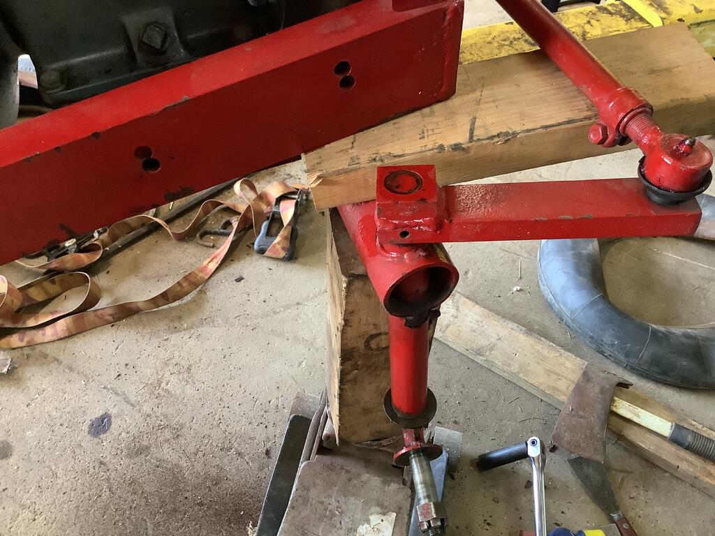

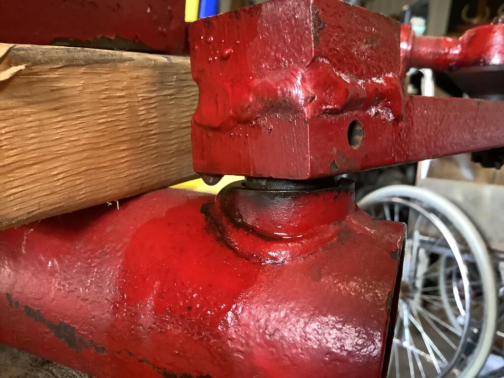

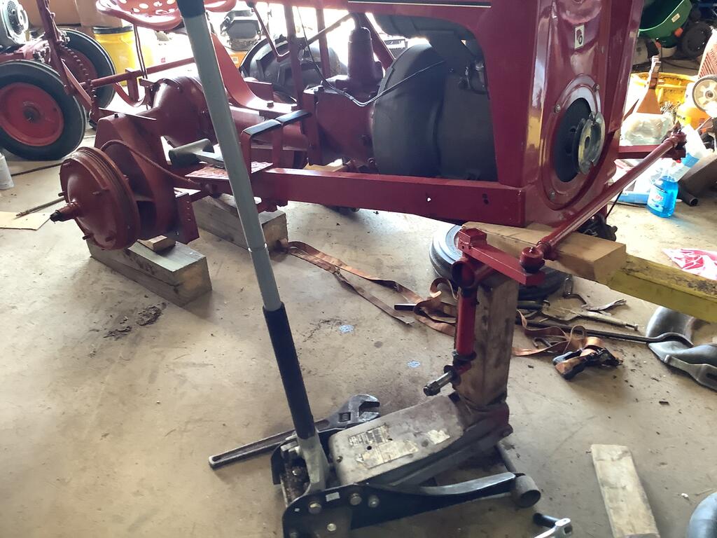

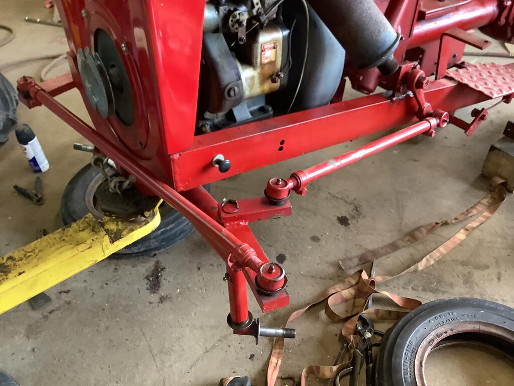

Pullstart 71,564 #138 Posted August 7, 2022 This right front spindle has quite a bit of vertical travel and could use some shims. I popped the roll pin out, gave it some juice and a few backed up whacks in either direction to shock the arm loose. I’ll revisit this in a bit. 1 1 Share this post Link to post Share on other sites

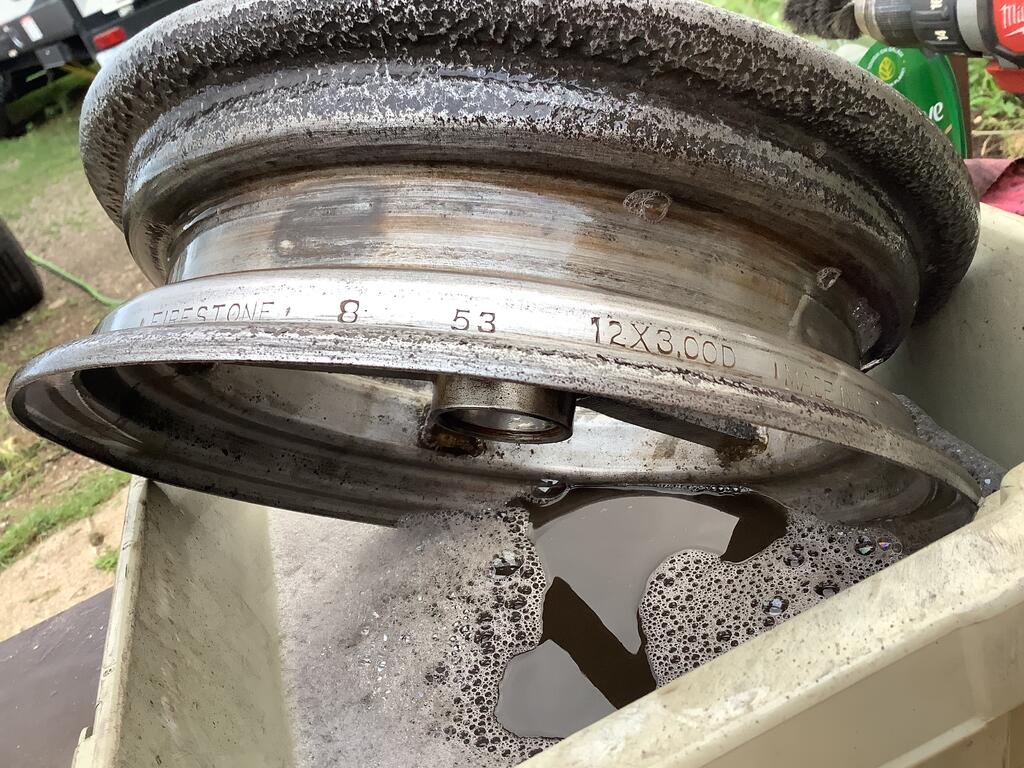

Pullstart 71,564 #142 Posted August 8, 2022 One wheel complete! Tomorrow if the sun’s out, I’ll degrease ‘em, rinse ‘em, dry ‘em, and start with the primer! 5 2 Share this post Link to post Share on other sites
953 nut 70,662 #143 Posted August 9, 2022 On 8/7/2022 at 10:48 AM, Pullstart said: rear drums easy to pop off for inspection? Check out a Ford Model A site, they can probably give you the inside scoop. 2 Share this post Link to post Share on other sites

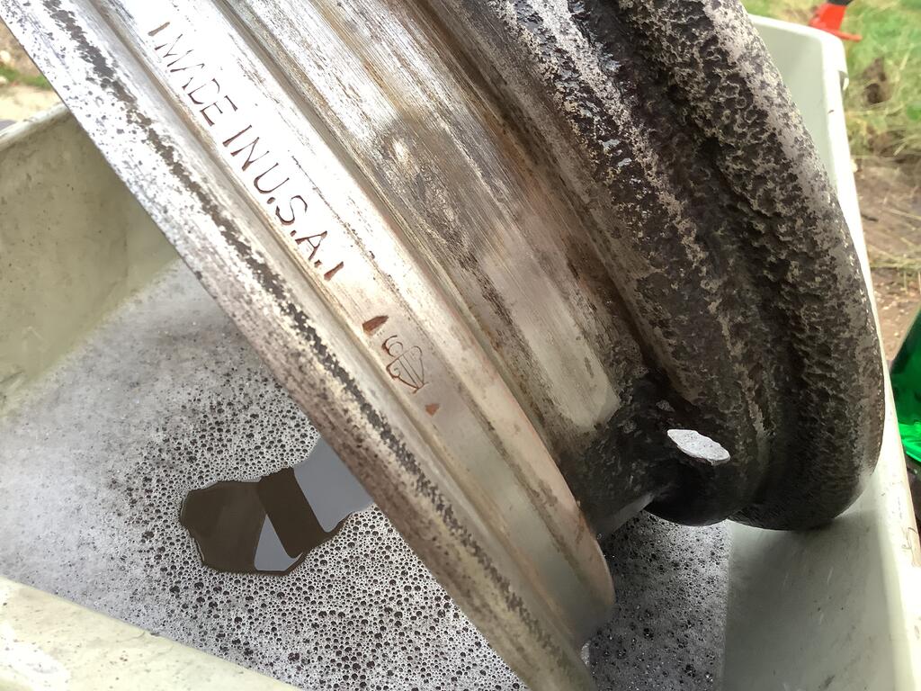

Pullstart 71,564 #144 Posted August 9, 2022 I love this. The Firestone stamp is awesome! The little dude or whatever the sign is at the end is pretty cool too! 2 2 Share this post Link to post Share on other sites

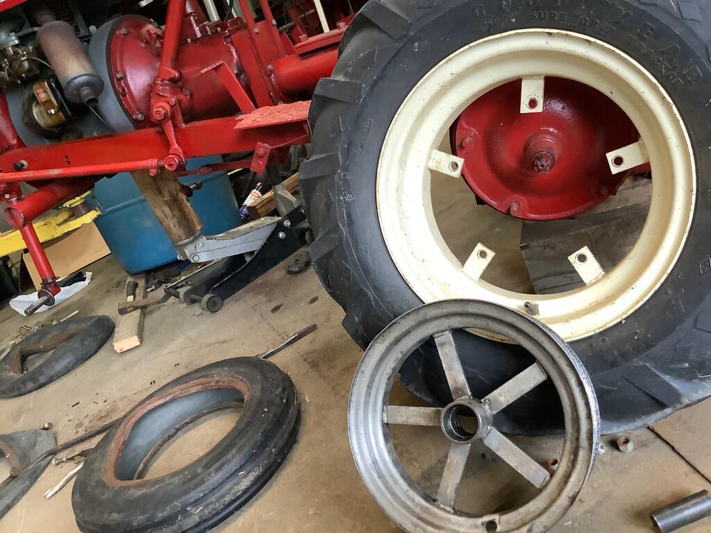

Pullstart 71,564 #145 Posted August 9, 2022 #2 done. I figured out that the wheels would fit in the lathe. I was thinking of chucking them up and spinning them with some 80 grit to get some inside pitting smoothed more. I also thought maybe not. I also thought to prime and paint ‘em the way they are, then smear a light coat of bead sealer on the inside of the wheels and let it dry before mounting them. thoughts? 1 Share this post Link to post Share on other sites
Monstrosity 1,153 #146 Posted August 9, 2022 5 minutes ago, Pullstart said: #2 done. I figured out that the wheels would fit in the lathe. I was thinking of chucking them up and spinning them with some 80 grit to get some inside pitting smoothed more. I also thought maybe not. I also thought to prime and paint ‘em the way they are, then smear a light coat of bead sealer on the inside of the wheels and let it dry before mounting them. thoughts? I wouldn't sand them down I'd wire wheel the bead and get that metal putty epoxy and then sand it down. I don't know how body filler would hold up.. 2 Share this post Link to post Share on other sites
ineedanother 2,885 #147 Posted August 9, 2022 8 minutes ago, Pullstart said: #2 done. I figured out that the wheels would fit in the lathe. I was thinking of chucking them up and spinning them with some 80 grit to get some inside pitting smoothed more. I also thought maybe not. I also thought to prime and paint ‘em the way they are, then smear a light coat of bead sealer on the inside of the wheels and let it dry before mounting them. thoughts? I wouldn't consider the lathe unless you can dial it down to maybe 30 rpm to see how they spin. Possibly out of round and definitely not balanced could spell a bad experience. 2 Share this post Link to post Share on other sites
ineedanother 2,885 #148 Posted August 9, 2022 54 minutes ago, Pullstart said: #2 done. I figured out that the wheels would fit in the lathe. I was thinking of chucking them up and spinning them with some 80 grit to get some inside pitting smoothed more. I also thought maybe not. I also thought to prime and paint ‘em the way they are, then smear a light coat of bead sealer on the inside of the wheels and let it dry before mounting them. thoughts? I'm not sure how I would finish them and don't know how much work you put into them after the e-tank but man, you can definitely see what you have to work with. Nice 1 1 Share this post Link to post Share on other sites
WheelHorse79 271 #149 Posted August 9, 2022 I wonder if the "8" and "53" stamps mean August of 1953? Might also help date the tractor's time of manufacture. 2 1 Share this post Link to post Share on other sites

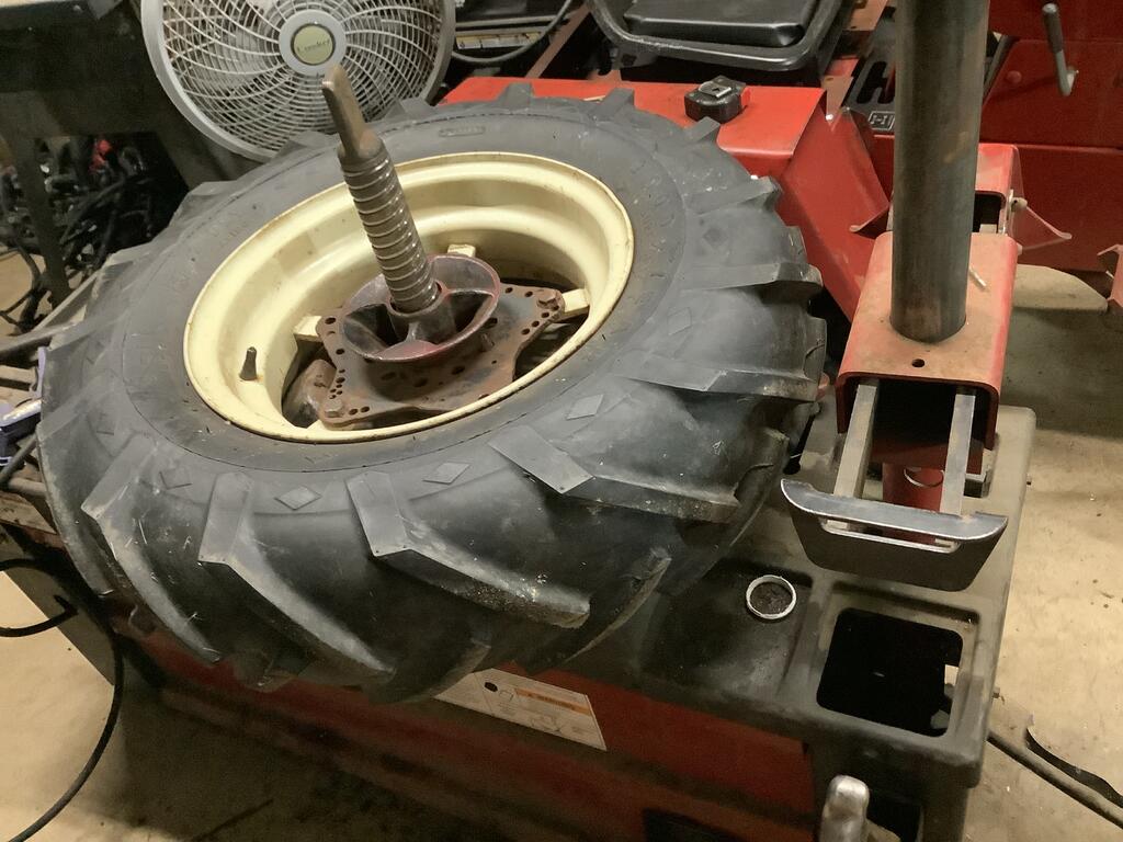

Pullstart 71,564 #150 Posted August 9, 2022 Well, I just couldn’t leave well enough alone. I took the air out of the tube from probably the late 70’s, and saw all the rust buildup. I have to start fresh in the rear! I believe I have 12 days by the way. 11 I guess. We have our Heritage Days Parade and the Senior is scheduled to be representing! At least I can use the tire machine for this size! Funny thing… “wide 5” race car wheels are the same bolt pattern as a Model A! 3 2 Share this post Link to post Share on other sites
