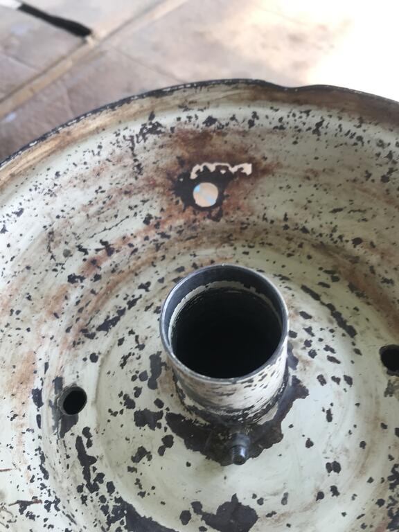

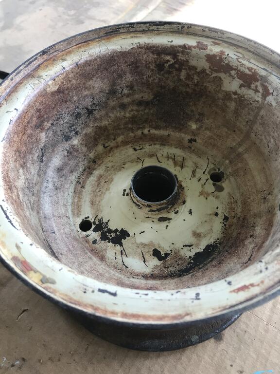

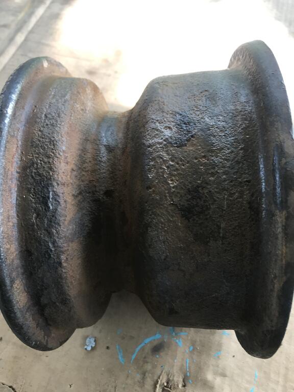

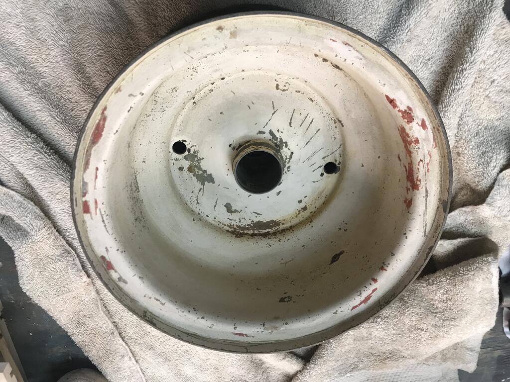

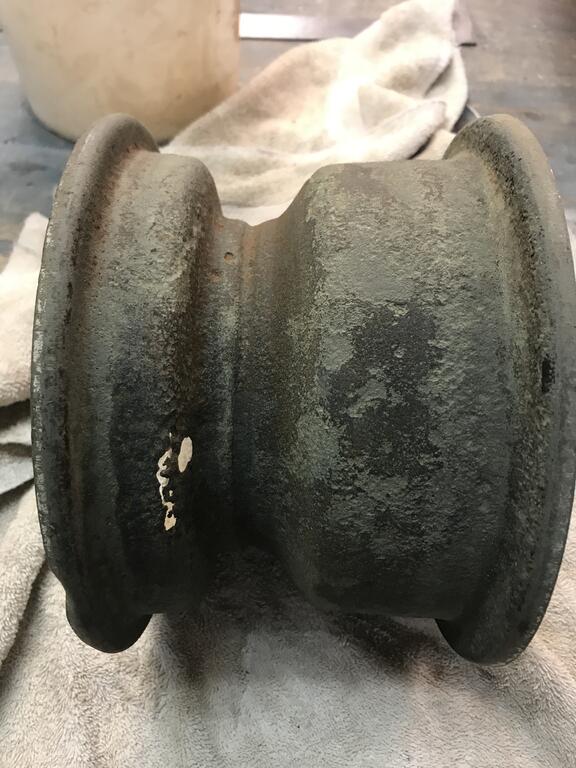

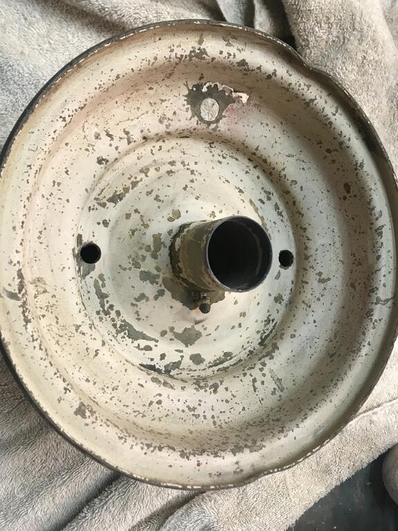

oliver2-44 11,758 #11 Posted September 21, 2020 Here’s some results. I checked it last night after about 4 hours and a lot of the rust in the paint was gone and those spots had a dull silvery black look. But the heavier rust inside the rim was still there so I left it till this morning so about 12 hour soak. 95% of rust gone, just a few small area left But you can see the areas cleaned in 4 hours now have a greenish tinge. @ebinmaine the larger cleaned areas on the bottom face of this rim we’re blistered up paint So it did soak through. And remove the rust in those area. One of the negatives to using this or when I tried Vinegar is the Part will flash rust if not neutralized with baking soda and dried. To me this flash rust less than with vinegar, but will still do it. A plus is the water on my bucket is not a rusty mess like when using vinegar so the dripping don’t stain everything when removing a part. As far as safety I finally had to stick my finger, then my hand in it and at the strength I mixed it there was no tingle or reaction. Overall I would say it’s a another tool in the tool box. The 4 hr soak would be a good candidate for saving paint while removing most of the rust and leaving a good surface to wax or clear coat. The 12 hour soak left a good surface to lightly sand and paint color to cover the green tinge. The E-tank will continue to be my preferred method for complete rust and paint removal. As mentioned above sort of only cost a box of washing soda. But I’ve also killed 2 battery chargers doing it. My E-tank barrel sits outside so I don’t have any concerns with hydrogen build-up. I recently got a couple of surplus 12v power supplies and will be interested to see how they last. Like @953 nut I also like OSPHO for some uses. I actually wiped part of the inside of this rim with OSPHO and it did a good job of preventing any flash rust in that area This rim will get a weld repair, then a complete strip in the E-tank. Then a quick trip through the blast cabinet to put a texture profile on the metal for painting. After the welding and grinding. I’ll do a little JB Weld smoothing around the valve stem hole, then prime and paint. 4 Share this post Link to post Share on other sites

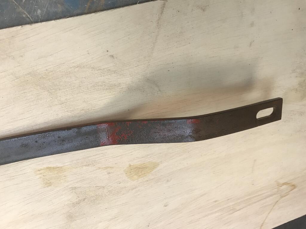

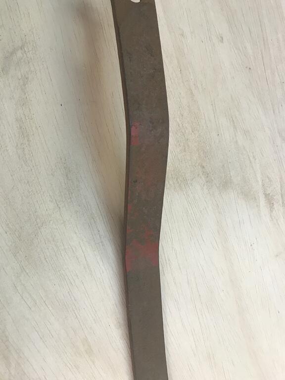

oliver2-44 11,758 #18 Posted December 10, 2020 Still doing some testing with this. This Suburban plow arm looked completely rusty, no red paint visible. Now after a 2 day soak and a quick bristle brush scrub there’s red paint left. It would oil or clear coat nicely for a patina look. I wetted it and wiped it off to give a quick oiled look 1 Share this post Link to post Share on other sites
