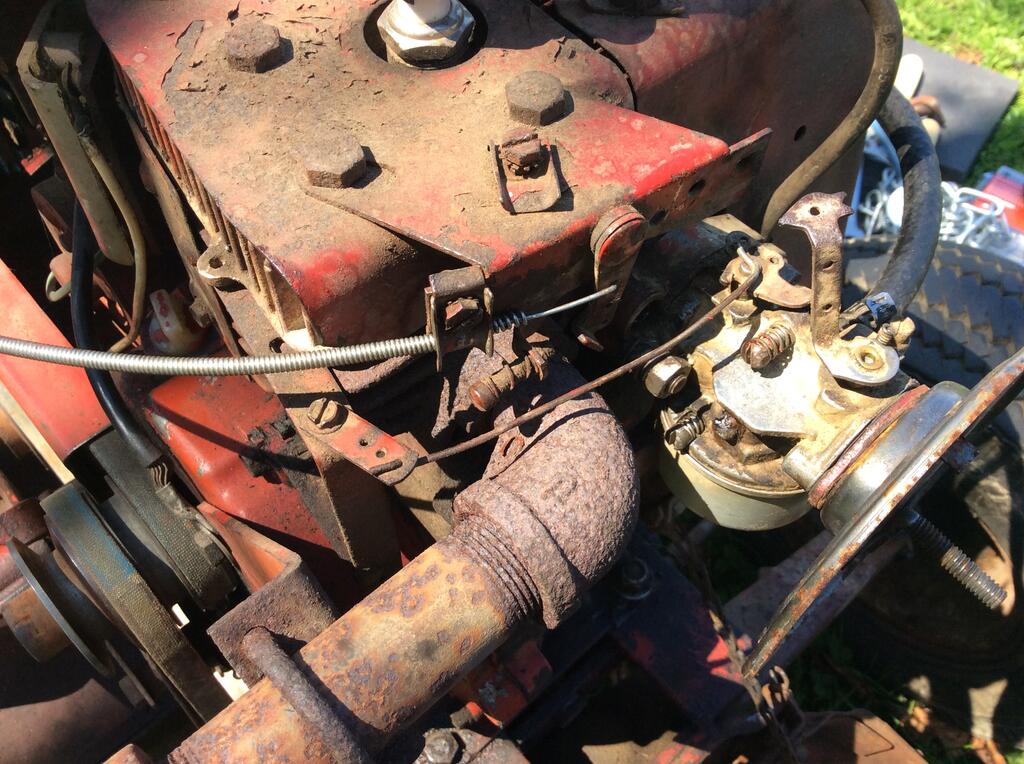

WHNJ701 4,172 #1 Posted September 11, 2020 Not sure if this is the original carb for a the 551 h55d engine? My book has it listed as Tecumseh with float. If I need rebuild kit down the road so I know what to order Share this post Link to post Share on other sites

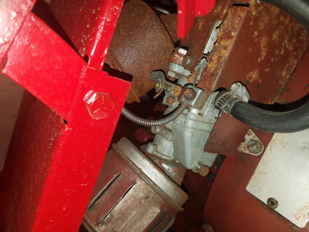

Tractorhead 9,217 #2 Posted September 11, 2020 This carb looks the same as on my 656 with tecky hh60 engine is on. Share this post Link to post Share on other sites

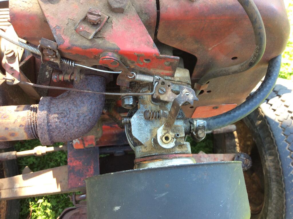

oldredrider 2,553 #3 Posted September 11, 2020 Pic of the Tillotson carb on an H55D I had. Share this post Link to post Share on other sites
WHNJ701 4,172 #4 Posted September 11, 2020 2 hours ago, Tractorhead said: This carb looks the same as on my 656 with tecky hh60 engine is on. That looks like it, what's it called or model#? Share this post Link to post Share on other sites
WHNJ701 4,172 #5 Posted September 11, 2020 27 minutes ago, oldredrider said: Pic of the Tillotson carb on an H55D I had. Definitely not that one, but I have that aircleaner Share this post Link to post Share on other sites
Tractorhead 9,217 #6 Posted September 11, 2020 (edited) 10 hours ago, jabelman said: That looks like it, what's it called or model#? It‘s a hh60 Tecumseh Engine Base model (model verifyed) of this Carb is an #631067 compatible Modells to exchange shall be #631067A; #631828 and #632076 they all shall be 100% interchangeable Edited September 12, 2020 by Tractorhead 1 Share this post Link to post Share on other sites
formariz 12,359 #7 Posted September 12, 2020 (edited) @jabelmanThe original and correct carb for that model is the Walbro LMG157. The important thing about it, is that it is one of the very few carburetors that has the adjustments on the left side looking at it from the top. The 551 is probably the hardest tractor to work on since it is very tight with all it has under the hood and hood it self does not open. Carburetors with the adjustment on the opposite side like most of them make it virtually impossible to adjust carburetor while tractor is running. Exhaust pipe and other things are on the way. Its extremely frustrating.You can see that on one of your photos. I suggest that if you can try to find a carburetor with the adjustments on that side. The correct one is like finding a hen's tooth but a couple of the ones used on Clinton engines have adjustments on that side. I have two of those tractors and luckily have the original carburetor. Another thing to keep in mind is to make sure that there are no leaks from it since any fuel coming from it winds directly on top of battery. Edited September 12, 2020 by formariz 1 1 Share this post Link to post Share on other sites
WHNJ701 4,172 #8 Posted September 12, 2020 (edited) Yes it's a hard to work one, uncomfortable to ride, but it's a cool one in the collection of misfits,. I was wondering about the carb adjustment on the exhaust side. This carb looks identical too to the one on the commando with the tech snowblower engine. I won't be putting the electronics or battery in it. So far it starts easily with the pull start. Seems to be running fine, ran it for about 1/2 hour yesterday with some marvel which seemed to help. It's very interesting comparing this to the 701, same year far better tractor! Edited September 12, 2020 by jabelman 1 Share this post Link to post Share on other sites
