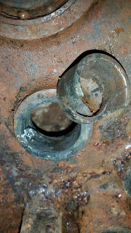

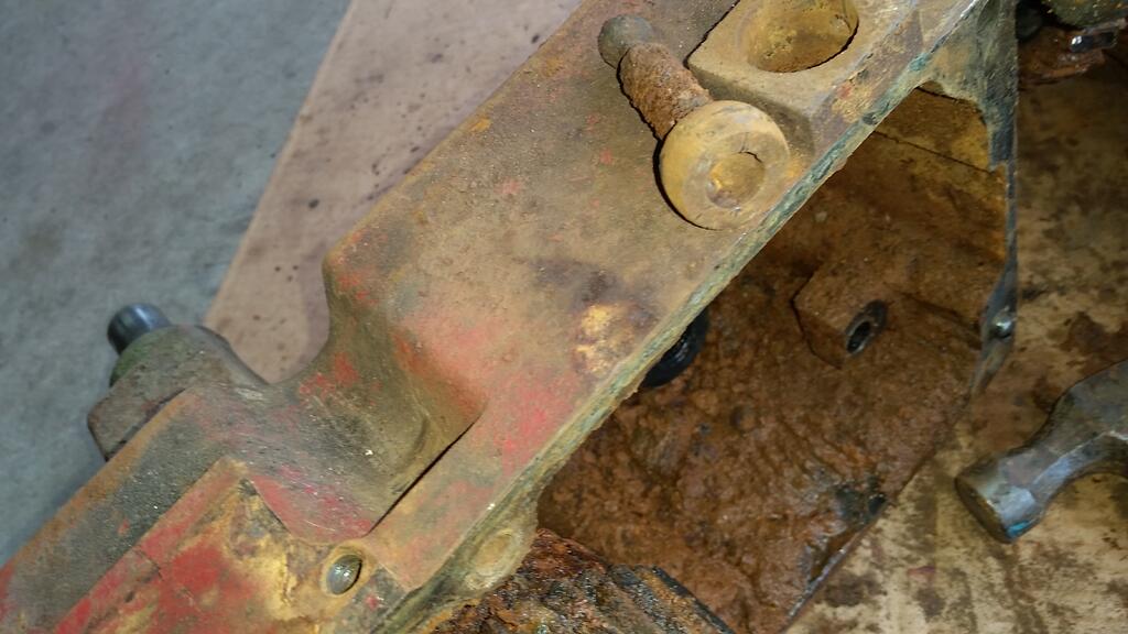

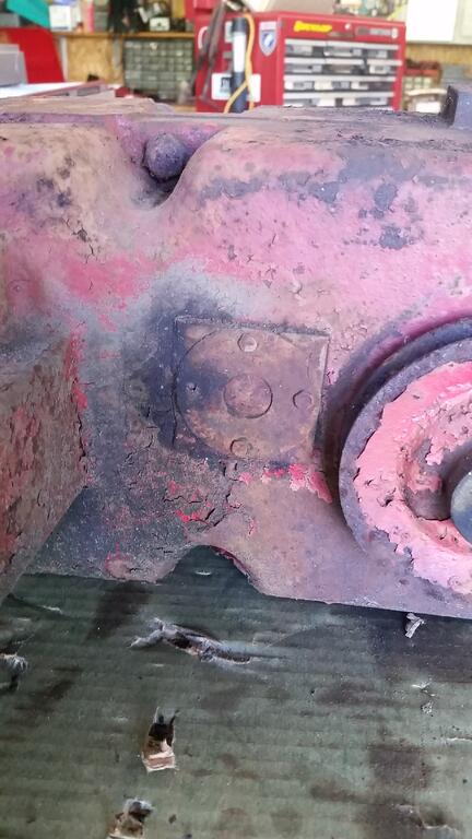

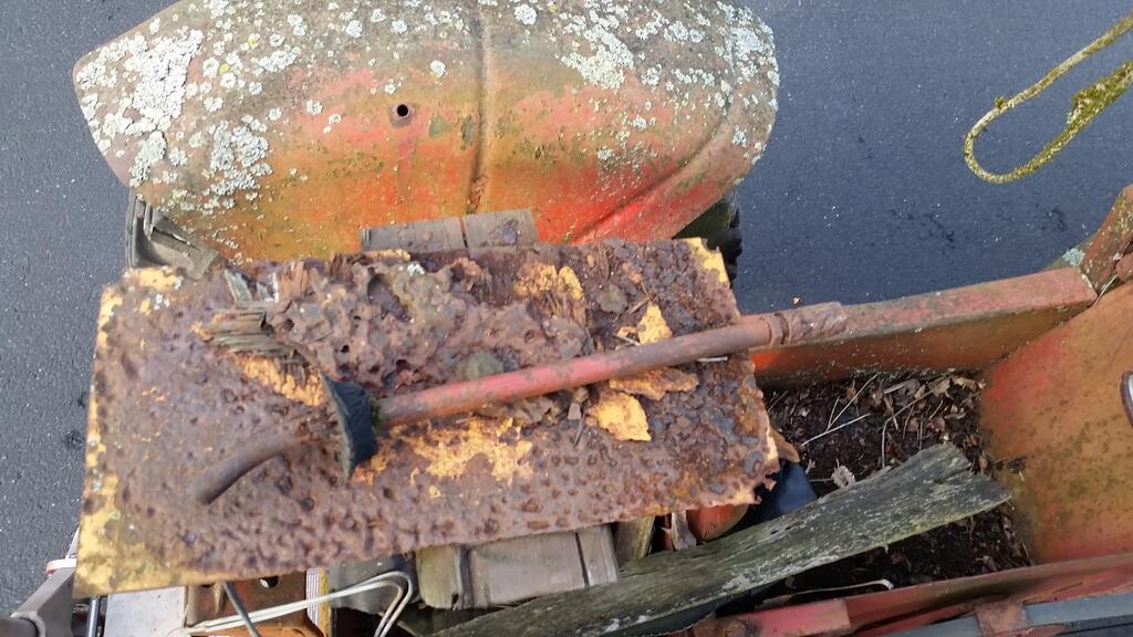

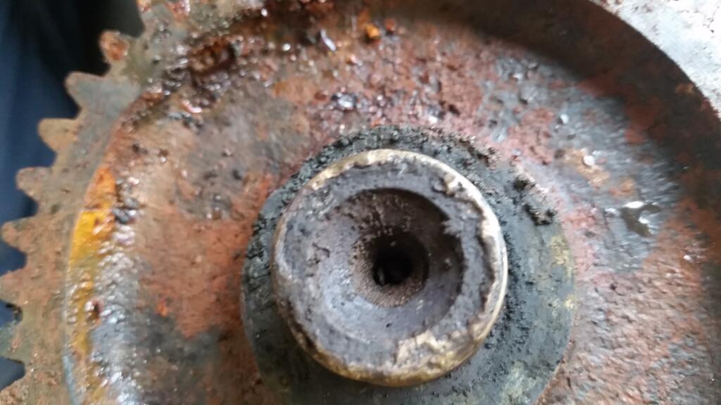

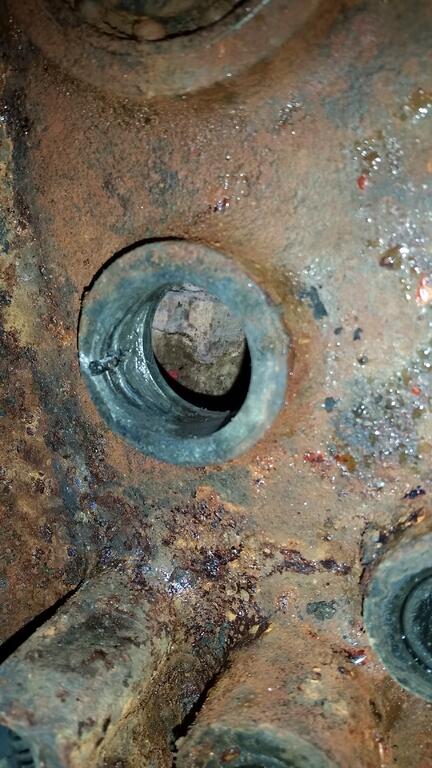

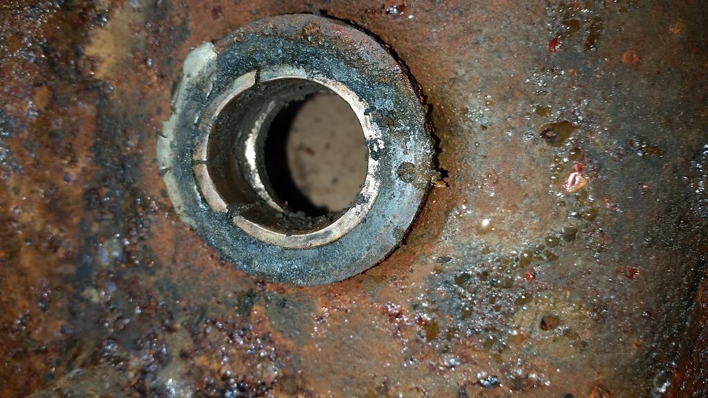

WHX?? 58,228 #1 Posted September 8, 2020 (edited) This time it's a transmission! This one is what I believe to be a 5007 that was attached to a 701 that Dan had. He knew I didn't have enough projects so he sandbagged me with this! Least @Achto trying to keep me out of the tavern! The big mystery was this plate on the backside of the brake shaft/mushroom gear. Savable or not?!??!? Why not I saved this one? She's a bit noisy but moves the tractor! Hold your horses Madge I'm gettin there! The deal breaker behind patch No. 1 Mushroom capped bearing was gone and this was in it's place. The worse part is the bearing bore is egg shaped and chewed up. To solve this the mystery mechanic tried to shim or fill in the slop in the bore to hold the bushing into place with some kind of material. Interesting I found many other places in the steering gear on this tractor where said PO used brass sheets stuffed in wallowed out holes so he must of fairly adept at this type of repair. Gotta give the PO credit for trying I guess even though it was a ill thought out repair! Sadly the bore is beyond repair now and the short side case is now a boat anchor. Some kind of bushing on the mushroom gear adds insult to injury! Edited September 8, 2020 by WHX24 3 1 3 Share this post Link to post Share on other sites

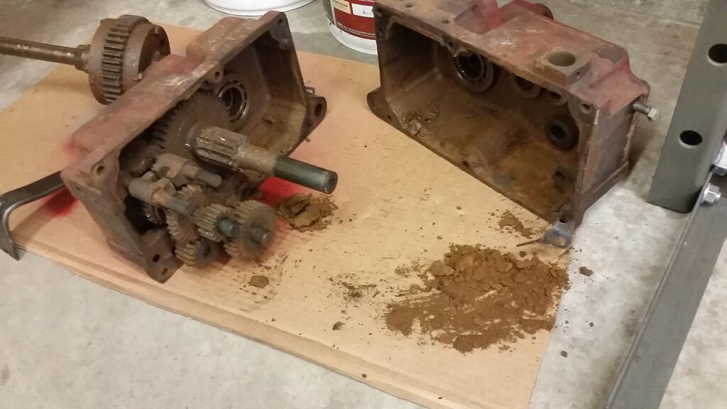

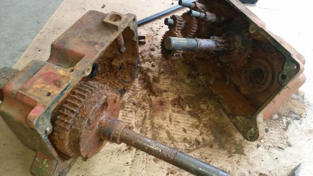

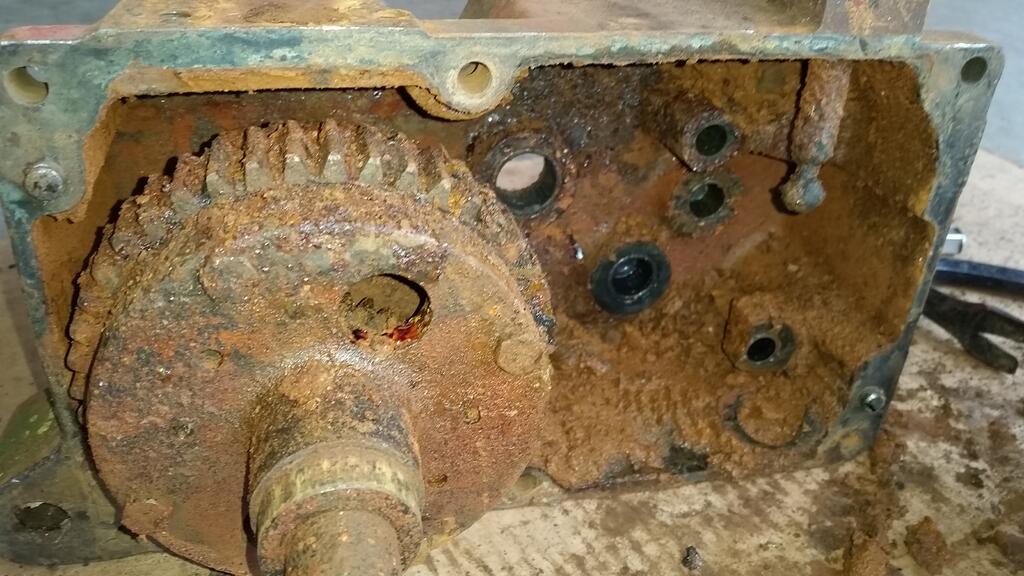

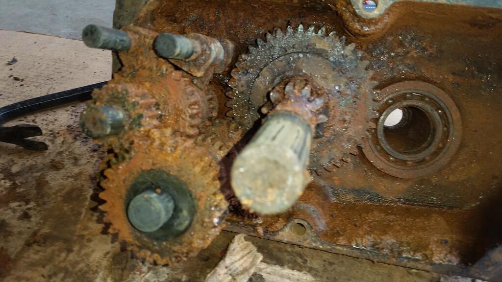

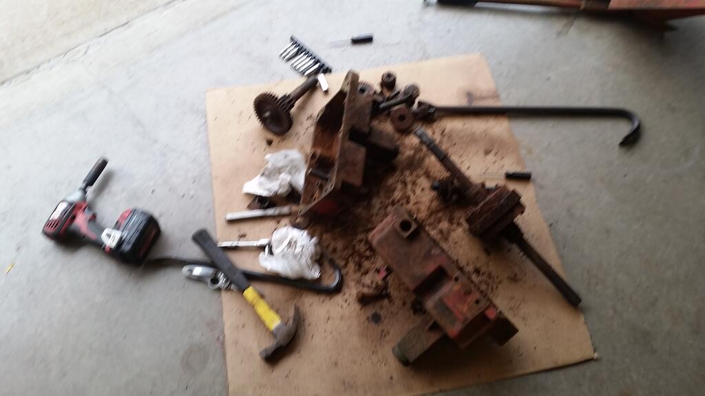

WHX?? 58,228 #3 Posted September 8, 2020 (edited) The good news is I have another three speed that I might be able to use parts from. Not much better shape than this one but won't be for lack of trying. Now the crappy work begins..... cleaning up this mess and see what other parts are usable. The donor tranny. A tad better but I must be a glutton for punishment! Not sure what model this is but guessing from a early to mid sixties. Will have to check some casting marks and see what @stevasaurus says. Just remembered this came off a 1055 so should be a 5049?? What say ye Dino? Edited September 8, 2020 by WHX24 6 Share this post Link to post Share on other sites
ebinmaine 80,767 #4 Posted September 8, 2020 Couple minutes with a wire brush and you'll be fine......... WOW 1 1 Share this post Link to post Share on other sites
AMC RULES 37,259 #5 Posted September 8, 2020 You know all that stuff is gonna buff right out. Geeze, such the drama queen! 🙀 2 9 Share this post Link to post Share on other sites
WHX?? 58,228 #6 Posted September 8, 2020 8 minutes ago, ebinmaine said: ...... WOW Right EB!?!?! We see these guys here crack open trannies and a quick run through the parts cleaner, a couple of seals maybe some bearings and good to go right? No such luck here! 1 Share this post Link to post Share on other sites
oliver2-44 11,758 #7 Posted September 8, 2020 Throw it in an e-tank an it will look better in a few days 5 2 Share this post Link to post Share on other sites
ebinmaine 80,767 #8 Posted September 8, 2020 1 minute ago, WHX24 said: Right EB!?!?! We see these guys here crack open trannies and a quick run through the parts cleaner, a couple of seals maybe some bearings and good to go right? No such luck here! Yeah I haven't seen any really nasty ones yet. I've taken apart maybe six or eight transmissions I guess? Some of them had some rust on the top half where the airspace would be but all of them have been really really mucky but usable once cleaned up. Share this post Link to post Share on other sites

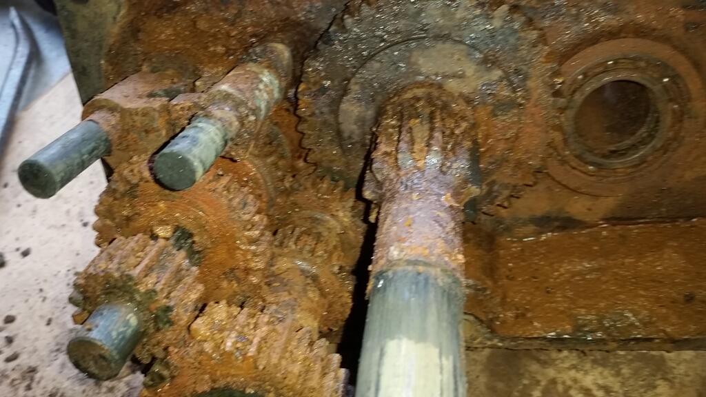

WHX?? 58,228 #9 Posted September 8, 2020 This was a different one too. The shifter busted off at the ball. Getting the stub out was a chore here but luckily the dog point was already out/missing.. I may make Dan repair & resto this just for paybacks! 2 Share this post Link to post Share on other sites

stevasaurus 23,857 #19 Posted September 8, 2020 Some scraping, a 4" grinder with a wire wheel, then electrolysis (WITH THE WASHING SODA), the sand blast with plastic pellets and it will be like brand new. The 1st trans is probably a #5007. With the other one being a #5049...do me a favor and put up some good pictures of the shift rails. They look different to me in the picture you have here. I believe this is going to be where the difference is between this and the 5053. 2 Share this post Link to post Share on other sites

WHX?? 58,228 #22 Posted September 8, 2020 (edited) 7 hours ago, Greentored said: OY, thats an evil lookin one! Could that case half be bored and a larger OD bushing pressed in, or arent these cases too hard to come by? You guys ever try citric acid for de-rusting? Cheap, goes a long way, works incredible, and if you dip your fingertip in and try it, it tastes like a sour patch kid lol. (try this BEFORE dipping parts, not after) Naww boring the case would get to be too pricey as I don't have a machine shop in my back pocket. What a regular shop would charge just for setup would be crazy $$. Then getting it back in the right spot. They are not too hard to come by you know where to look. More info on the citric acid tho Green where do you get the stuff I'd try anything once... twice I like it! Last one I pretty much did what Dino said on a wire wheel on the grinder. Messy but worked. I may try sand blasting this time too.... can't make them any worse. The problem with trying to save them in any fashion is two much metal gone off the gears. You lose the tolerances so you are gonna have a noisy beast but that's ok as you're not using them for workers other than light tub duty, putting around the 'hood. No high stakes pulling or flying them at 33,000 feet! 10 hours ago, pullstart said: vinegar, the smell is unbearable. 8 hours ago, The Tuul Crib said: Sallies! Thanks for the confidence booster @pacer ! Pretty sure the only difference is the donor tranny has flats on the rails Dino... will know more after cleanup. Prolly not gonna be for awhile tho got a tractor show to get ready for ! Edited September 9, 2020 by WHX24 Speeling & gramma 4 Share this post Link to post Share on other sites
