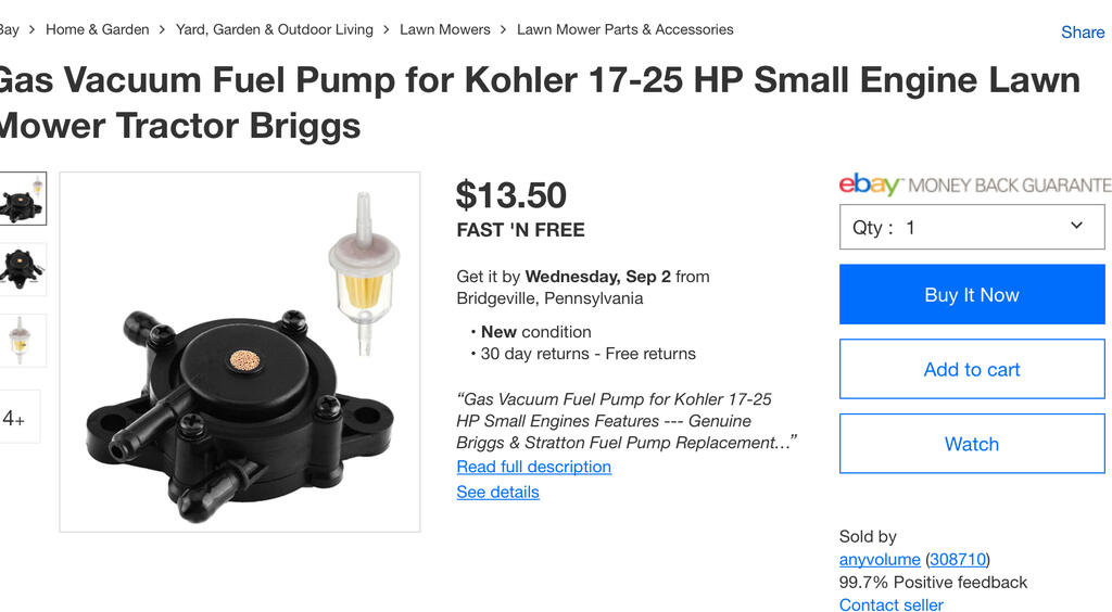

Pullstart 71,329 #8 Posted August 27, 2020 @dells68 has made a block off plate with an 1/8” tap and used a remote mounted late model vacuum pump with success... 2 Share this post Link to post Share on other sites

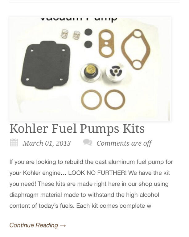

BOB ELLISON 2,983 #10 Posted August 27, 2020 (edited) I ordered 2 sets from then and now in june of this year. I rebuilt my c160 pump and it works good. But you have to call him. I never could get a return email. http://www.then-now-auto.com Edited August 27, 2020 by BOB ELLISON 1 1 Share this post Link to post Share on other sites

WHX?? 58,227 #12 Posted August 28, 2020 2 hours ago, pullstart said: @dells68 has made a block off plate with an 1/8” tap and used a remote mounted late model vacuum pump with success... Ney ney Jose.... Bob and I are purists of heart and Kohler. We want orginal! Good news Bob I should just try putting the original diaphragm back in again nothing to lose. @BOB ELLISON I was under the impression then and now only had kits for the cam lever pumps? We are talking about the pulse pumps here OEM on the 7 & 8 HP's. Share this post Link to post Share on other sites
BOB ELLISON 2,983 #13 Posted August 28, 2020 12 minutes ago, WHX24 said: Ney ney Jose.... Bob and I are purists of heart and Kohler. We want orginal! Good news Bob I should just try putting the original diaphragm back in again nothing to lose. @BOB ELLISON I was under the impression then and now only had kits for the cam lever pumps? We are talking about the pulse pumps here OEM on the 7 & 8 HP's. Yes I'm referring to the original fuel pump that works off the cam. Thank for the correction. Share this post Link to post Share on other sites

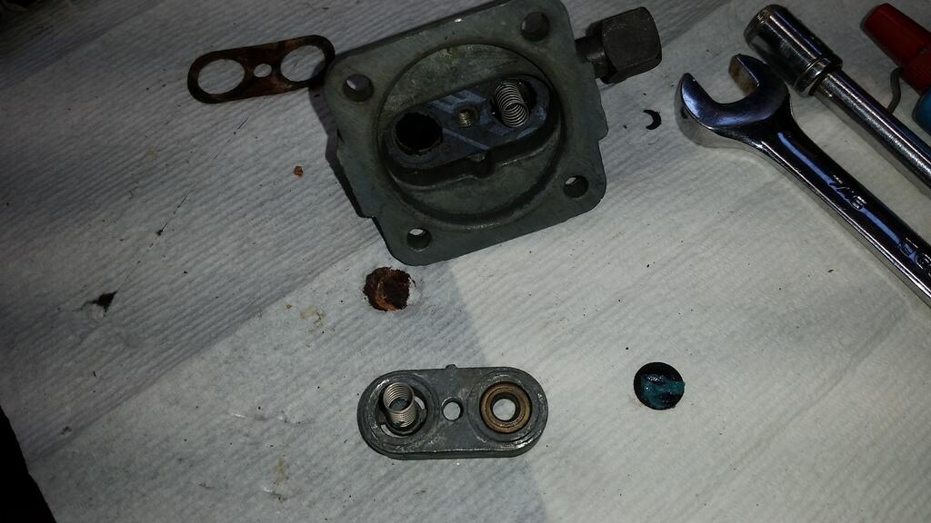

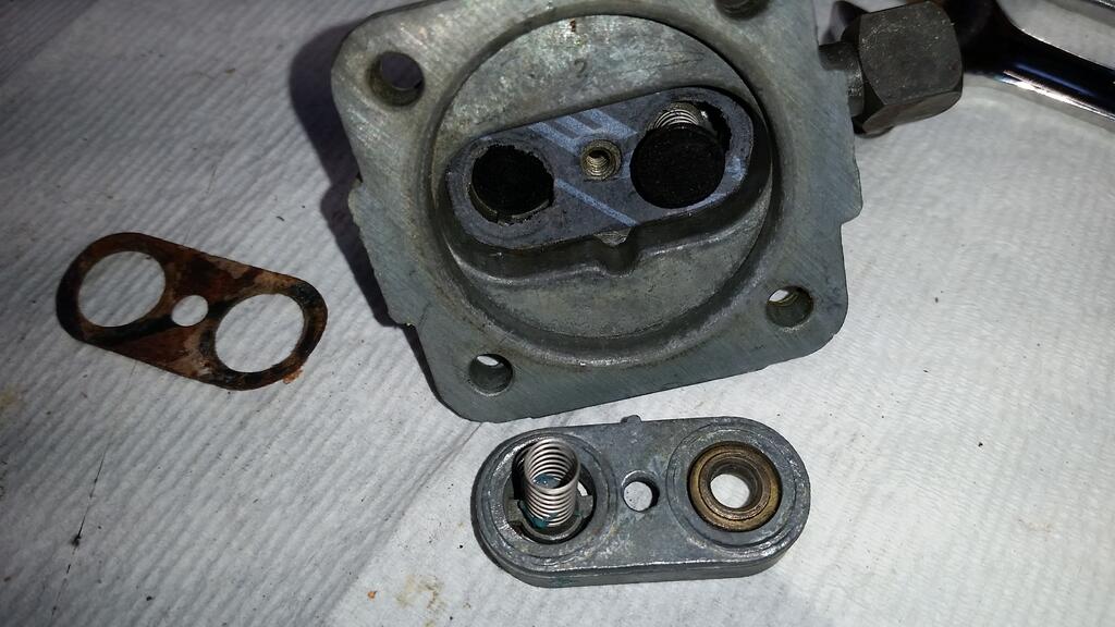

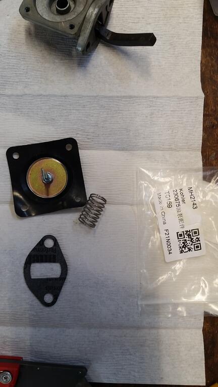

WHX?? 58,227 #17 Posted August 28, 2020 (edited) 12 hours ago, BHunter said: Your springs are bigger. Correct Bob those are not the original springs. Those are from a gas valve conversion kit ( @squonk knows) that I was just experimenting with but seem two heavy. This pump did not have any or got lost in disassembly. The originals are quite dainty. This kit was from an ebay cheapy source for the cam style. Not much to it but two of them for 14 bucks. No valve plate gasket, valves, springs or anything. What you see is what you get. Note the made in China ....... go figure. That first pic I had to make a valve plate gasket using the old one as a template. Good enough to experiment with tho. Was thinking grind off the diaphragm to cam lever connector and try just using the diaphragm in a pulse style pump. Like Jennifer have one coming from then and now as well to play with and evaluate. Like I mentioned earlier trying to collect information about pumps to do a rebuild instructional thread on them. Plus I'd like to have a spare of each style on the shelf ready to roll if one goes out. Edited August 28, 2020 by WHX24 Share this post Link to post Share on other sites
