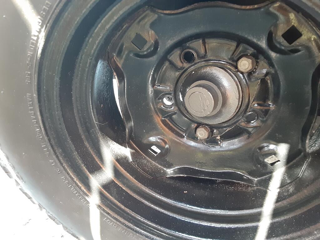

If I were closer I have two or three you could have. Looks like a a standard 6” rim a early WH would have. Most garden tractors use the 5 on 5 1/2” (Ford /Dodge) bolt pattern.
@D_Mac https://rochester.craigslist.org/grd/d/honeoye-falls-lawn-mower-12-rims/7160071703.html
I’d also check the other rim for damage.
Edited by ACman
  • Thanks 1
D_Mac
When I took the bad wheel off I spun the other rim around. It seemed to spin straight so I believe the damage was limited to the one side. In the first photo you can see how high the curbing is. I thought the Cub was going to roll right over the Lambert like a monster truck. Most likely would have if I didnt kill the engine. I am glad that the fenders didnt get damaged. I wouldnt have been able to replace those. Funny I just mentioned earlier today I would be willing to let it go and this happens. It would have been alot worse. Could have damaged all 3. No damage on the Cub because that thing is a beast, and the Speedanza seems ok. Can look at it as bad luck as or good luck...lol... im not sure yet ! Bad luck it happened at all or good luck it could have been a lot worse.

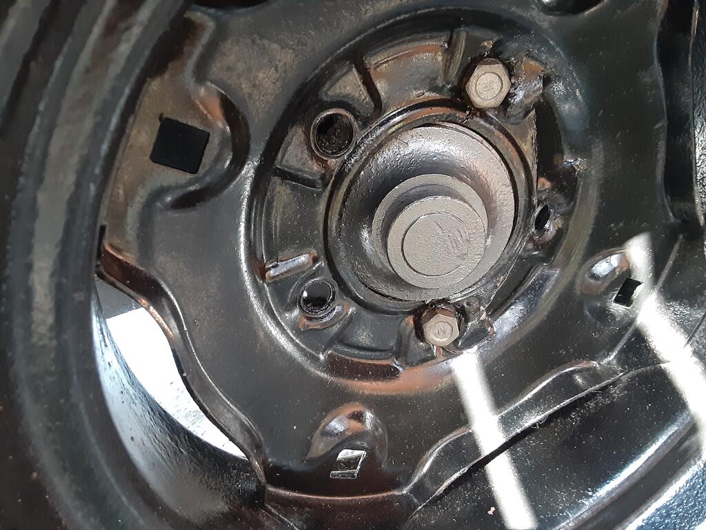

D_Mac
Took the wheel to my cousins house today. He got it nice and straight again. There is nothing he cant do. He had a ford rear end, all 5 lugs lined up. We bolted on the rim and cranked all 5 lug nuts down. Then turned the wheel over and did the same thing on the other side. Couple of wacks with a sledge hammer and a big punch and it was good as new. He had some black paint so we cleaned it up and painted it.... can hardly tell. Then he made me another wheel bolt. I only had two on that wheel. Thats why it bent. So he fabricated me another one in his shop. Brought the wheel home and bolted it on. Spun it around, everything spins straight. Glad to have if fixed. I will try to erase that crash from my memory !
  • Like 1
  • Excellent 3
71_Bronco
Is the metal on the center of the wheel cracked? Or did it just bend, and the paint cracked? Hard to tell from the pic. Glad to hear you got it straight though.
