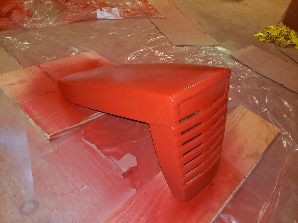

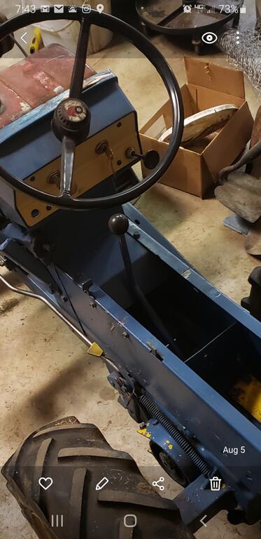

Gordyhogg 150 #33 Posted August 7, 2020 Will do! I will have to post a picture of this later but would you guys have any idea why the shifter touches the frame when its in 2nd gear? Also heres a little sneak peek at the new paint 1 Share this post Link to post Share on other sites
WHX?? 57,470 #34 Posted August 7, 2020 Looks nice, Is the shifter bent? Share this post Link to post Share on other sites
Gordyhogg 150 #35 Posted August 7, 2020 1 minute ago, WHX24 said: Looks nice, Is the shifter bent? Thanks! Not from what i can tell but its entirely possible Share this post Link to post Share on other sites

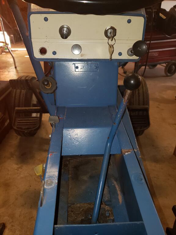

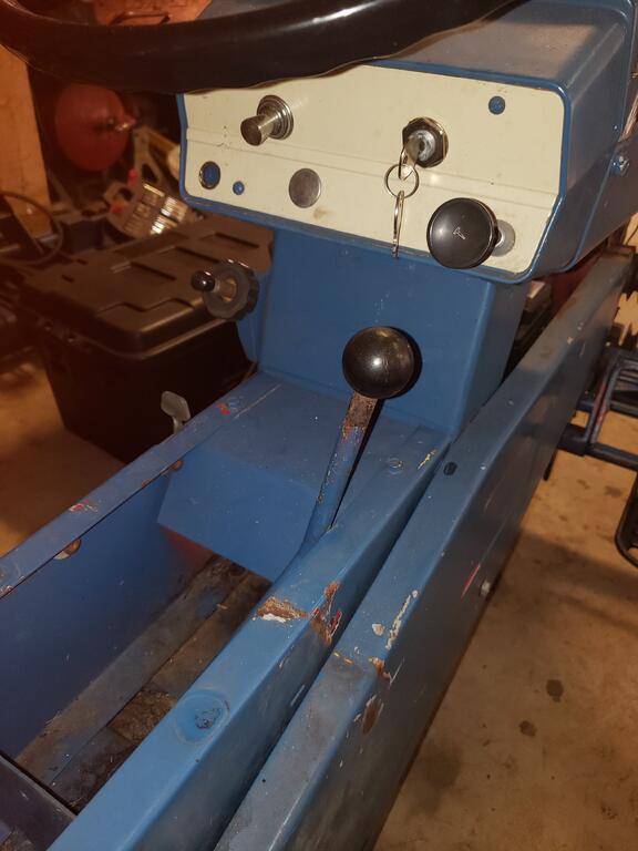

Gordyhogg 150 #36 Posted August 7, 2020 If you look real close in this picture you can see the divet where its hitting Share this post Link to post Share on other sites
Gordyhogg 150 #37 Posted August 7, 2020 Heres where its hitting and stick doesnt seem bent Share this post Link to post Share on other sites
ebinmaine 79,740 #38 Posted August 7, 2020 Maybe the forks have a bit of play? When you assemble it you can double check the adjustment on the dog point screw. 1 Share this post Link to post Share on other sites
Gordyhogg 150 #39 Posted August 8, 2020 11 hours ago, ebinmaine said: Maybe the forks have a bit of play? When you assemble it you can double check the adjustment on the dog point screw. Is that the one that holds the shifter in the hole? Share this post Link to post Share on other sites
ebinmaine 79,740 #40 Posted August 8, 2020 8 minutes ago, Gordyhogg said: Is that the one that holds the shifter in the hole? Yessir 1 Share this post Link to post Share on other sites

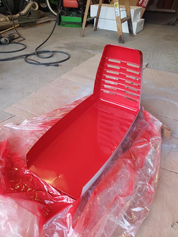

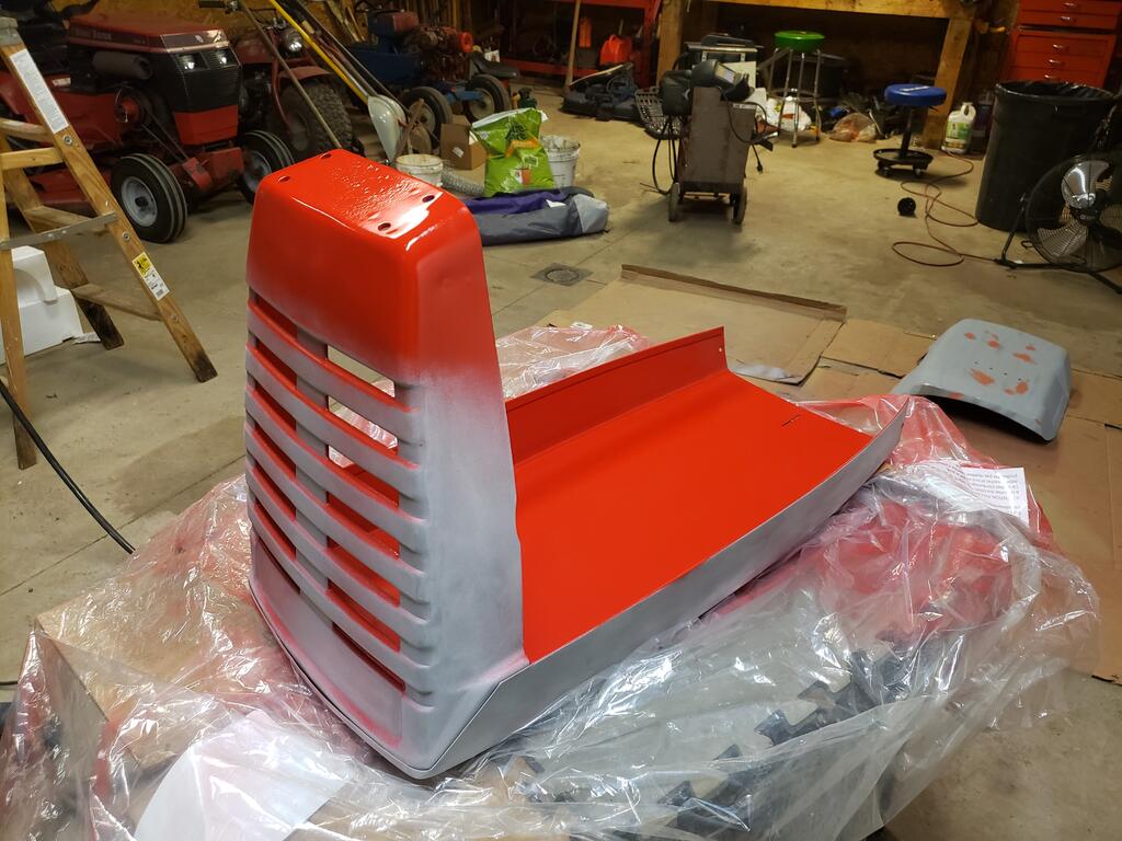

Gordyhogg 150 #44 Posted August 11, 2020 (edited) finished the hood! And also painted the mount and four bolts (not pictured) next will be to finish the body work on the fenders and paint them too. Edited August 11, 2020 by Gordyhogg 2 Share this post Link to post Share on other sites
