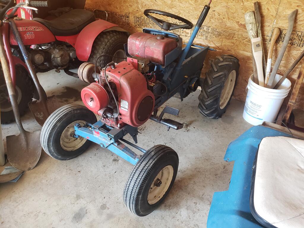

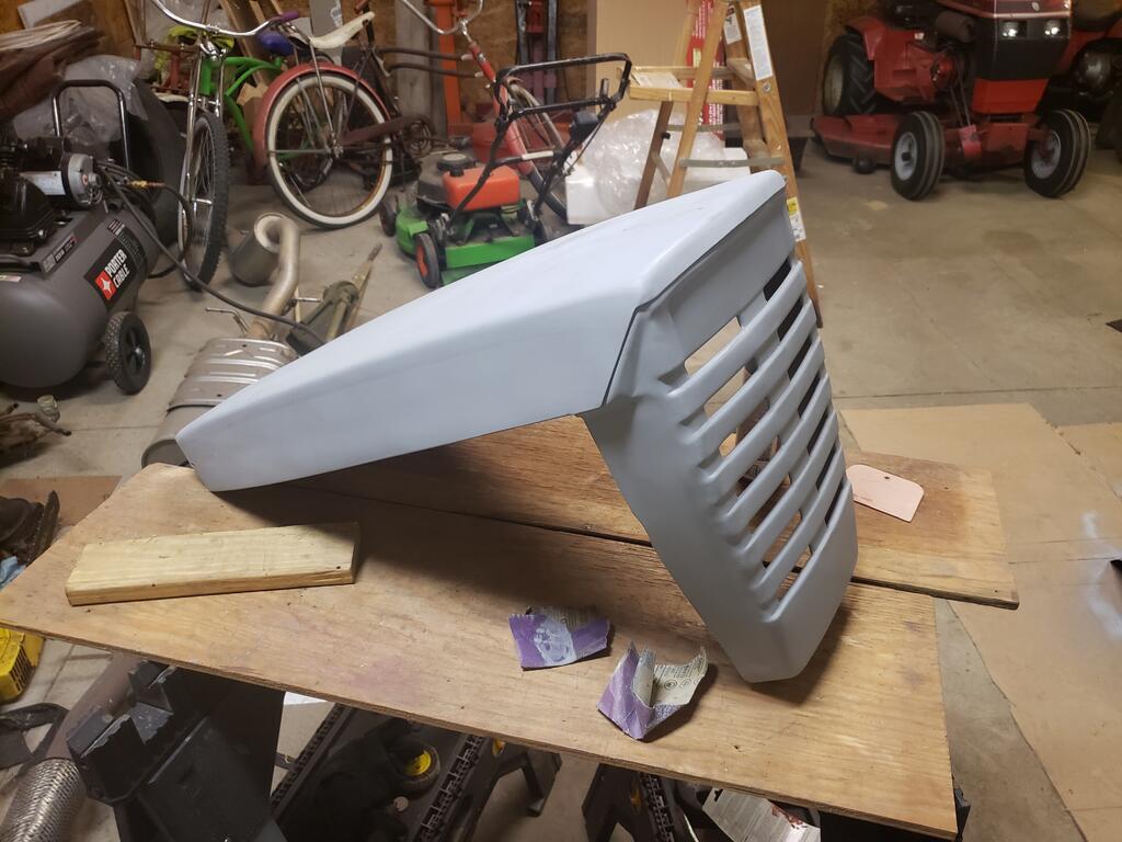

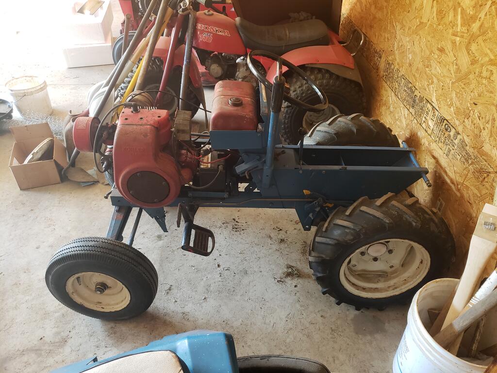

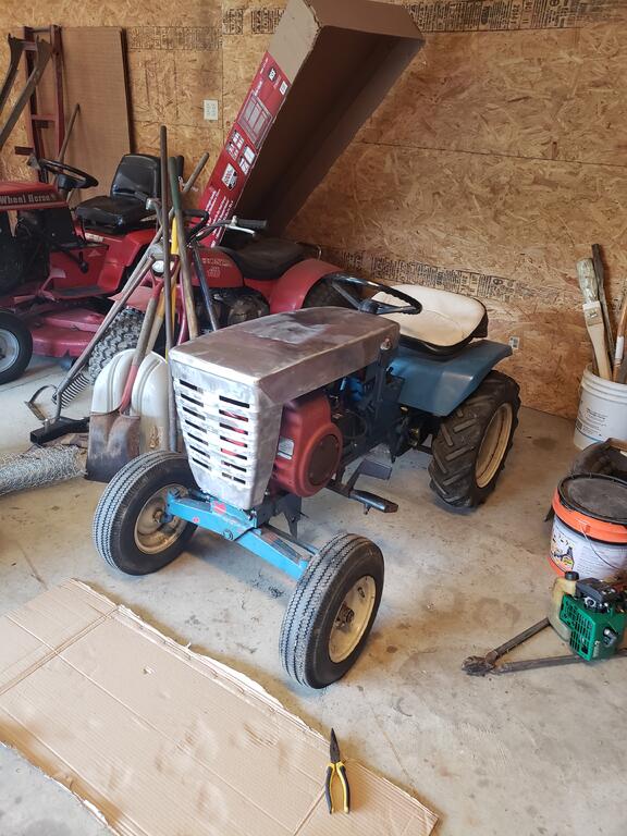

Gordyhogg 150 #1 Posted August 4, 2020 (edited) hey guys im repainting the "horse of a different color" need an opinion. Its originally a 656 with a 6 horse tecumseh in it but i dropped in an 8hp kohler k181 with electric start. Would you guys keep it original and put the 656 decals on it or would you put 856 decals on it since its an 8 horse now? Edited August 4, 2020 by Gordyhogg 3 3 Share this post Link to post Share on other sites

Gordyhogg 150 #21 Posted August 4, 2020 I love the way you guys think outside the box 🤣🤣🤣 im really thinking about just going with 856 to keep it simple. But, time will tell. Any pointers on painting the frame/transmission? I really dont want to have to poly disc this whole tractor down to bare metal haha i just wanted to do it to the tins since theyre the first thing you see. Still gonna be a working tractor but it has to be red again Share this post Link to post Share on other sites
Racinbob 13,047 #22 Posted August 4, 2020 I have always torn them down and painted each part separately because I always open up the tranny for inspection and if I have it that far apart I figured I might as well go all the way. I would definitely consider leaving some things still assembled on the next one. Give it a good pressure washing and degrease with whatever you like (I use Simple Green undiluted) and hit it again with the pressure washer. I think you'll like the results. 1 Share this post Link to post Share on other sites
Redneckdavis 308 #23 Posted August 4, 2020 Simple green, a tire brush and pressure washer. How much loose paint or crud? How good is your pressure washer? The more pressure the better, but there is an attachment for sandblasting. You can buy for about$30 on Amazon or eBay. Fits where standard tip does, and has hose ran to a spike you put in your bucket of sand. I use standard $5/50# bag play box sand. I got mine a few months ago and have been using it. Worked pretty well. Kinda 2 in one, you were gnna wash it anyway. Share this post Link to post Share on other sites
