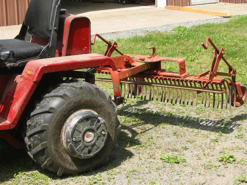

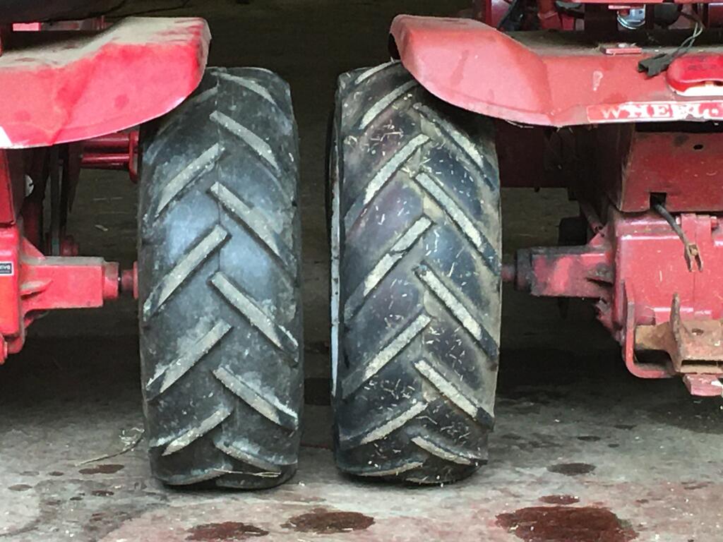

Pullstart 69,553 #5 Posted August 3, 2020 There is an option of 10.5” 23’s too. They would take no modification to fit what you have. not a C series, but you can see the difference between 26x12-12 and 23x10.50-12 on the style tractor. The big ones I believe are on an 8” wide wheel. 1 1 Share this post Link to post Share on other sites
RandyLittrell 3,944 #6 Posted August 3, 2020 15 hours ago, sqrlgtr said: Should of mentioned was interested in the tractor lug tires.Ive got 23x8.50-12 on it now but they look smaller then the 8.50’s thats on my 73 12hp no name tractor both with tractor lug but do look better after I put the tri ribs on the front.Was hoping to see some pictures with the 24/26x12-12 on the 7” rims. Thanks If they are Deestones, they run very small. 10.50's more like 8.50's and short too. Carlyle and Hi-runs run true on size I believe and probably others, but it's best to find out from someone that has bought some. True 26's need 8.5" or 10.50" wheels, the 7's are just too narrow. Randy Share this post Link to post Share on other sites

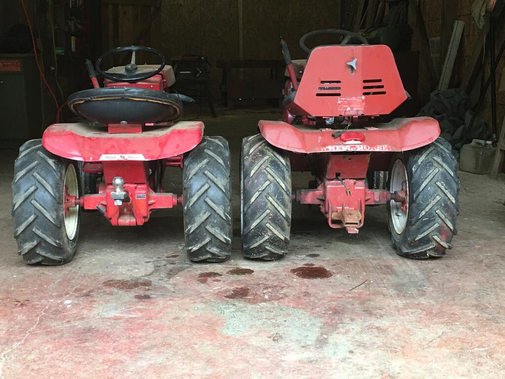

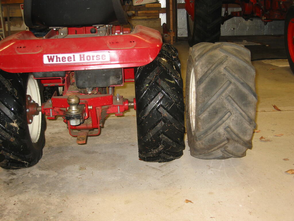

pfrederi 20,197 #8 Posted August 3, 2020 Deestone 10.50 23 x 12 on 7 inch rims Carlisle 10.50 23 x12 in 8 inch rims to the right. 2 Share this post Link to post Share on other sites
Pullstart 69,553 #9 Posted August 3, 2020 16 minutes ago, Redneckdavis said: @pullstart you had to remove fenders though? for the 26” tires, yes the round fenders needed removed. Luckily, I didn’t have any handy, I used them on Jada’s 857 mock 1045 build... 1 Share this post Link to post Share on other sites
sqrlgtr 2,506 #10 Posted August 3, 2020 2 hours ago, RandyLittrell said: If they are Deestones, they run very small. 10.50's more like 8.50's and short too. Carlyle and Hi-runs run true on size I believe and probably others, but it's best to find out from someone that has bought some. True 26's need 8.5" or 10.50" wheels, the 7's are just too narrow. Randy 2 hours ago, pfrederi said: Deestone 10.50 23 x 12 on 7 inch rims Carlisle 10.50 23 x12 in 8 inch rims to the right. Thanks fellers this is what info. I was looking for.Hard to belive there is that much difference in the same size between manufacturers.Looks like I might want to try the 23x10.50-12 carlisle's.Wish I would have taken a picture of the c-160 with goodyear 23x8.5-12's beside the ol 857 with the deestone 23x8.50-12's today but forgot to.They are pretty equal in height and width.I dont have any desire to relocate any fenders lol.Found some 8.5" wide rims but dot know how proud the gentleman is of them ha ha.The 24x12-12 tires seem to be harder to find then the others and dont appear to be any taller then the 23's.. 1 Share this post Link to post Share on other sites

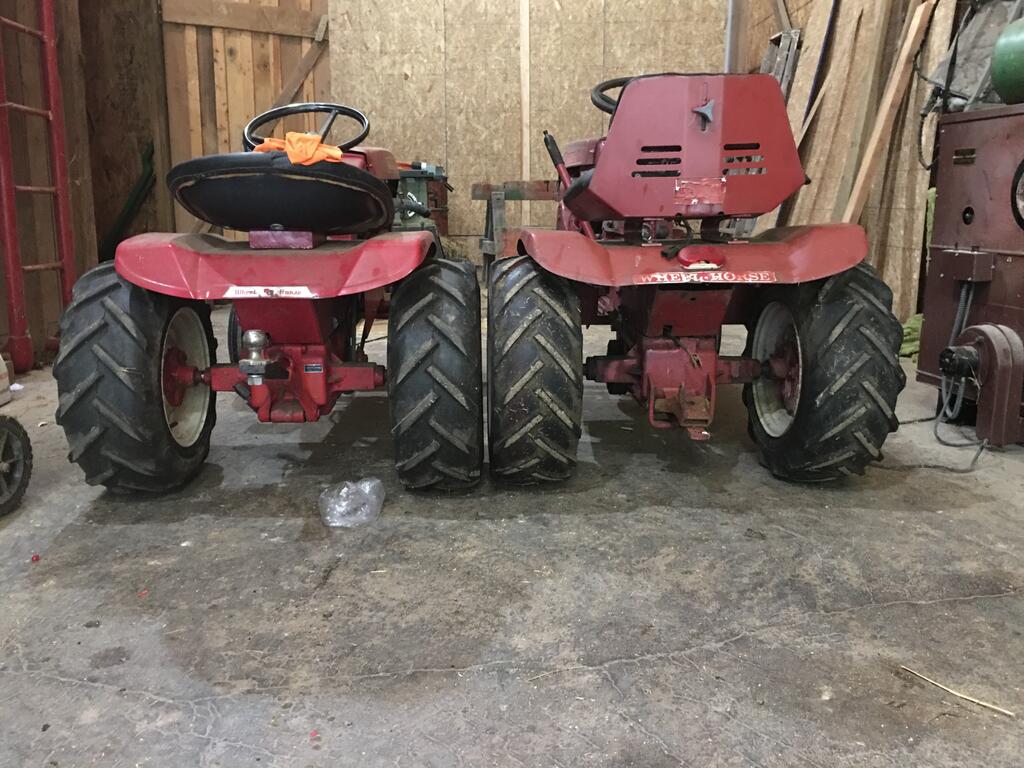

sqrlgtr 2,506 #14 Posted August 3, 2020 (edited) Here is couple pics of 857(deestones) and c-160 (goodyears).The goodyears are actually a little taller than the deestones,but from a distance they look shorter?Both are 23x8.50-12’s on 7.5” rims.Man I would like to fill that 160’s fenders with some biggins.Has anyone had there hands on the OTR landtrak tires they look pretty mean but hard to tell on the interweb pics... Edited August 3, 2020 by sqrlgtr Forgot pics Share this post Link to post Share on other sites

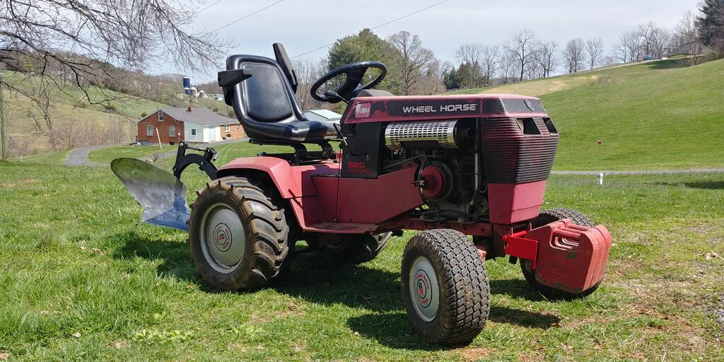

WVHillbilly520H 10,378 #16 Posted August 4, 2020 @RandyLittrell , thanks for the mention, Yes I have 2 WH 520s with the 23×10.50-12 (on 8.5" wide rims) OTR Lawn Trac R1 and I am absolutely happy with them (they come as Original Equipment on the Kubota BX series so that should say quite a bit about them) with Nanco or Deestones (iron weights and fluid filled) I still needed chains in the winter but with the OTRs no chains as of yet but don't take my word for it buy a pair and see for yourself. Share this post Link to post Share on other sites

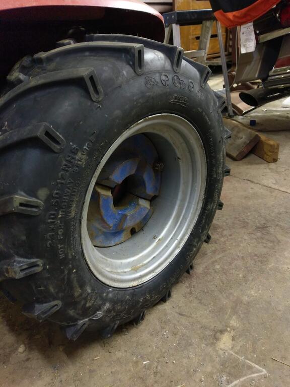

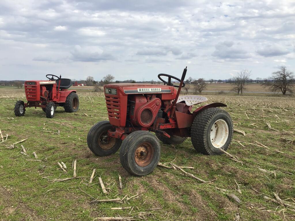

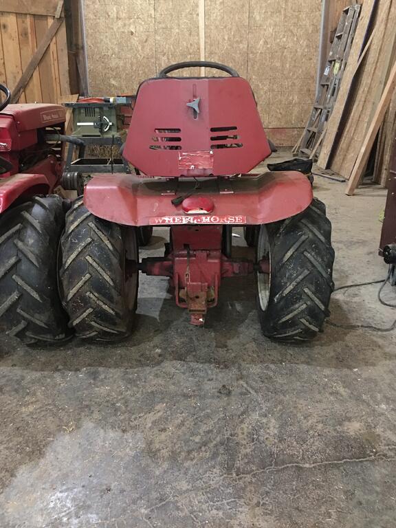

sqrlgtr 2,506 #20 Posted August 26, 2020 Just wanted to follow up on this thread and share with yall what I ended up with on the back of “thumper”.Found these wheels and tires on and old monkey ward tractor.They are 23/10.50-12’s on what appears to be 8/8.5” wide wheels.They have a different backspace then the wheel horse rims but I really like the “tucked” looks of them plus they are already loaded with fluid .Aired them up and if the stay up like they are supposed to will pull them off and paint um up,if yhey dont will be putting new tubes and fluid in them....before and after pic... 2 Share this post Link to post Share on other sites
