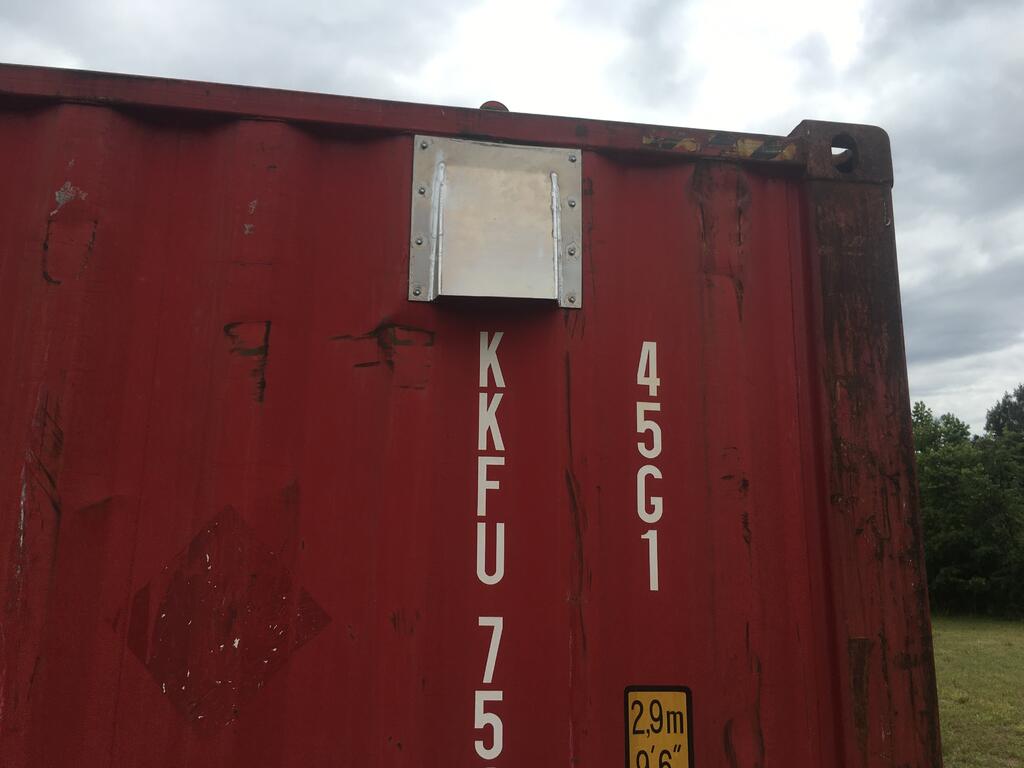

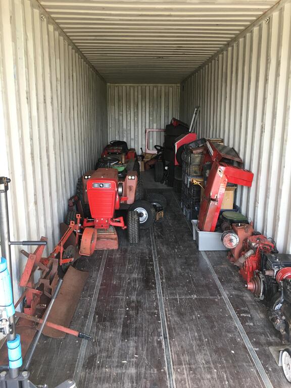

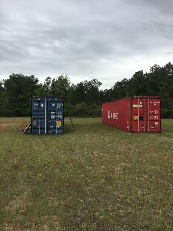

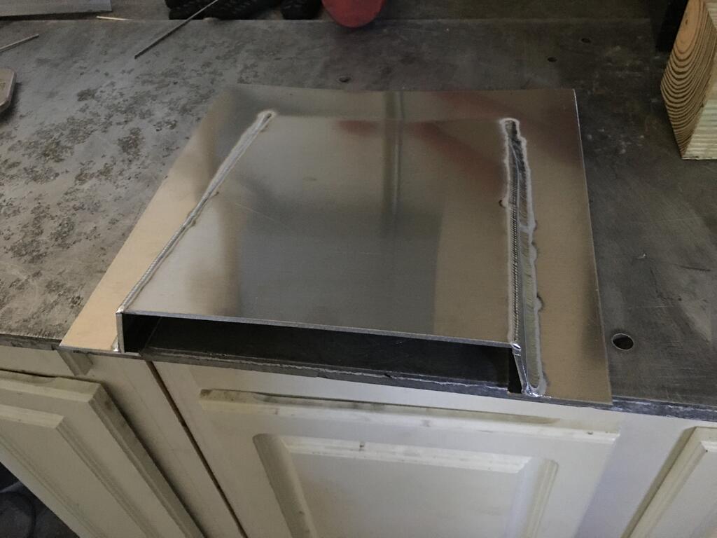

19richie66 17,936 #18 Posted August 1, 2020 Only problem I have had so far is “container rain”. They sweat inside and drip from the roof in cold climates. You have to insulate at least the ceiling with closed cell foan or spray foam insulation. I have two high cubes I want to build a 20x40 pole barn between and put awnings out over them from the barn. Cover the roofs. I also made side vents for mine and cut open larger holes with mesh behind them for cross ventilation. Eventually have exhaust fans. I love mine. 2500 for one and 2700 for the other. 2 5 2 Share this post Link to post Share on other sites

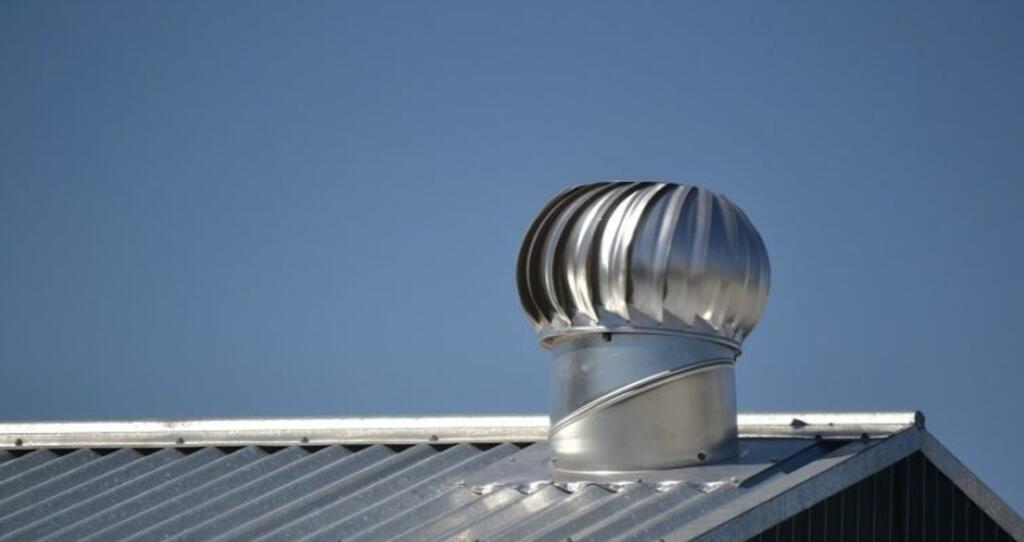

Tractorhead 9,217 #22 Posted August 1, 2020 I checked all my possibillities to get my Machines in a Barn. @TractorJunkie i was also still lurking for an 40 foot container. To hide that ugly for the neighbours you can hull it outside with Wood, so it looks it where built of Wood or repaint it, that‘s up to you. I think for hot summerday‘s a exo shell of Wood will keep it internally much cooler like an added insulation. But it‘s a good solution to talk with neighbours and get their Ok ahead to prevent unwanted surprises than. i know also about the Theme inside moisture, that can become to rain someday‘s. An insulation inside the ceiling is recommended even the Breather @19richie66 built is a great idea, to get a breathing between inside and outside and moisture can pass out. After i get my promis for a 70 sqm part of a huge Shed where i can rent for cheap, i dropped this search. The biggest Advance is i can install a Car Lift in that Shed, i can‘t do sensefully in a Container. But my Plan before where a Container because cheap and if needed easy to move even later on. still have to wait at least 2 years, but that timeline go fast. 3 Share this post Link to post Share on other sites

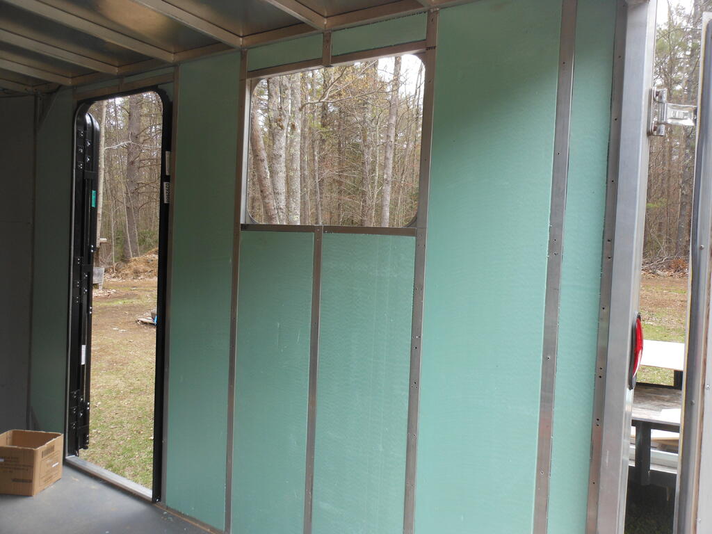

JCM 11,417 #25 Posted August 1, 2020 @19richie66 you are correct about the closed cell foam, that is what I used on the cargo trailer converted into a mini WH hauler and have no moisture issues and noticed a 10 to 15 degree drop in inside temp and should be warmer when camping in cooler weather. the added roof vent with maxx air cover to be able to leave vent fully open on rainy days. 3 1 Share this post Link to post Share on other sites
