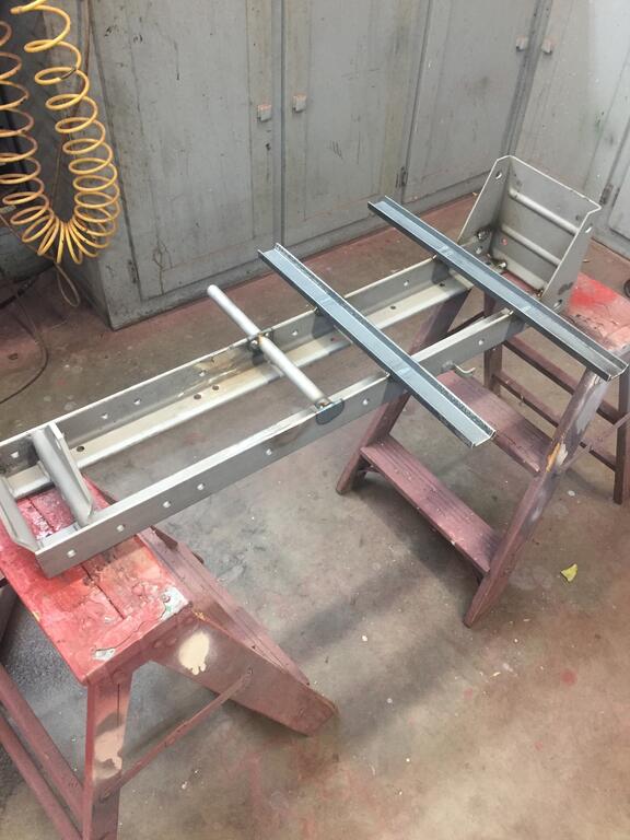

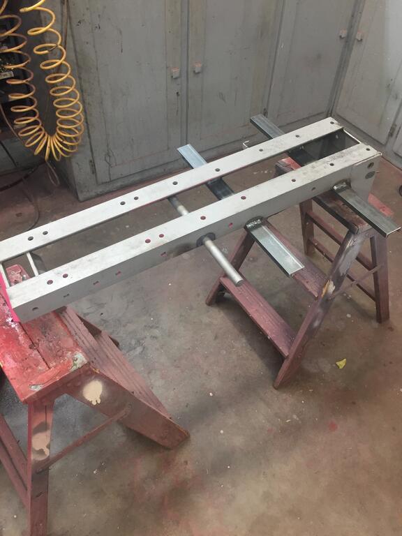

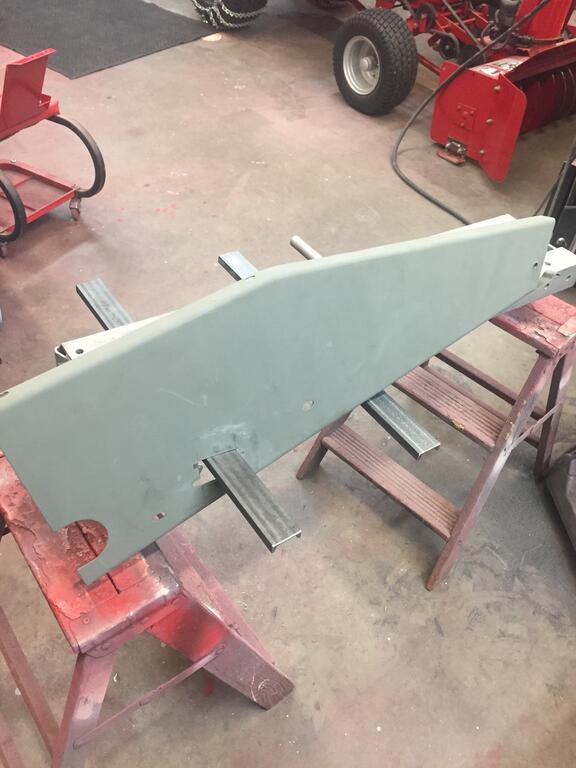

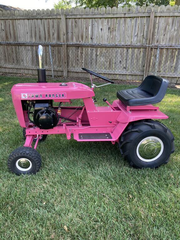

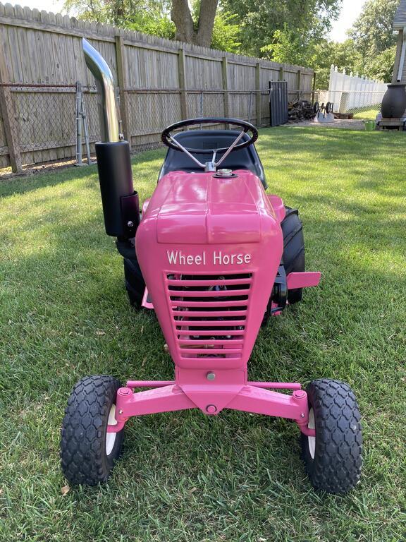

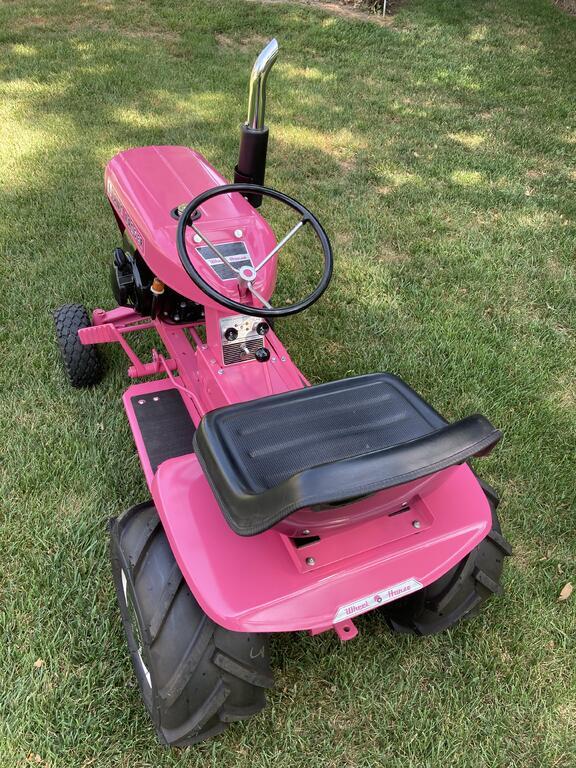

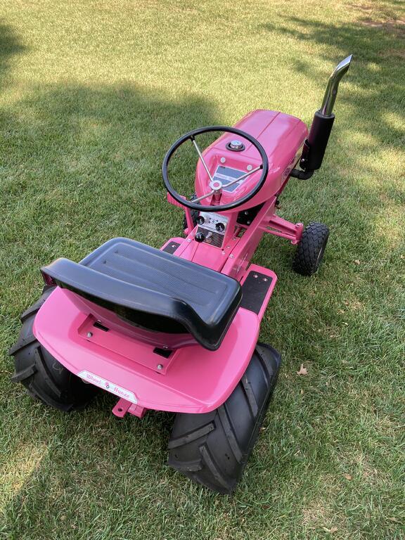

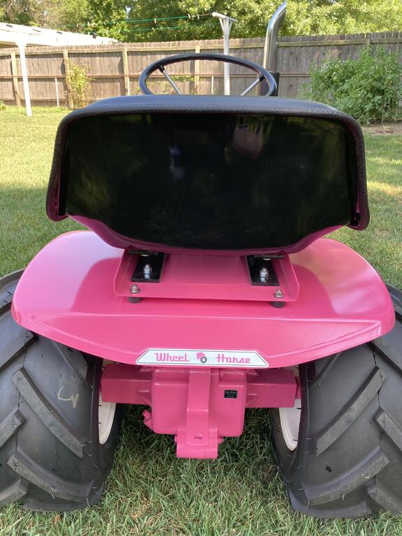

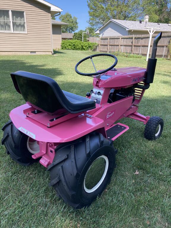

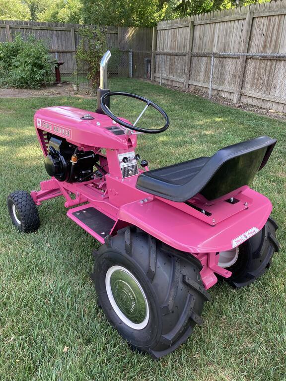

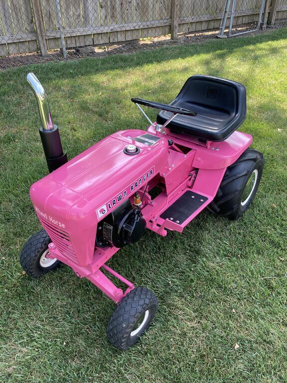

Terry M-(Moderator) 2,304 #3 Posted July 31, 2020 I started this project in the Fall of 2014. Disassembled the entire tractor,sandblasted most of the parts ,primed and painted several of the parts , rebuilt the unidrive transmission,blasted and powder coated the rims and pretty much just started collecting parts including a k91 Kohler . also picked up the parts for rebuilding the k91 including a NOS .030 piston ring set, NOS piston rod and NOS Crankshaft. Also ordered from Terry a custom set of pink lawn ranger decals for the 68 ranger which was custom matched to the paint color of the tractor. And thats about as far as I got and the project was shelved for over 4 years due to life getting busy. So last summer my Friend Denny Clarke @dclarkeoffered to finish this project for me as a winter project to keep busy. Knowing how Nice of a Job Denny does on his restorations (especially Lawn Rangers) i had to say YES! To Make a long story short...Here are some pics. 8 4 5 Share this post Link to post Share on other sites
Terry M-(Moderator) 2,304 #4 Posted July 31, 2020 9 7 3 Share this post Link to post Share on other sites

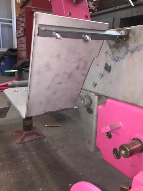

oliver2-44 11,632 #5 Posted July 31, 2020 (edited) Excellent Restore. For the foot rest supports did y'all weld some round rod to the frame on each side? Would you mind posting a bottom picture? I see a pink tractor in my future. Edited July 31, 2020 by oliver2-44 3 Share this post Link to post Share on other sites

dclarke 4,270 #7 Posted July 31, 2020 9 minutes ago, oliver2-44 said: Excellent Restore. For the foot rest supports did y'all weld some round rod to the frame on each side? Would you mind posting a bottom picture? I see a pink tractor in my future. We used 1-1/2” channel iron for foot rest supports. Also moved the brake pedal rod back to position it at the front of the running board. 7 4 Share this post Link to post Share on other sites

dclarke 4,270 #9 Posted July 31, 2020 25 minutes ago, oliver2-44 said: Excellent Restore. For the foot rest supports did y'all weld some round rod to the frame on each side? Would you mind posting a bottom picture? I see a pink tractor in my future. The back of the foot rest was supported as well, using angle iron. 4 3 Share this post Link to post Share on other sites
