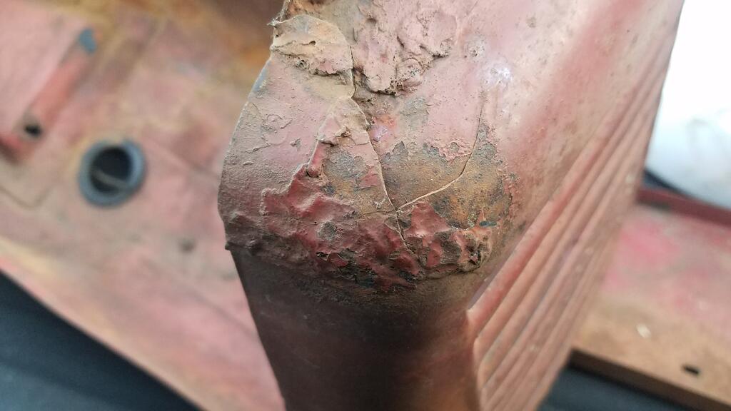

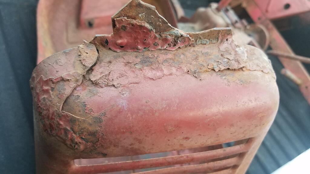

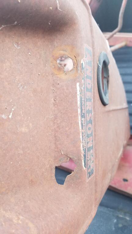

DBlackston 333 #1 Posted July 19, 2020 I have a 704 hood with a few cracks and old welds. It is the worst around the mounting surfaces. How do you guys recommend fixing these areas? This is my first bodywork adventure. 1 Share this post Link to post Share on other sites
stevasaurus 23,816 #2 Posted July 19, 2020 You probably already know this. 1st thing is to get all that Bondo gone and get down to bare metal. Share this post Link to post Share on other sites
squonk 47,992 #3 Posted July 19, 2020 By the time you get all that bondo off there is going to be nothing left. I would try to find another hood. 2 Share this post Link to post Share on other sites
DBlackston 333 #4 Posted July 19, 2020 704 has the round back as you know. What other models had this? Share this post Link to post Share on other sites
wallfish 20,553 #5 Posted July 19, 2020 654 604 and a bunch of Lawn Rangers used that hood. Grind all that stuff off. Cracks tend to keep going even after repairs if you don't drill a hole right at the end of them. The round circle of the hole gives it nowhere to go. Do most of the repair work from the inside of the hood, ie: welding. For the upper mounting holes, you can weld a washer on the inside to re-establish a nice round and secure hole. Share this post Link to post Share on other sites

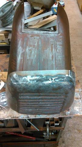

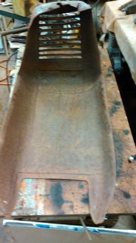

JPWH 6,544 #9 Posted July 21, 2020 This is how I repaired an 854 hood. Hope this helps. Jay 3 Share this post Link to post Share on other sites
