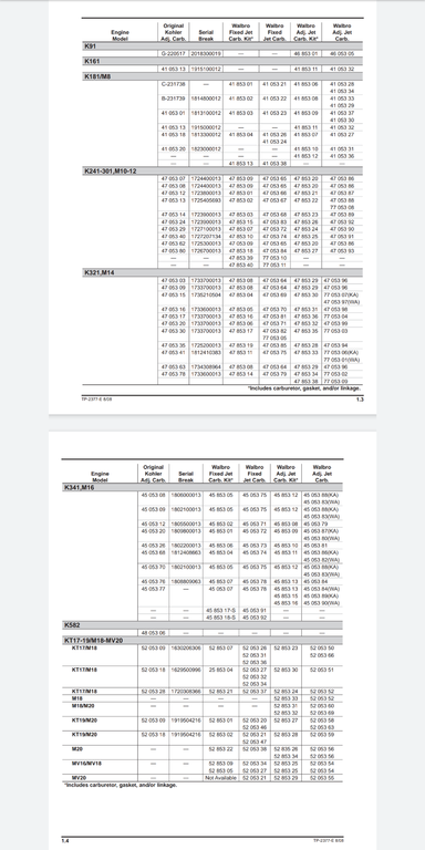

WVHillbilly520H 10,378 #8 Posted July 8, 2020 (edited) From my research #26 10-12hp then like above #30 14-16 HP... Now with the smaller carb you would notice a "crisper" throttle response but loose out on top end... Thing of cars small carb economy/drivability big carb not as streetable but good top end for WOT blasts.... Edited July 8, 2020 by WVHillbilly520H 5 1 Share this post Link to post Share on other sites
WVHillbilly520H 10,378 #9 Posted July 8, 2020 Here's a list direct from Kohler carburetors to models... 1 1 1 Share this post Link to post Share on other sites
WHX?? 56,841 #10 Posted July 8, 2020 Hard to read Billy... Where did you get it from? 1 Share this post Link to post Share on other sites
WVHillbilly520H 10,378 #11 Posted July 8, 2020 (edited) 1 minute ago, WHX24 said: Hard to read Billy... Where did you get it from? Small Engine Suppliers › htmlPDF Kohler Carburetor Reference Manual - Small Engine Suppliers. https://www.google.com/url?sa=t&source=web&rct=j&url=http://www.smallenginesuppliers.com/html/engine-specs/kohler/Kohler_Carburetor_Reference_Manual_TP-2377-E.pdf&ved=2ahUKEwi_6PD-vb7qAhXqknIEHaofDx8QFjAOegQIBRAB&usg=AOvVaw2UCmvLQmRCqm_qIHpv_hok Edited July 8, 2020 by WVHillbilly520H 2 1 Share this post Link to post Share on other sites
WHX?? 56,841 #12 Posted July 8, 2020 Yup I thought it looked familiar. We do have that one here as well. Handy one to have in the shop. Carburator Reference Manual TP-2377-E.pdf 1 1 Share this post Link to post Share on other sites
