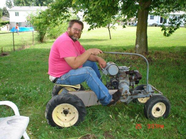

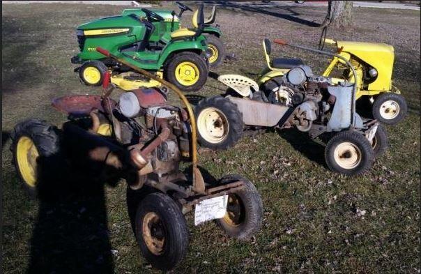

bottjernat1 2,196 #7 Posted July 6, 2020 Buy it These are rare machines and get anything else for it they may have manuals paperwok any of that stuff 2 I own 3 of them. My late dad had 12 i sold all but 3. i have a 1956,1957,1962 the first 2 are tiller steering the 62 is a fixed tiller with aircraft cable ran down the tube. I have a plow and cultivator and snow blade. They are great machines. Very unique. Idid a post a little bit back with anything and everything you might want to know. I will find the post and tag it for you. 1 1 1 Share this post Link to post Share on other sites

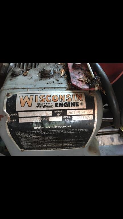

oldiron613 590 #15 Posted July 6, 2020 (edited) I don't have much to add that hasn't already been covered but will add that Baird Beavers are really unique, fun garden tractors! Based on the discription, I think the price is reasonable. I don't have any Beavers currently but have had a few in the past and really like them a lot. There were a number of variations to the Beaver models since production began in 1948. They used Wisconsin engines. The 1948 models used the small 4hp AB model and in 1949 they went to a little larger 6hp AKN. By 1961, they were using the BKN. With pictures of the actual tractor, I can help determine what it actually is and what parts might be missing or incorrect. Good Luck! Edited July 6, 2020 by oldiron613 2 1 Share this post Link to post Share on other sites

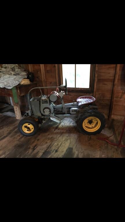

Oldskool 6,678 #19 Posted July 14, 2020 @oldiron613 @bottjernat1 @ebinmaine @Stepney Well, here it is. Not what was origanally described to me. (3rd party) info. Cool none the less. Any input/info would be greatly appreciated. 3 1 2 Share this post Link to post Share on other sites

bottjernat1 2,196 #22 Posted July 14, 2020 @Oldskool That is diffidently a later one with the steering wheel. See if this doesnt help http://www.beavertractor.com/models.html 1 Share this post Link to post Share on other sites

oldiron613 590 #24 Posted July 14, 2020 (edited) Wow, that looks great! So what the tractor is, is a 1959 Deluxe model having the optional steering wheel and 3-speed transmission. The steering takes some getting used to as it steers with aircraft cable that runs through the steering tube so it's not real tight steering, but works. This tractor looks relavively correct with exception to the plastic hood that's missing which HAPCO parts now reproduces that you can buy for it. The sulky isn't original but neat none the less. Definitly a Beaver worth buying in my opinion. Edited July 14, 2020 by oldiron613 2 Share this post Link to post Share on other sites
WHX?? 57,569 #25 Posted July 14, 2020 What is that box with the red button underneath the steering wheel for Rob? Looks kinda like it doesn't belong? 1 Share this post Link to post Share on other sites
