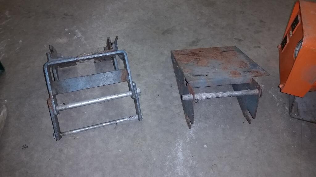

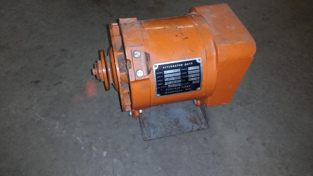

I had one that I traded to @953 nut for a seat. It came with a 520 score and I am already genny heavy so good trade. . It had a bracket that clipped to the front attach. The bracket on the right I don't know what the other bracket was for never futzed with it.  Maybe use a old snow blower attach with a mounting plate like the MN boys do with their plow weights??? A mule drive worked over and modded?
Here's another one to wrap yer head around... a front mounted air compressor! I'm sure that's been done before and maybe saw a piece of old :wh: where it was an option.
