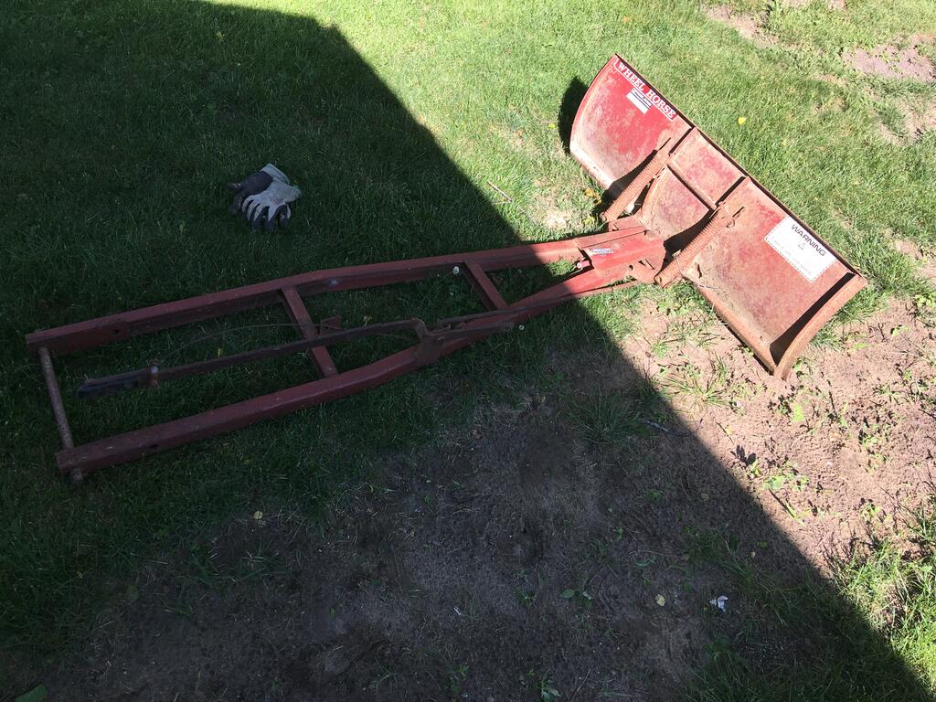

Lesterjm 2 #7 Posted June 14, 2020 Ended up passing on the 54 blade as I was afraid it’d be too heavy and just overall bigger than what I need it for. One was listed a day later that I just snagged up today. It’s a 42 inch blade and in decent shape. Still has the old local wheel horse dealer sticker from my area which was an added bonus. Picked it up for $30 so can’t complain. Need to find some rear axle mounts for the c and then off I’ll go. Have some uneven ground I need flattened up next to the garage to add another parking spot! If anyone has some spare rear mounts they’re looking to sell let me know. Thanks everyone for the help! Share this post Link to post Share on other sites
ebinmaine 80,961 #8 Posted June 14, 2020 That's an AWESOME steal!!!!! Worth $100 at the least. Mounts can be bought.... Maybe from Wheelhorse parts and more?? Share this post Link to post Share on other sites
