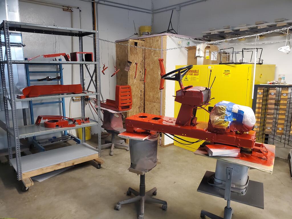

ebinmaine 80,456 #37 Posted June 5, 2020 1 minute ago, Snoop@ICI said: first horse How many do you have? We'd love to see pictures... Us 5 years old folks loves pictures... Share this post Link to post Share on other sites
Snoop@ICI 55 #38 Posted June 5, 2020 @ebinmaine Thats my 1979 B-81 I think altogether we have 6 1 2 1 Share this post Link to post Share on other sites
WHX?? 57,904 #39 Posted June 5, 2020 Interesting lookin frame ther… vertical of sorts??? 1 Share this post Link to post Share on other sites
ebinmaine 80,456 #40 Posted June 5, 2020 7 minutes ago, WHX24 said: Interesting lookin frame ther… vertical of sorts??? Yep... B8x) from 78 up is a vertical shaft tractor. 1 Share this post Link to post Share on other sites
