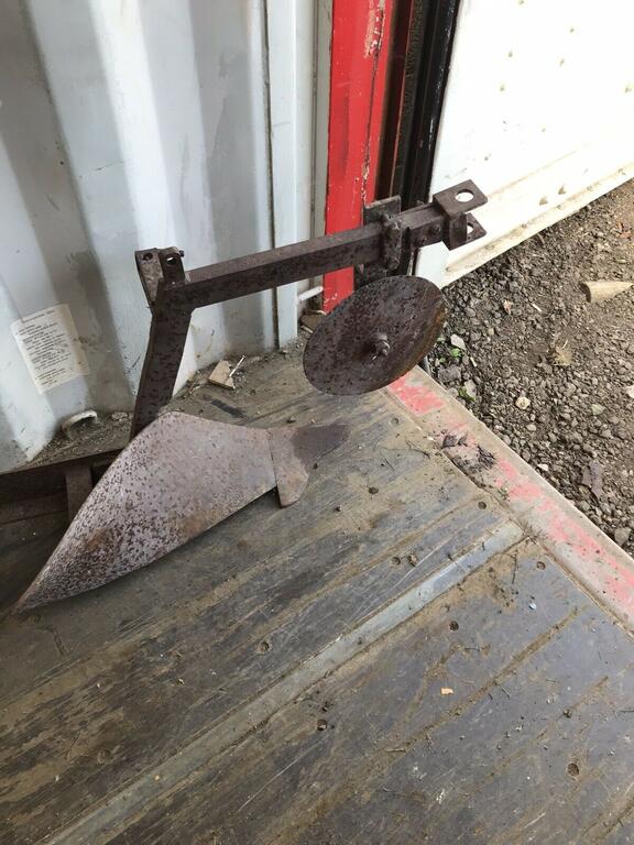

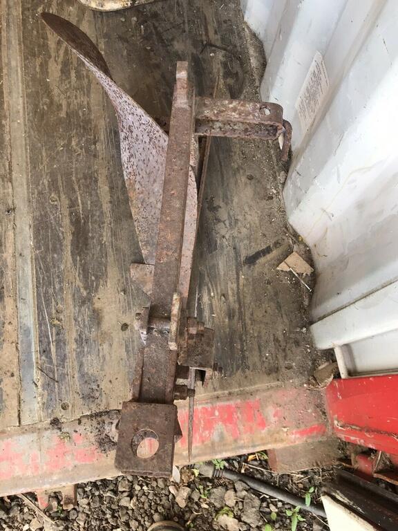

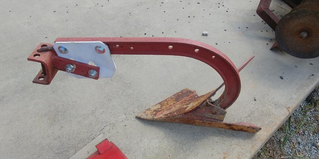

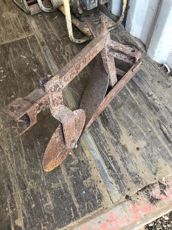

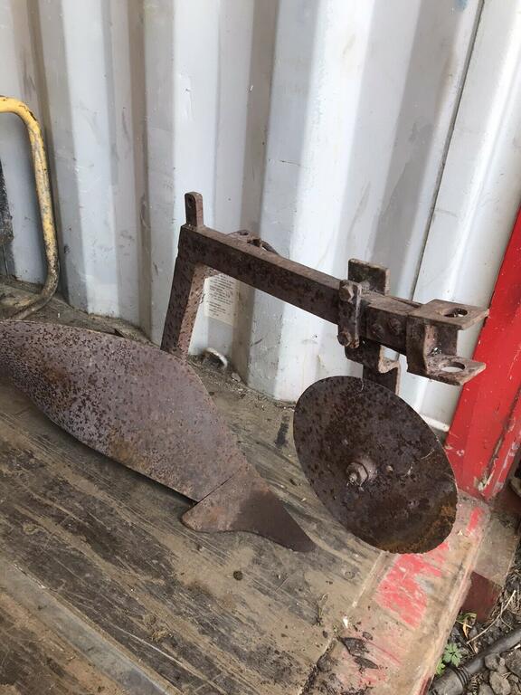

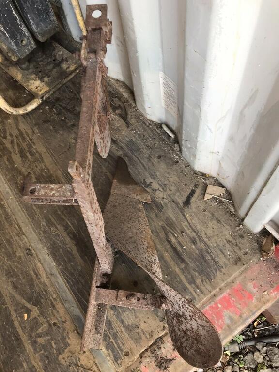

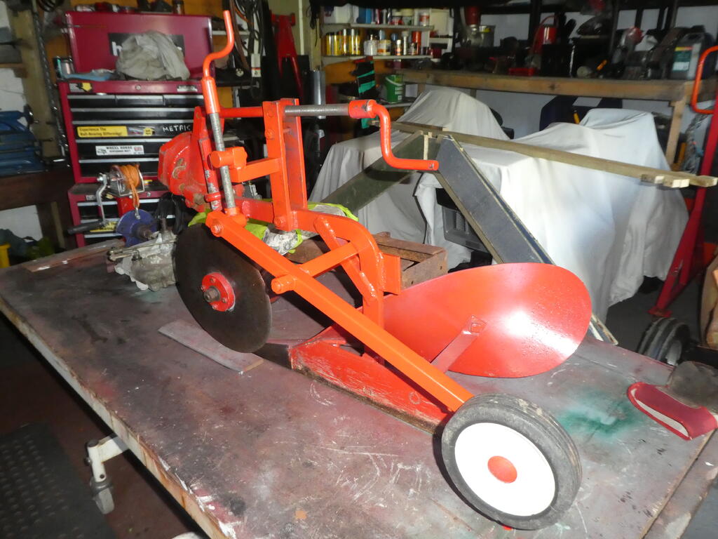

Dan.gerous 2,696 #1 Posted May 30, 2020 Just picked up a plough, would have been handy to have had it a few weeks ago - but nice to add to the collection of implements. Needs a bit of a clean up like everything else! I guess it just hooks onto the towbar, haven't got it home yet as still arranging a courier. 3 1 Share this post Link to post Share on other sites

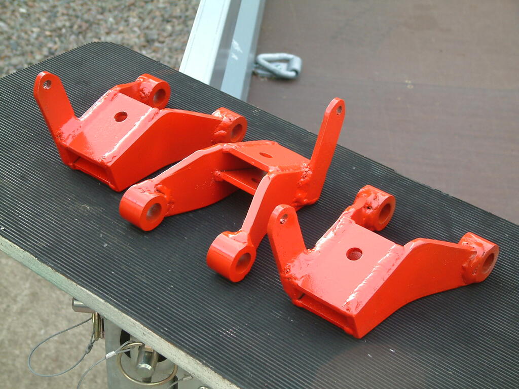

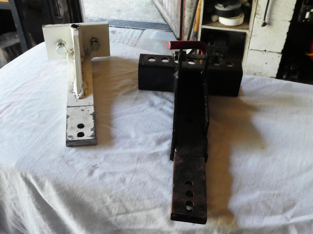

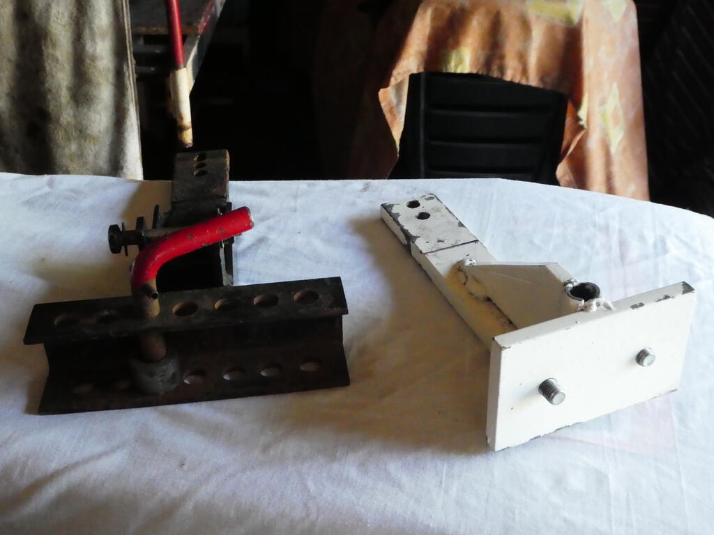

Stormin 9,988 #2 Posted May 30, 2020 Looks like one off a walk behind. Can be adapted with a bit of thought and work. You really need a slot hitch and make a tool bar. Below are some slot hitches I made. I think I have one left. I'll take a photo of the tool bar tomorrow. 6 4 1 1 Share this post Link to post Share on other sites
Dan.gerous 2,696 #3 Posted May 30, 2020 23 minutes ago, Stormin said: Looks like one off a walk behind. Can be adapted with a bit of thought and work. You really need a slot hitch and make a tool bar. Below are some slot hitches I made. I think I have one left. I'll take a photo of the tool bar tomorrow. Thanks Stormin The slot hitches look great! 1 Share this post Link to post Share on other sites

Pullstart 71,369 #5 Posted May 31, 2020 Cool stuff! It doesn’t look like there’s much adjustment in the framework though... 2 Share this post Link to post Share on other sites

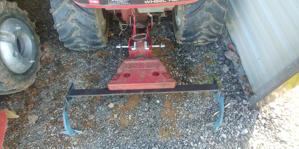

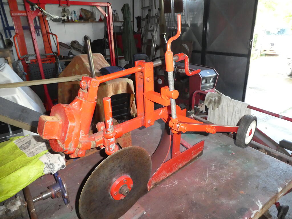

Stormin 9,988 #6 Posted May 31, 2020 Photo's as promised, Dan. May give you an idea or two. The black one I made to take my first plough, that is a modified Auto Culto walk behind plough. The white one is for my Brinly plough. Both fit a slot hitch. The plate on the white one could do with being a couple of inches wider. Plough could then be set over off centre an inch. 1 2 Share this post Link to post Share on other sites

Dan.gerous 2,696 #8 Posted May 31, 2020 37 minutes ago, Stormin said: Photo's as promised, Dan. May give you an idea or two. The black one I made to take my first plough, that is a modified Auto Culto walk behind plough. The white one is for my Brinly plough. Both fit a slot hitch. The plate on the white one could do with being a couple of inches wider. Plough could then be set over off centre an inch. Ah ok, so will need to fabricate something to get it to fit on the tractor and presumably have a degree of adjustment. Share this post Link to post Share on other sites

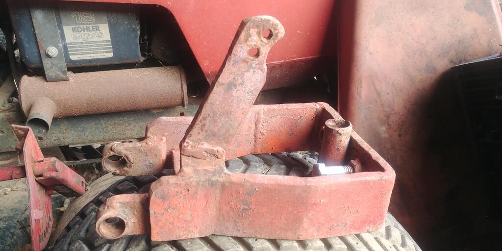

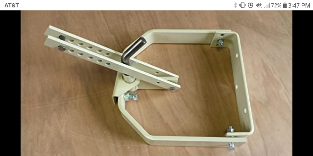

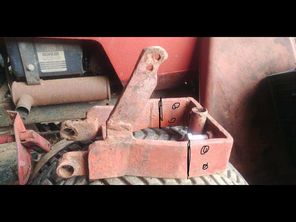

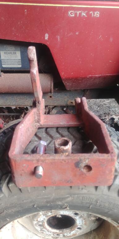

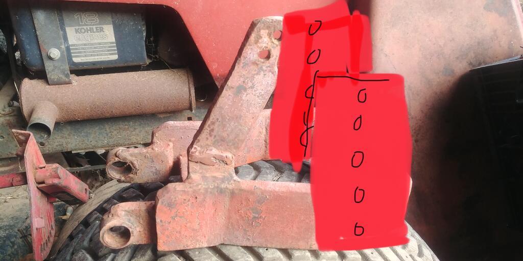

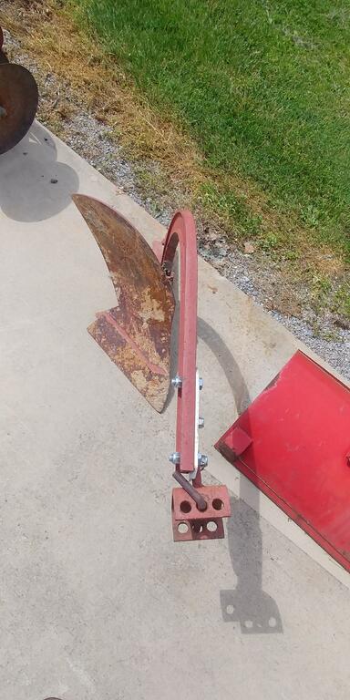

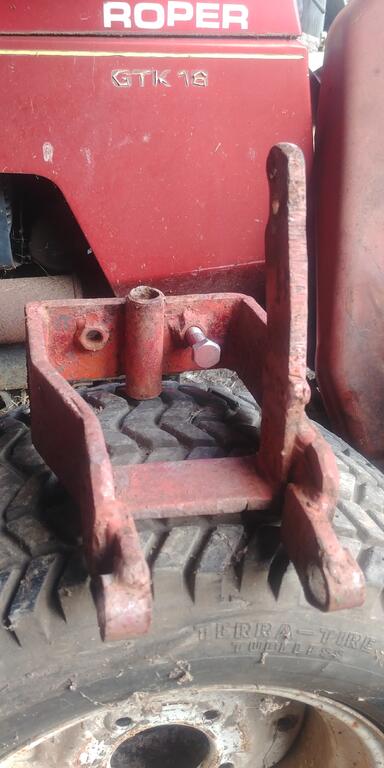

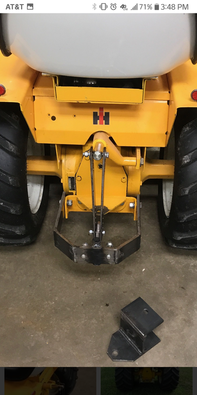

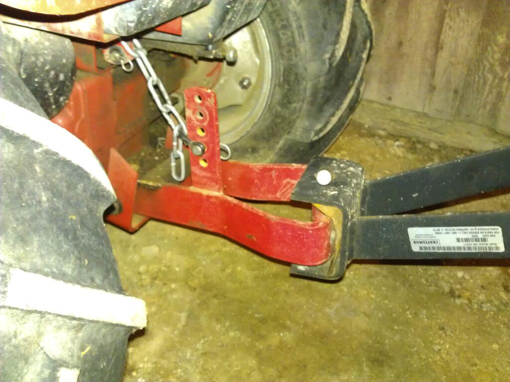

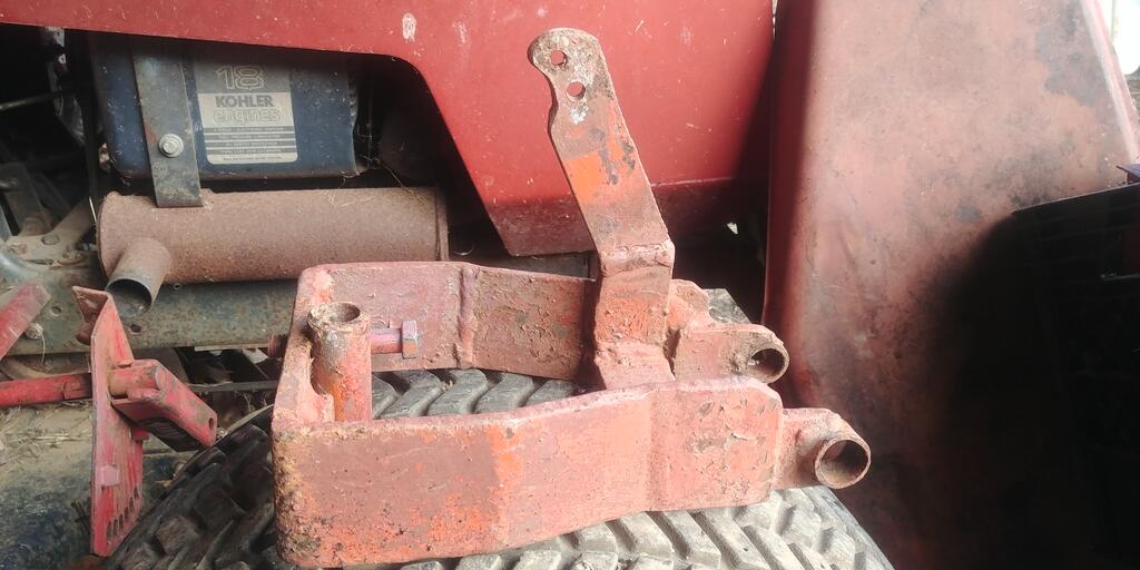

WVHillbilly520H 10,379 #9 Posted May 31, 2020 Sorry @Stormin not a slot hitch but a Brinly hitch @Dan.gerous would be a better option as well as more adjustable for lift and depth...pics 2,3,4,5 show a home built unit that I ended up with and 6&7 show the extra holes I drilled in my factory version for more adjustability... Dan as you can see it's not that hard to build one you would just need a few dimensions I can get you later the material and a welder it uses the cable/chain that lifts/lowers the tiller and it mounts the trans case by the pin for the trailer hitch. 1 1 Share this post Link to post Share on other sites
PeacemakerJack 11,072 #10 Posted May 31, 2020 @Stormin will be a great guide for you on your setup because he is so familiar with what is available in the UK and also has a great deal of experience in competitive ploughing. I will say that once you get a plough properly set up and working like it should, it is one of the most addictive implements that you can use on a GT. You will definitely need an adapter like those pictured above. The biggest challenge I see with the plow you purchased is no “suck point” adjustment. However, I’m sure that we can walk you through the process. Please be sure to look up and read through the plowing thread, it has lots of great information concerning this topic... 2 Share this post Link to post Share on other sites
Pullstart 71,369 #11 Posted May 31, 2020 I wonder if there has ever been for this purpose, a Brinly hitch mixed with a pulling hitch? Adjustable height at the tractor would mean a different suck point angle... Share this post Link to post Share on other sites

Achto 32,844 #13 Posted May 31, 2020 4 hours ago, PeacemakerJack said: The biggest challenge I see with the plow you purchased is no “suck point” adjustment. This was my thought as well. With no provided adjustment on the plow it may be difficult to dial in. 1 Share this post Link to post Share on other sites
Pullstart 71,369 #14 Posted May 31, 2020 25 minutes ago, 8ntruck said: Kev - you have the imagination, material, and the tools to come up with something like this. Can't wait to see It! something like this would likely save many minutes of head scratching and figuring I bet! being able to bolt on the back half of the hitch would allow nearly infinite adjustability. Offsetting the holes in the rear piece by 1/2” would allow the piece to be flipped for fine tuning adjustments as well. 3 Share this post Link to post Share on other sites
Stormin 9,988 #15 Posted May 31, 2020 (edited) 5 hours ago, WVHillbilly520H said: Sorry @Stormin not a slot hitch but a Brinly hitch. The white one I made is a copy of Squonks. He sent me the details. I like the clevis type in your photo's. Be lucky to find something like that over here, without someone wanting silly money. I may have a crack at making one, on day. I have a drawing and dimensions. Quote 5 hours ago, PeacemakerJack said: @Stormin will be a great guide for you on your setup because he is so familiar with what is available in the UK and also has a great deal of experience in competitive ploughing. I am? I have? I have been having a think. Do I need two ploughs? Below is the modified Auto Culto walk behind plough. That fits the black slot hitch tool bar. This would be the one to go. The land wheel arrangement could be better I used what I had and didn't want it to be to heavy. Manual lift and age. Edited May 31, 2020 by Stormin 1 3 1 Share this post Link to post Share on other sites

WVHillbilly520H 10,379 #17 Posted May 31, 2020 1 hour ago, pullstart said: something like this would likely save many minutes of head scratching and figuring I bet! being able to bolt on the back half of the hitch would allow nearly infinite adjustability. Offsetting the holes in the rear piece by 1/2” would allow the piece to be flipped for fine tuning adjustments as well. @pullstart Kevin I love my but I honestly believe the IHCC version of the Brinly sleeve/clevis hitch is the most adjustable (@PeacemakerJack do you agree?) Here check out these Kevin... No cables no chains all rigid metal linkage. @Achto, Dan the moldboard plow dad used for many decades had no adjustments except for his IHCC hitch and it worked fine... I know I know it needs polished. 4 Share this post Link to post Share on other sites

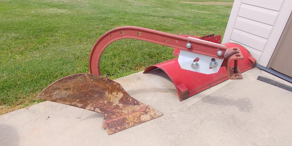

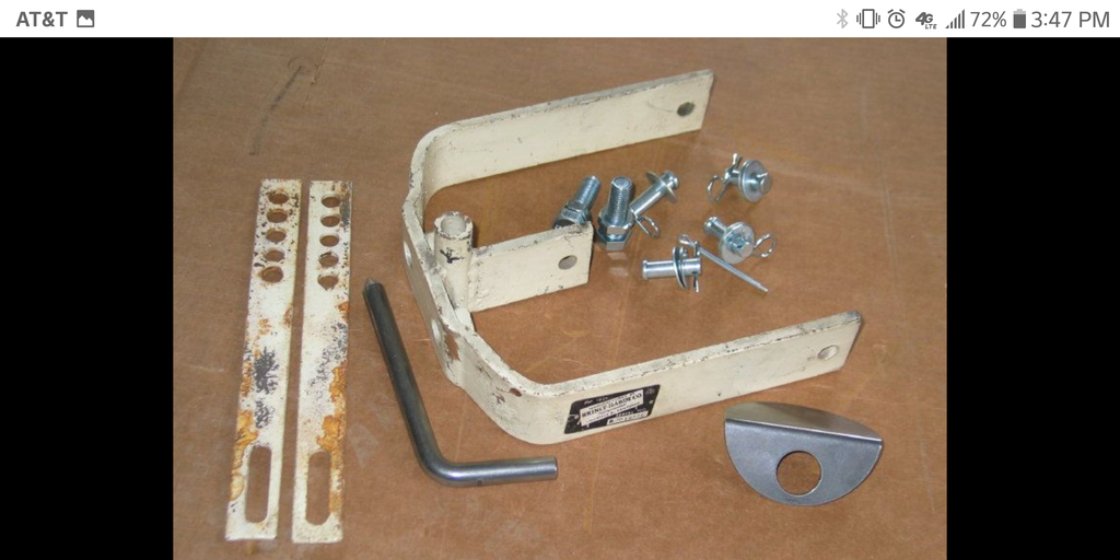

Pullstart 71,369 #19 Posted May 31, 2020 2 hours ago, WVHillbilly520H said: @pullstart Kevin I love my but I honestly believe the IHCC version of the Brinly sleeve/clevis hitch is the most adjustable (@PeacemakerJack do you agree?) Here check out these Kevin... No cables no chains all rigid metal linkage. @Achto, Dan the moldboard plow dad used for many decades had no adjustments except for his IHCC hitch and it worked fine... I know I know it needs polished. I agree, that’s a nifty left mechanism... but my thoughts are to help change the suck point angle. Since Dan’s plo(ugh) has no adjustment, hitch height might be the only way to adjust it easily. 1 Share this post Link to post Share on other sites

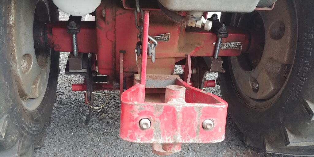

WVHillbilly520H 10,379 #20 Posted June 1, 2020 2 hours ago, pullstart said: I agree, that’s a nifty left mechanism... but my thoughts are to help change the suck point angle. Since Dan’s plo(ugh) has no adjustment, hitch height might be the only way to adjust it easily. If you notice the 2 white steel pieces with all the holes that's exactly how you change it on an IHCC, you'll also notice that 1 pair has slots that's built in "float" pic 3 showing the hitch on the tractor the top link rod it where you set the various heights... But if you look back above (post #9 last pic) on my WH hitch where I drilled the extra holes it basically does the same thing. 1 Share this post Link to post Share on other sites

Pullstart 71,369 #23 Posted June 1, 2020 9 hours ago, WVHillbilly520H said: If you notice the 2 white steel pieces with all the holes that's exactly how you change it on an IHCC, you'll also notice that 1 pair has slots that's built in "float" pic 3 showing the hitch on the tractor the top link rod it where you set the various heights... But if you look back above (post #9 last pic) on my WH hitch where I drilled the extra holes it basically does the same thing. I can see what you mean Jeff, but I don’t see the adjustment on Dan’s setup... so I was trying to think of a hitch (which he needs) that might overcome the challenge of not having adjustment 1 Share this post Link to post Share on other sites
PeacemakerJack 11,072 #24 Posted June 1, 2020 14 hours ago, WVHillbilly520H said: ...the IHCC version of the Brinly sleeve/clevis hitch is the most adjustable (@PeacemakerJack do you agree?) No cables no chains all rigid metal linkage. ...the moldboard plow dad used for many decades had no adjustments except for his IHCC hitch and it worked fine... I know I know it needs polished. 1 Share this post Link to post Share on other sites
PeacemakerJack 11,072 #25 Posted June 1, 2020 a couple of quick observations. When plowing in a basic garden which is small and generally loose soil with one tractor and plow setup, ALMOST anything will work with varying degrees of success. However, when it comes to turning a large field with multiple tractors and a variety of soil conditions, the more adjustment available—the better. I agree with you Jeff that the IH Brinly adapter allows for a lot of adjustment. Because all of my plows have a separate suck point adjustment I have not needed to use the three holes on the lower attachment plate to the tractor (I keep mine in the middle) but that would mimic a slight suck point adjustment. The variety of holes in the lift link basically create a different stop point for a hydraulic lift system. Jeff...tell us about that white plate on your dad’s plow. The way that is slotted, looks to me like that would afford some level of suck point adjustment. You definitely need to get that thing in the ground and polished up😉. I love the shape of that sod bottom, reminds me a lot of my dad’s old Bolens plow. 3 Share this post Link to post Share on other sites
