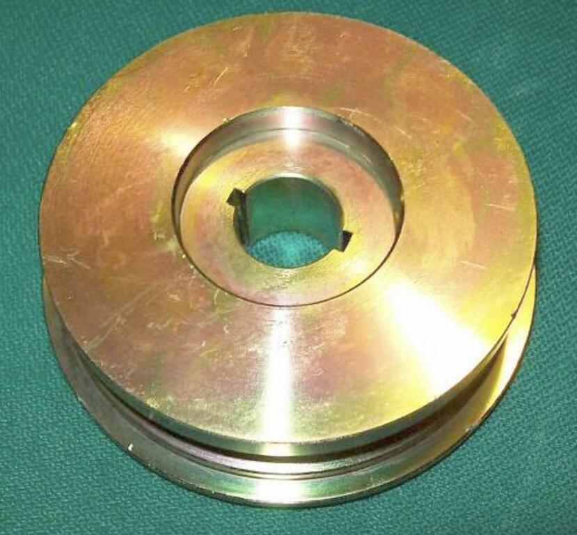

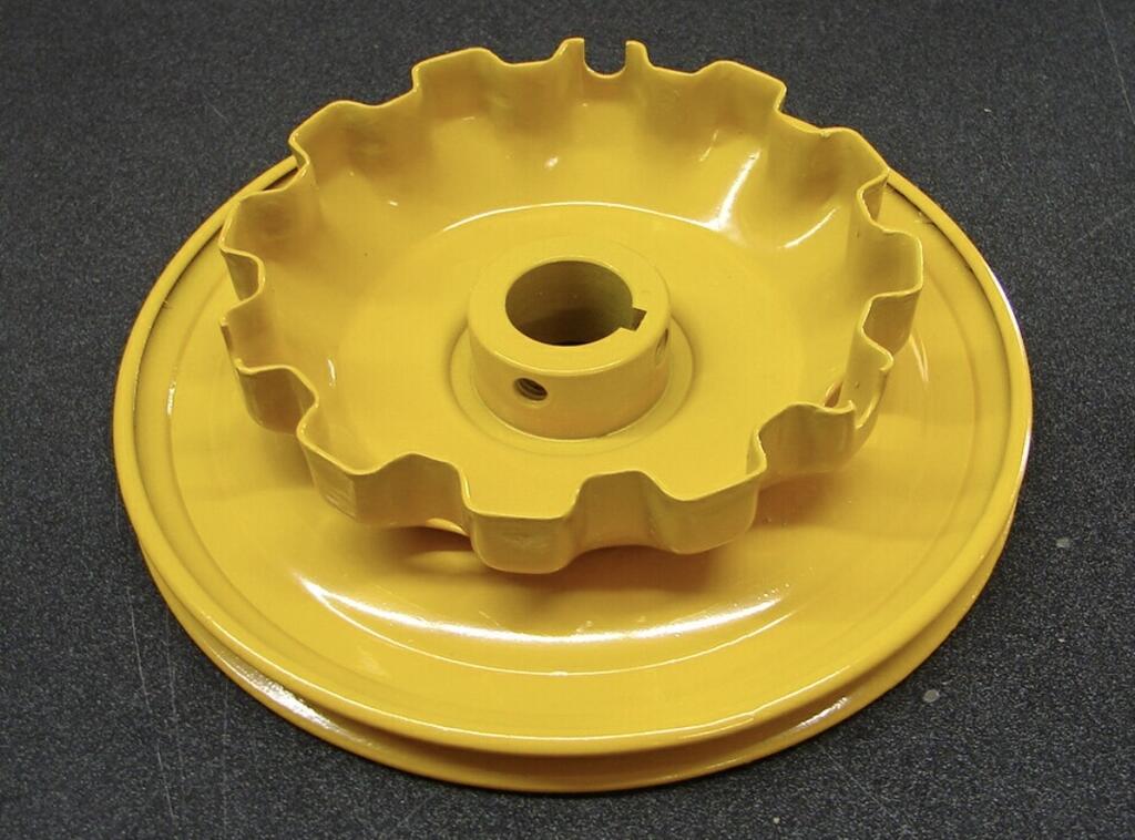

PeacemakerJack 11,005 #3 Posted May 5, 2020 (edited) Thanks for tagging me on this one Eric... The S/G for the CC’s ran a 2.5” pulley. I’ll have to measure the PTO basket pulley when I get home tonight. I’m thinking that it is about 10” in diameter Edited May 5, 2020 by PeacemakerJack 1 Share this post Link to post Share on other sites

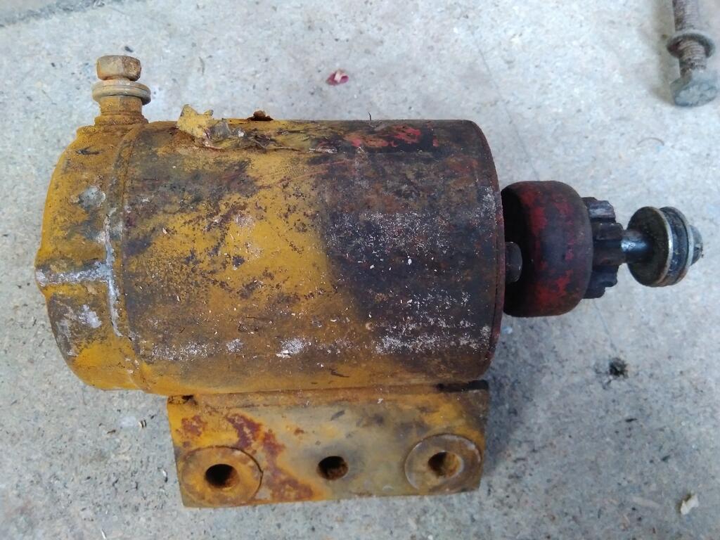

Dan.gerous 2,696 #6 Posted May 5, 2020 I have a starter, it came as some spares with the C125 I brought the other week. No idea if it would fit or even if it works. Anybody know if that would be any use? Share this post Link to post Share on other sites

Dan.gerous 2,696 #8 Posted May 5, 2020 2 minutes ago, Achto said: A C125 should have had a Bendix style starter. I believe that he is trying to fit a starter/generator. A quick way to bench test it. If it's a Bendix starter hook jumper cables from to a battery. Then negative to the body of the starter, touch the positive cable to the single wire stud on the starter. It should spin and the drive gear should slam out away from the starter. On a starter/ gen - clamp negative to the body, touch positive to the "A" terminal. The S/G should spin. Yes, unfortunately it's the Bendix type, will check if it starts in the morning, looks like it's been in water at some point. 1 Share this post Link to post Share on other sites
Achto 31,898 #9 Posted May 5, 2020 6 minutes ago, Dan.gerous said: will check if it starts in the morning, looks like it's been in water at some point. If it spins but the drive gear does not slam out, you'll need to free it up on the spiral shaft. DO NOT use any liquid lube. graphite powder is my choice to lube the shaft. Also never tap on the body of the starter, it can/will loosen the magnets inside the starter. 1 Share this post Link to post Share on other sites
Dan.gerous 2,696 #10 Posted May 5, 2020 4 minutes ago, Achto said: If it spins but the drive gear does not slam out, you'll need to free it up on the spiral shaft. DO NOT use any liquid lube. graphite powder is my choice to lube the shaft. Also never tap on the body of the starter, it can/will loosen the magnets inside the starter. Thanks for the tips 😊 will let you know how it goes, at least if anybody needs one it's there. Share this post Link to post Share on other sites
Mickwhitt 5,259 #11 Posted May 6, 2020 Hi there, I'm in south Yorkshire and have a C125. Not sure about the model you are dealing with. Certainly would be better to have electric start on your machine. I'm sure we will get a solution on Red Square. Mick Share this post Link to post Share on other sites
Dan.gerous 2,696 #12 Posted May 7, 2020 On 5/5/2020 at 7:38 PM, Dan.gerous said: Thanks for the tips 😊 will let you know how it goes, at least if anybody needs one it's there. Tried the starter out and it's dead, didn't turn over our even hint at being interested. Pretty sure it's been left outside in a bucket of water looking at the strains on it. Share this post Link to post Share on other sites
