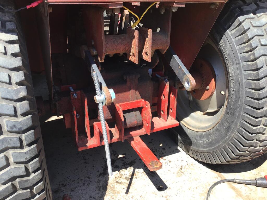

Aldon 4,834 #26 Posted April 28, 2020 15 minutes ago, pullstart said: I crawled under and see there is a longer arm on the right and a shorter double shear on the right. I imagine I’ll have to build my hitch then decide which amount of throw the plow will need to run correctly. Any input what the two options were meant for? This thing sure if beefy! Peruse my GT14 GT16 Restomod thread, Plenty of photos that should clear up most questions you may have. I think you are describing what I call the rockshaft but probably in error:-) The two shorter parallel fingers attach to the lift cylinder that lifts the deck or plow. It may be that yours never came with hydrailc lift but its more likely that over the years it was removed/plumbed out if its not there. Th longer attached to the ply if I remember correctly. 1 Share this post Link to post Share on other sites
Aldon 4,834 #27 Posted April 28, 2020 46 minutes ago, Aldon said: Some info on GT14's you should be aware of. These did have a model of rototiller that was dedicated to the GT14. It had some extra hitch stabalizing brackets and it was driven from a double rather than single pulley off the transmission input. This system looks from pictures to be rock solid. However in practice there is very limited ability to adjust the speed of the tines. And max speed isn's all that fast and It's slower going than the versions that were on the other non D series tractors. That Double pulley can be hard to locate should you decide to go that route. Also, the older deck mule system is increasing difficult to get parts for and made the deck cjhoice limited. So I mount the newer attachamatic system and use modern decks. I did manage to effectively squeeze a C195 60"deck under mine and had it work great. But I have settled on 48 inch deck as the ideal for yard mowing. If larger tracts need mowed, I might go back to 60. Snow Blower was something i never got into for these. Again, they had a dedicated mounting bracket and used an older thrower. These also had a attachment bracket that would allow you to add qty 2 Tombstone weights to the front. They had a Sickle Mower and a very elisive Post Hole digging set up that BAERPATH posted way way way back when,,,,And the Plow is larger than normal. that covers some of the unique info on GT14 that I am aware of. They also had a Front End Loader set up. Turf tires that look stock in the 15" size are not made anymore or at least to my knowledge none have come forth recently. The closest seem to be some narrower tires that are more often seen on the 954's. I went with Turf tires but they are Pricy!! Correction.....AG tires that look like those that were stock are non existent and those that seem to do the job are very narrow in comparison. Turf tires are what I went with on the Restomod. Share this post Link to post Share on other sites

Pullstart 71,564 #32 Posted April 29, 2020 1 hour ago, 953 nut said: Kevin, correct me if I am mistaken but I thought you wanted to add a Branly Clevis hitch to the GT-14. I need to add a hitch, yes. I might just end up building a 3 point brinly adapter 2 Share this post Link to post Share on other sites

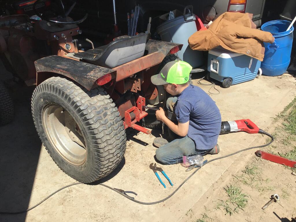

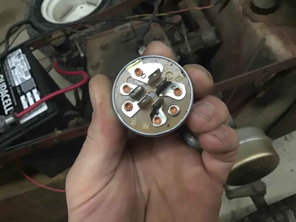

Pullstart 71,564 #38 Posted May 7, 2020 A member here made a SUPER generous DONATION and sent me a mostly complete 3 point hitch system for the cost of shipping to get these young men out in the field sooner than later. It was a huge favor that some day I’d like to repay. It arrived today, along with a magneto type ignition switch from www.iSaveTractors.com I am in the shop tonight and will see about getting the switch swapped out and tomorrow will work on the hitch system. 1 Share this post Link to post Share on other sites
Pullstart 71,564 #39 Posted May 7, 2020 @pfrederi @Super-C 4 me @fast88pu @953 nut if anyone could take a few moments and measure length between bends and maybe even approximate angles, I’d like to take a try at building a linkage bar in the next couple days! Thanks in advance! Share this post Link to post Share on other sites

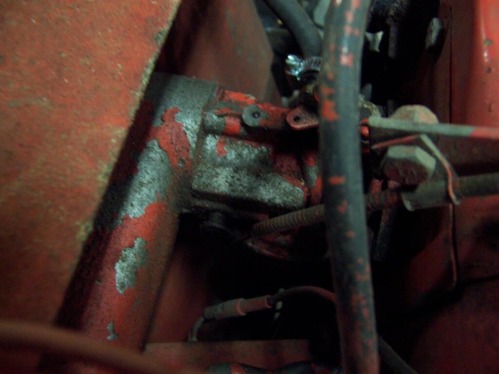

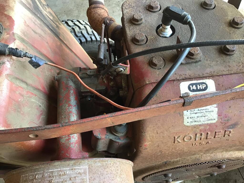

953 nut 70,662 #41 Posted May 7, 2020 Here is a picture of the choke hook up on my GT-14. 1 Share this post Link to post Share on other sites

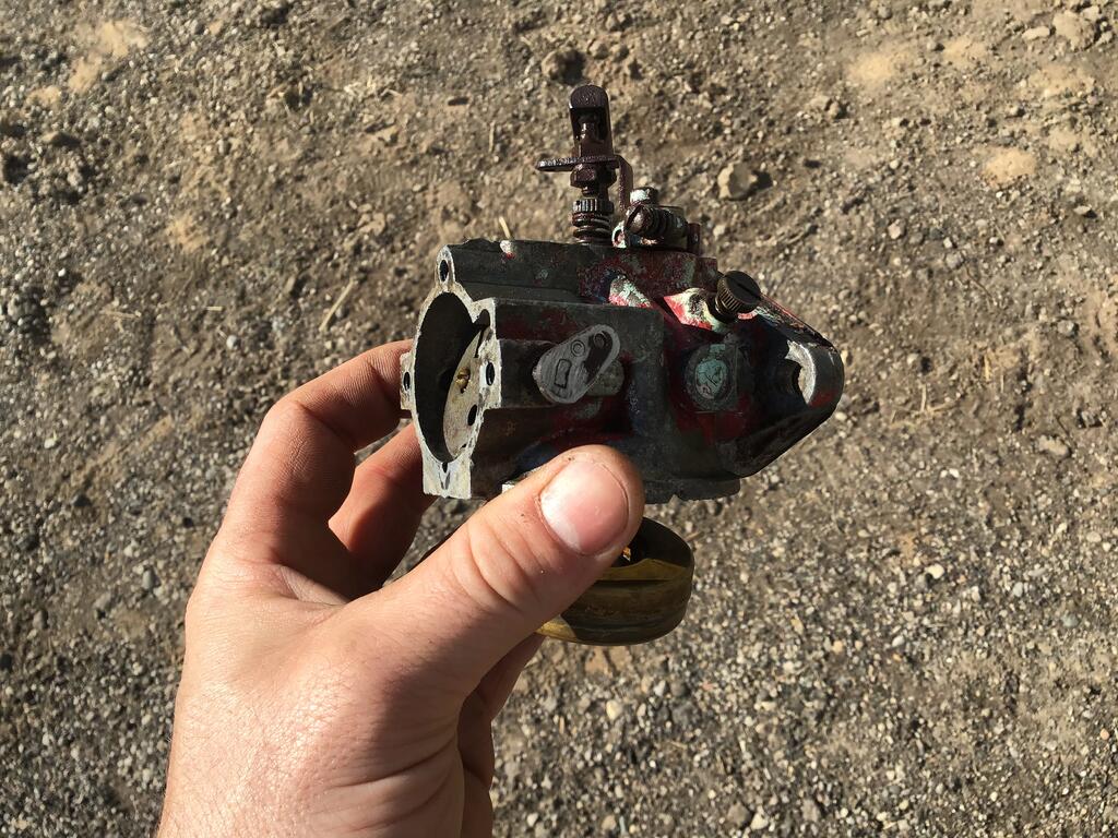

Pullstart 71,564 #42 Posted May 7, 2020 9 minutes ago, 953 nut said: Here is a picture of the choke hook up on my GT-14. so possibly the carb is wrong in a way? The arm on yours looks like it is behind and lower than the choke shaft? Share this post Link to post Share on other sites

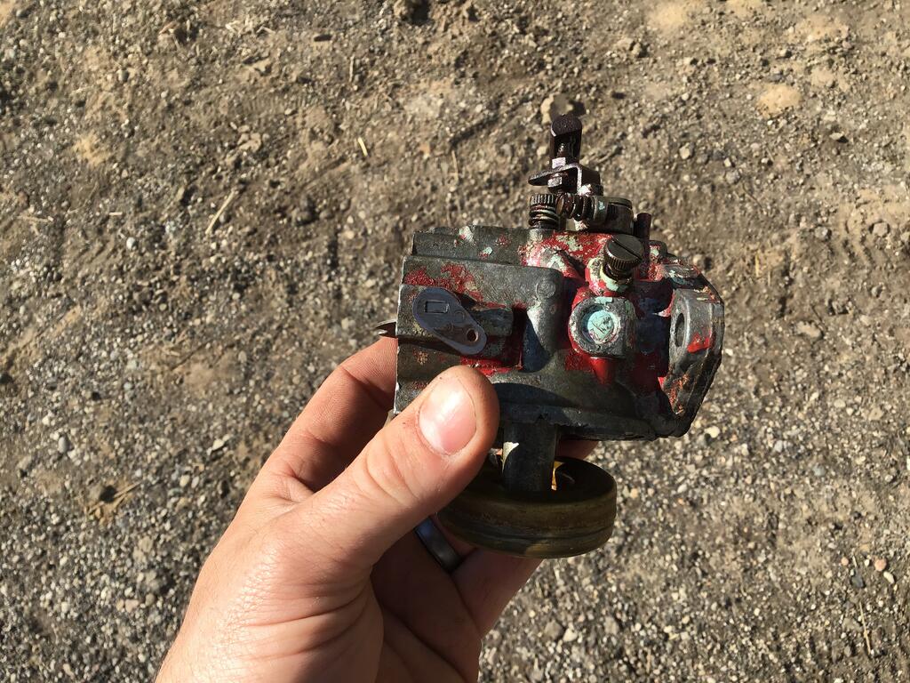

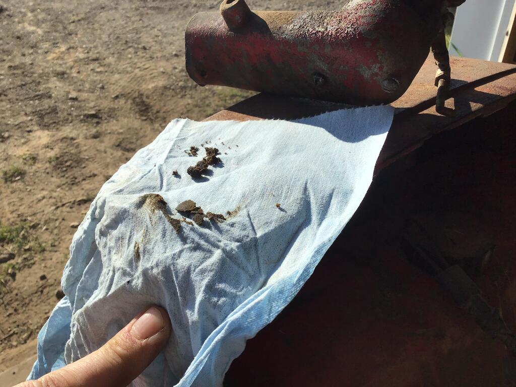

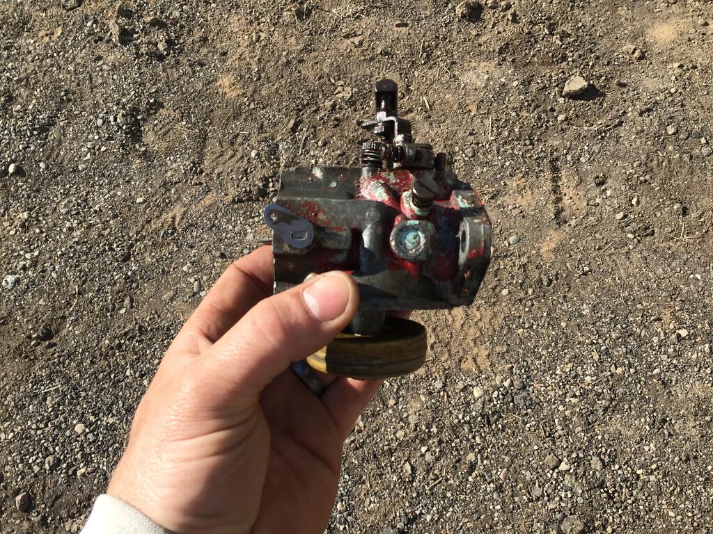

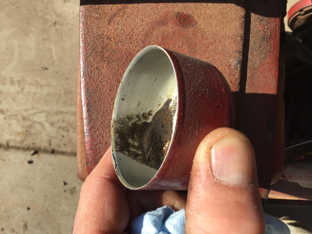

Pullstart 71,564 #44 Posted May 7, 2020 I removed the carb to play around with the choke shaft. I’m glad I did! As well as this runs, I’m surprised it runs at all! 2 Share this post Link to post Share on other sites
bottjernat1 2,197 #45 Posted May 7, 2020 Man u live in a desert? LOL 2 Share this post Link to post Share on other sites
Pullstart 71,564 #46 Posted May 7, 2020 16 minutes ago, bottjernat1 said: Man u live in a desert? LOL this came from Indiana 1 Share this post Link to post Share on other sites
bottjernat1 2,197 #47 Posted May 7, 2020 She must have came from a gravel pit. LOL Share this post Link to post Share on other sites

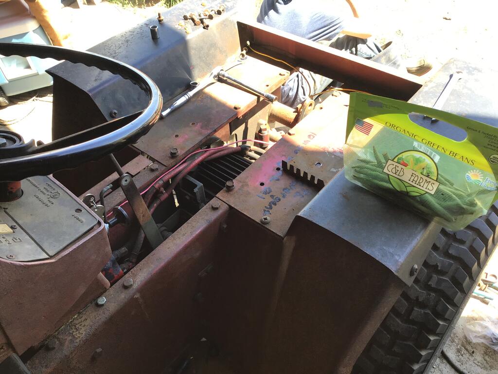

Pullstart 71,564 #48 Posted May 7, 2020 Rotating the choke arm 180 degrees will do the trick! 1 Share this post Link to post Share on other sites
Pullstart 71,564 #49 Posted May 7, 2020 The soon to be owners came over today for some shop class and to learn about their new machine. They’ve been in isolation for quite some time and we agreed that we were all healthy and safe. We’re making big progress on the whole thing! The choke cable is finished, the 3 point is as assembled as we can get it without a parts run and now there may be talk about go-karts for a bit! 2 1 2 Share this post Link to post Share on other sites

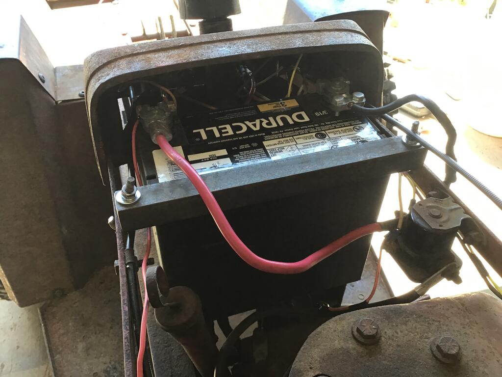

Pullstart 71,564 #50 Posted May 7, 2020 Battery hold down is finished. 2 Share this post Link to post Share on other sites
