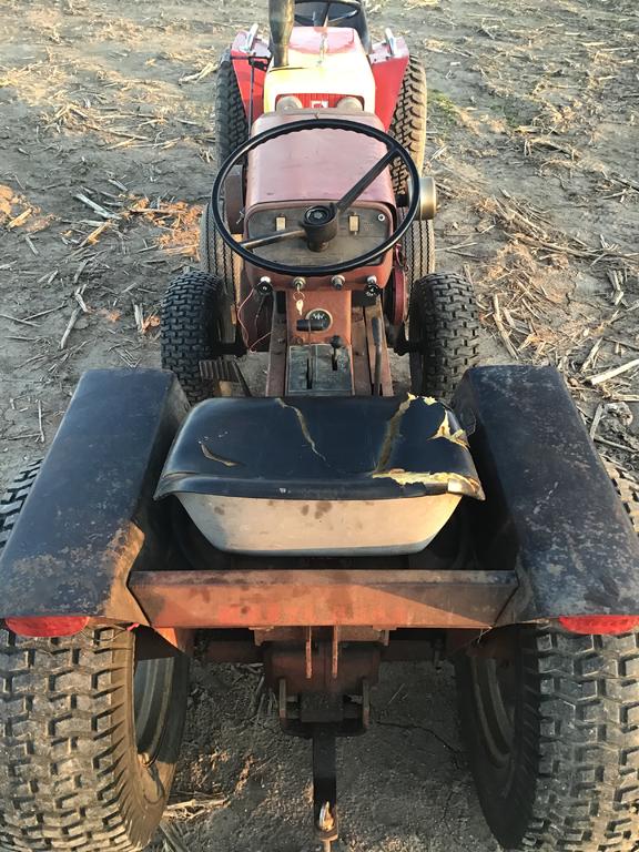

Pullstart 71,564 #1 Posted April 27, 2020 So I ran down and grabbed this tractor from IN this morning. It’s going to get a hitch for the moldboard plow that it’s future owners already purchased, some wiring cleanup and a couple little things then my buddy’s two youngest sons will be owners of this machine. I have shared “Cade’s Cows” before, the 14 year old beef farmer. His little brothers are getting this. I’m still on the lookout for something for him as well. They are pretty big Deere fans. I told them this tractor better not get painted Green and Yellow or y’all will probably shoot me! 1 6 3 Share this post Link to post Share on other sites

Pullstart 71,564 #6 Posted April 27, 2020 8 hours ago, D_Mac said: What size tires are on the back of Hot Wheels ? ‘Bout yay big. They are truck tires, I think they’re 235/75/15 maybe? 1 Share this post Link to post Share on other sites

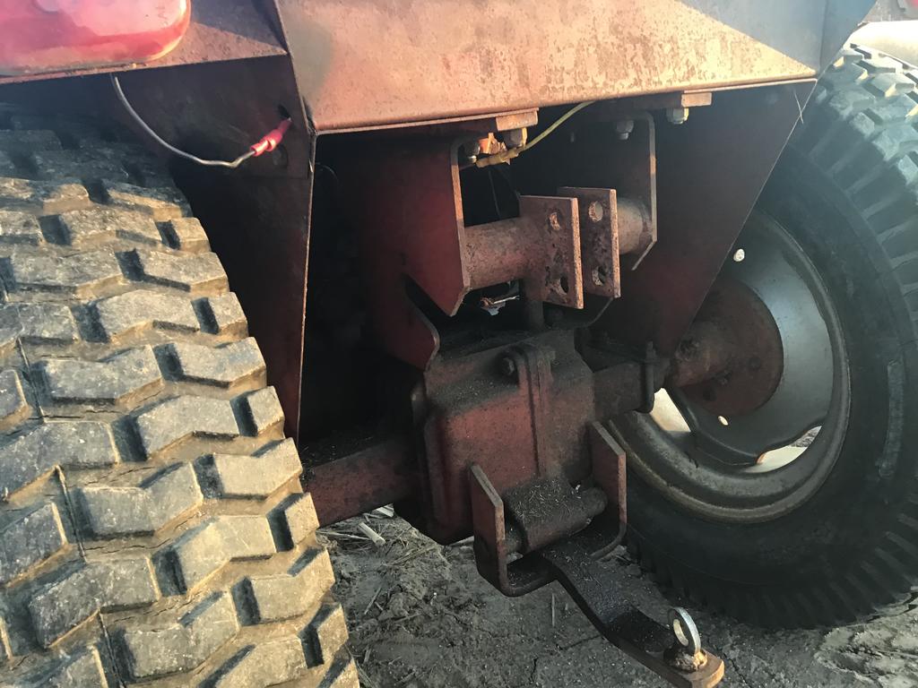

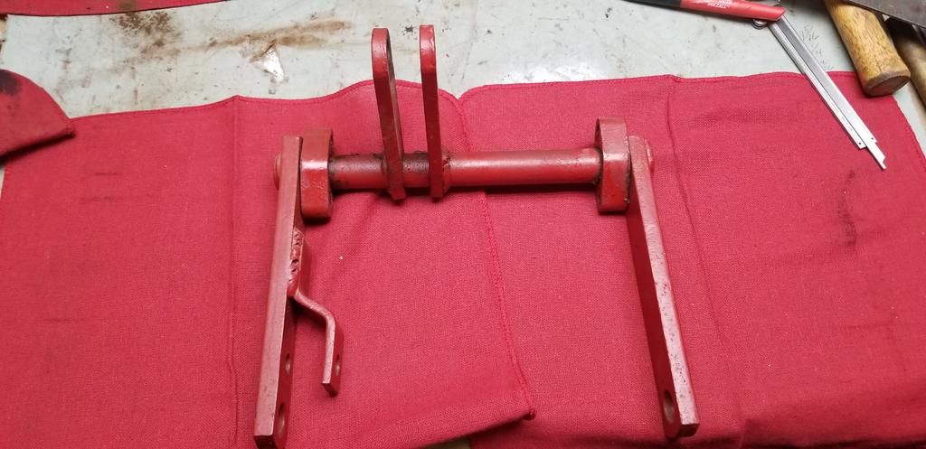

Pullstart 71,564 #7 Posted April 27, 2020 I looked through the parts list but do not see a lift cable part number here? Is there any idea of the length of cable? I think I’m going to try a solid 3/8” round bar to see if this’ll work for a lift mechanism. Share this post Link to post Share on other sites

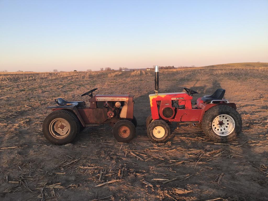

PeacemakerJack 11,096 #8 Posted April 27, 2020 I’m totally interested to see if they offered a typical WH cable lift for that particular tractor since they had the lift bar in conjunction with the Cat O for those that chose to go that route. That three point system on Blackbeard is HEAVY DUTY! I can’t wait to see what the other responses are from our big time GT-14 guys like @Aldon and @19richie66 to see what they have seen or are aware of. All i I know is that if you have to Kevin, I’m sure you’ll be able to fab something... 1 Share this post Link to post Share on other sites
Pullstart 71,564 #9 Posted April 27, 2020 @PeacemakerJack could you if you have time, post up or send me a video of the lift system on Blackbeard? I understand it’s challenging to see everything in whole, but it would be nice to see what moves the 3 point, etc. thanks! 1 Share this post Link to post Share on other sites

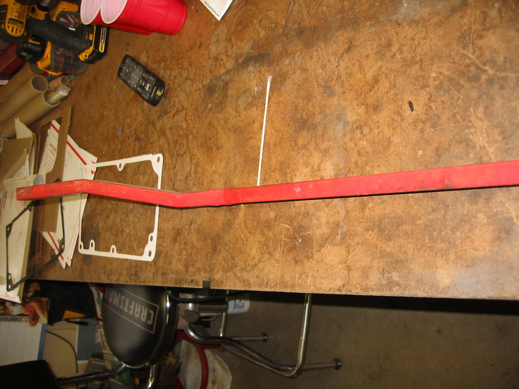

19richie66 17,951 #10 Posted April 27, 2020 No lift cable. 3/4” bar runs from the rockshaft to the back upper lift rockshaft gt14 manual independent 3 point lift  3 2 Share this post Link to post Share on other sites
Pullstart 71,564 #11 Posted April 27, 2020 Thanks Richie, now I need to look to see how that works... I imagine I can figure it out looking some more. Then to heat up some 3/4” bar stock to make one! 1 Share this post Link to post Share on other sites

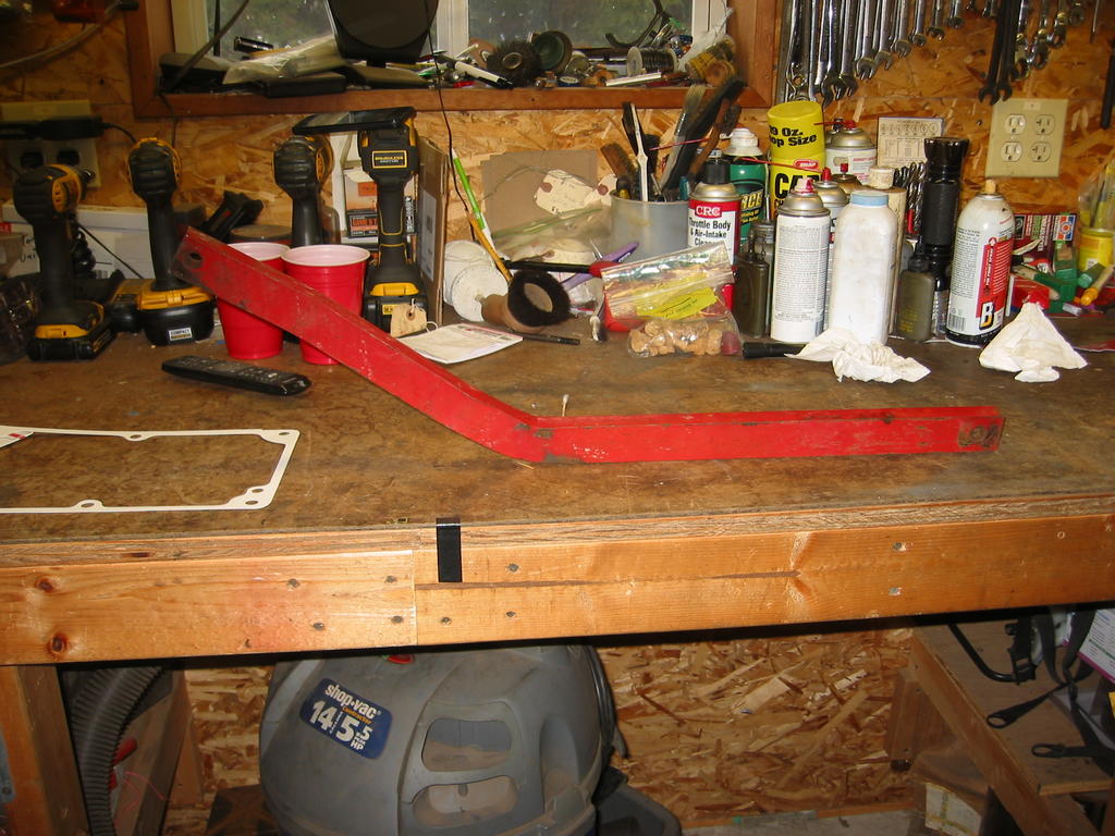

pfrederi 21,345 #15 Posted April 27, 2020 (edited) 4 hours ago, pullstart said: Thanks Richie, now I need to look to see how that works... I imagine I can figure it out looking some more. Then to heat up some 3/4” bar stock to make one! Well if you can heat and bend 3/4" x 1" stock with these odd bends i will be impressed.. GT-14 3pt actuator rod... Edited April 27, 2020 by pfrederi 1 1 1 Share this post Link to post Share on other sites

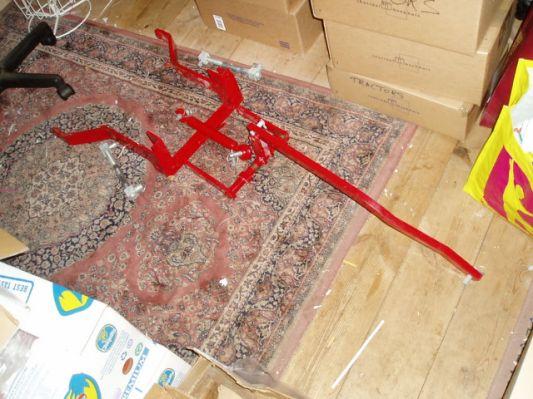

gt14rider 1,291 #16 Posted April 27, 2020 Thay make this hitch for the GT 14 , second hydraulic cylinder used for three point 1 Share this post Link to post Share on other sites

Pullstart 71,564 #18 Posted April 28, 2020 30 minutes ago, pfrederi said: Well if you can heat and bend 3/4" x 1" stock with these odd bends i will be impressed.. GT-14 3pt actuator rod... That’s busier than the illustration Richie shared! So could I clarify, these never came with a lift cable... just this? Was the hitch standard, or an add on? Share this post Link to post Share on other sites

19richie66 17,951 #20 Posted April 28, 2020 From what I’ve seen, they never came with a lift cable. The thick bar went from front to back. If you went with the independent 3 point upgrade, it added another cylinder to the rear lower bracket, a second control valve under the left seat pan sheetmetal with a control rod running to another separate lever next to your left knee. You ran a hydraulic hose from the first valve to the second valve and then plumb in the second cylinder. That attached to the upper lift arm in the back instead of the long 3/4” steel bar. Then you could lift either front or rear by itself. Not sure if the 953 cable would work as the hydraulic pump and motor would probably be in the way whereas the 953/1054 has really nothing in the way of the cable routing. 3 1 Share this post Link to post Share on other sites

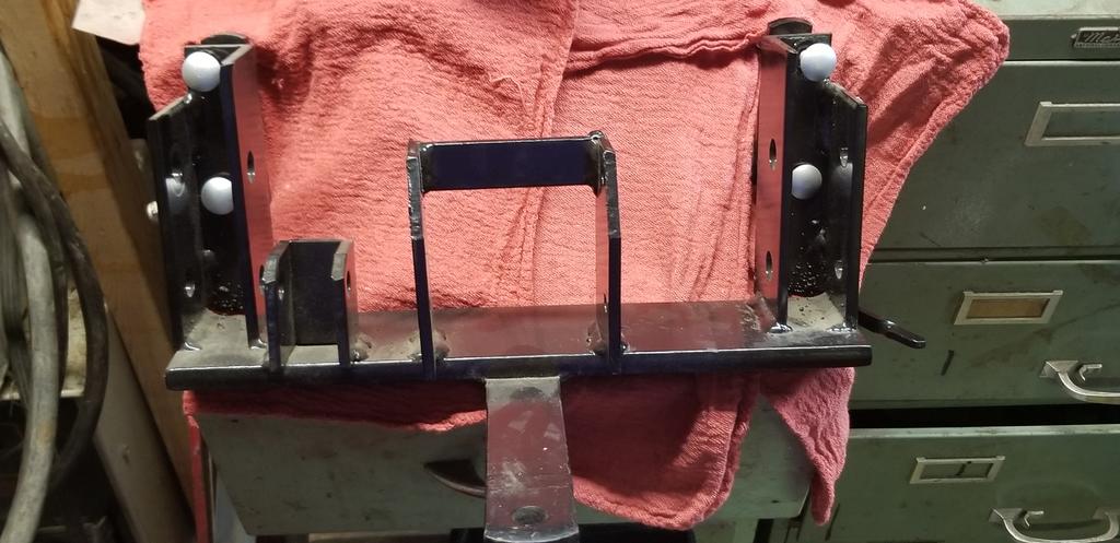

Super-C 4 me 612 #21 Posted April 28, 2020 (edited) Kevin, I have a new repro GT14 3 point hitch. I was planning on using it, but it's just been sitting there. And its a second setup. Just thought I'd throw it out there. Let me know if your interested. Edited April 28, 2020 by Super-C 4 me 3 1 Share this post Link to post Share on other sites

Aldon 4,834 #23 Posted April 28, 2020 I have only seen the tractor come with hydraulic lift. I have seen that with two different cylinder set ups. 1) Shared single cylinder. If you wish to put downward pressure on the snow plow, it will also lower the three point in rear. 2) dedicated second cylinder off the rear bracketry. When using a second cylinder, the valve is mounted under the left fender and it allows independent control. I haven't seen it but I assume the system could be plumbed to add the second cylinder to a single control valve but that is beyond my hydraulic knowledge.... 1 Share this post Link to post Share on other sites
Pullstart 71,564 #24 Posted April 28, 2020 I crawled under and see there is a longer arm on the right and a shorter double shear on the right. I imagine I’ll have to build my hitch then decide which amount of throw the plow will need to run correctly. Any input what the two options were meant for? This thing sure if beefy! Share this post Link to post Share on other sites
