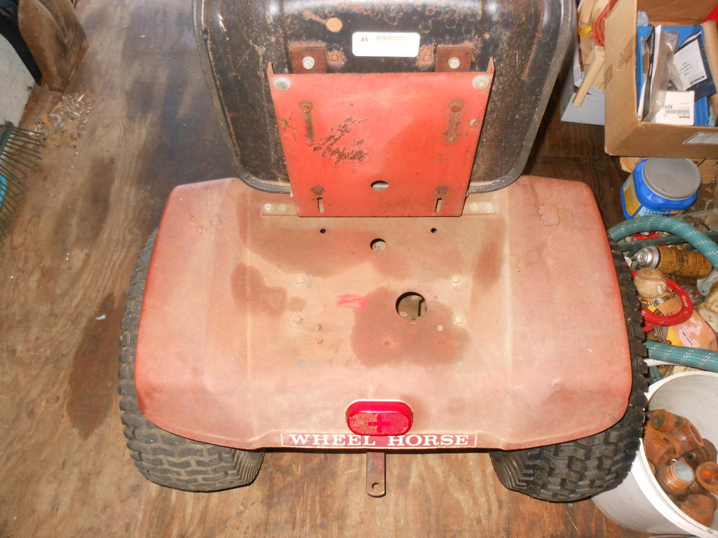

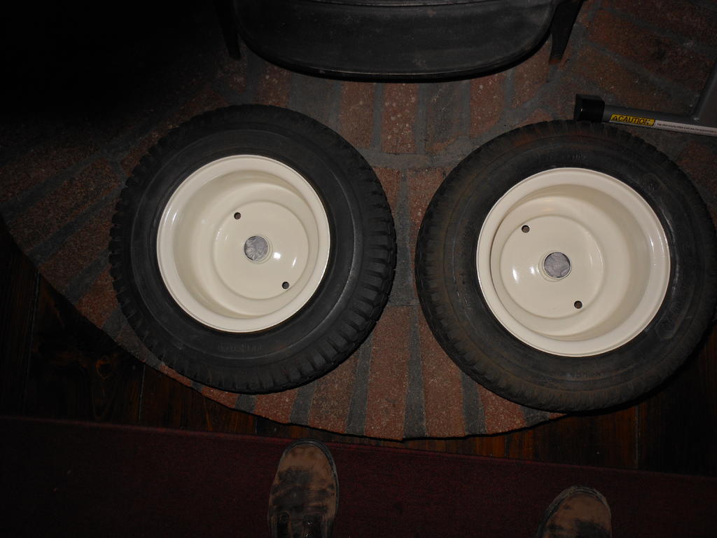

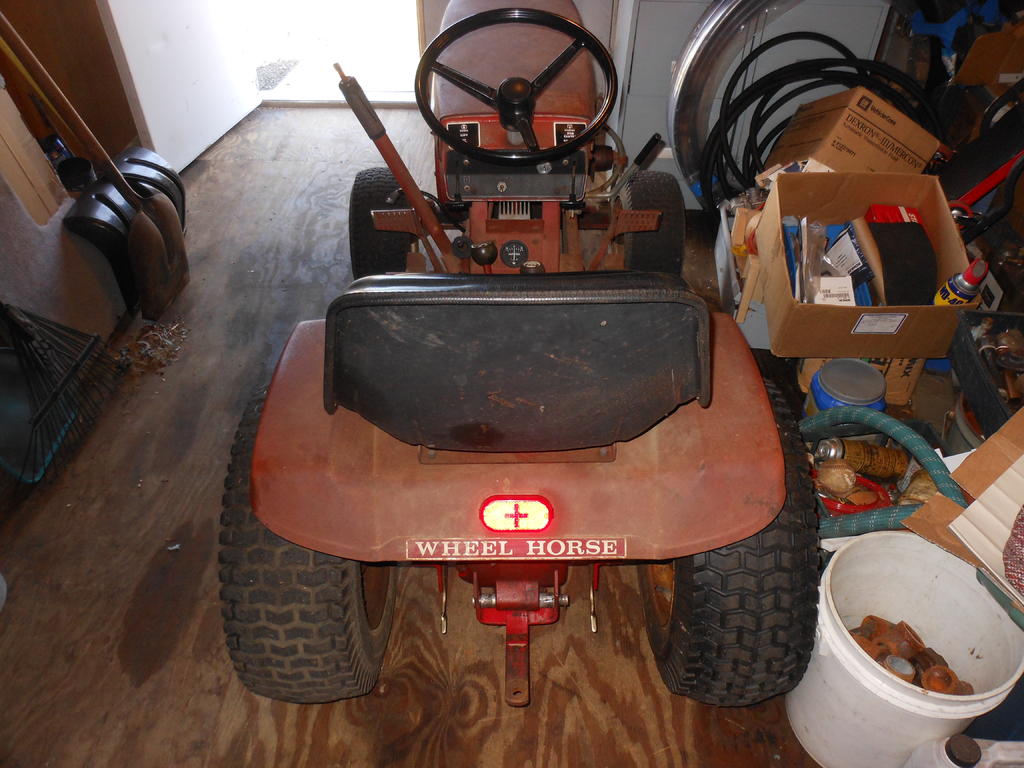

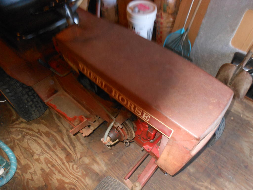

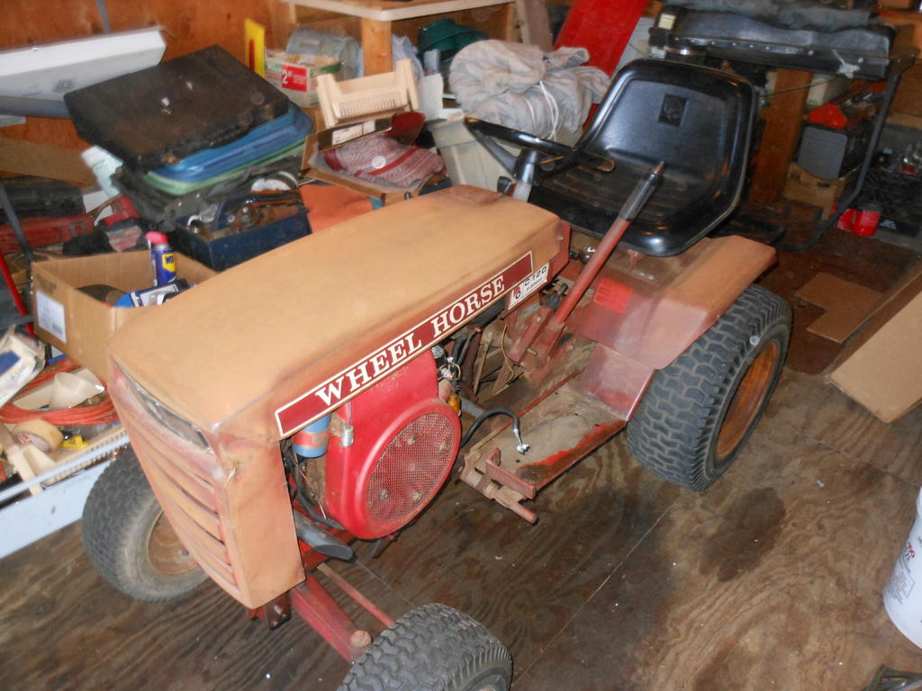

JCM 11,415 #1 Posted April 16, 2020 @PeacemakerJack & @pullstart about your comments about the finish on the 1977 C-120 in Two fer Tuesday, I guess I stumbled on Multiple threads on here about this topic and if I remember correctly I used Simple Green Cleaner with a Grout sponge several times then dried the surface and used a Scotch Brite Pad , cleaned off the residue and applied several coats of WD 40 sprayed on a cotton cloth, pretty simple thanks to some tips on here. I have included some before and after photos that you may have seen on earlier posts. I was really amazed at how it turned out and being my first C - Series I now consider it one of my favorites. Also after seeing that finish it convinced me that I needed to paint the wheels as well. Thanks for your interest. 3 10 Share this post Link to post Share on other sites

8ntruck 9,278 #3 Posted April 16, 2020 Did you dilute the Simple Green? I've used full strength Simple Green to strip paint on Lionel train cars before refinishing. Granted, it is different kind of paint in a different application, but, the paint came off. Share this post Link to post Share on other sites
JCM 11,415 #4 Posted April 16, 2020 @8ntruck Did not really dilute the Simple Green just used the sponge wet and kept ringing it out to keep it clean and damp. Share this post Link to post Share on other sites

8ntruck 9,278 #7 Posted April 16, 2020 10 hours ago, JCM said: @8ntruck Did not really dilute the Simple Green just used the sponge wet and kept ringing it out to keep it clean and damp. Come to think about it, using Simple Green as a paint remover involves using it full strength as a soaking agent for a day or two. 1 Share this post Link to post Share on other sites
