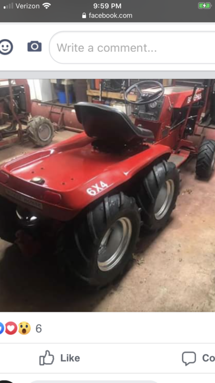

JaysHorse 288 #1 Posted April 13, 2020 So I was thinking about taking my 416-8 and adding a second rear axle and having a dual axle setup and taking an old dump cart box and mounting that as well to have almost something like a dump truck. My question is has anyone ever done such a thing and if so do you have any pics and pulley/belt setups. not sure if I want to hunt down another transmission or rob the one out of my 417-8 Thanks in advance. Share this post Link to post Share on other sites

JaysHorse 288 #4 Posted April 13, 2020 @pullstart that is really nice looking. What’s your plans for the belt setup? I too kicked around the idea of stretching it. I saw this and thought how cool..... 3 1 Share this post Link to post Share on other sites

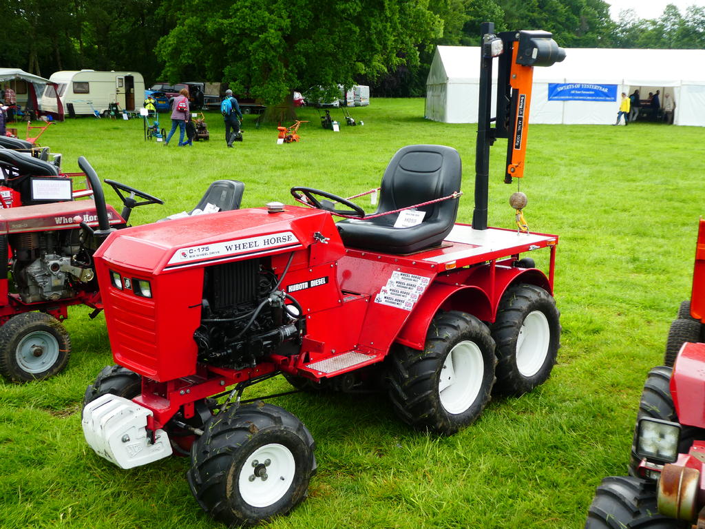

Stormin 9,988 #5 Posted April 13, 2020 Take a look here.https://myoldmachine.com/topic/1177-project-c1-4x6/ You should find it of interest. 1 2 1 Share this post Link to post Share on other sites

Pullstart 71,482 #11 Posted April 14, 2020 @Stormin I just read through all 17 pages of over the pond banter... but in 2016 it seems to have stopped? Is there a finish? Share this post Link to post Share on other sites
Pullstart 71,482 #12 Posted April 14, 2020 I searched through his YouTube page and found these videos. So cool! 2 1 Share this post Link to post Share on other sites
ebinmaine 81,048 #13 Posted April 14, 2020 3 hours ago, pullstart said: I searched through his YouTube page and found these videos. So cool! Thanks for finding/posting those. Awesome stuff... Share this post Link to post Share on other sites
Stormin 9,988 #14 Posted April 14, 2020 Yep! That's James. It's some machine. Had a bit added now. 1 Share this post Link to post Share on other sites
