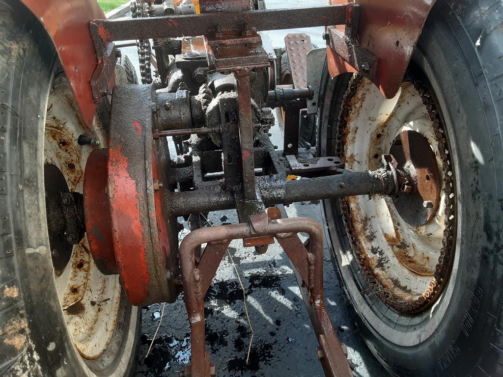

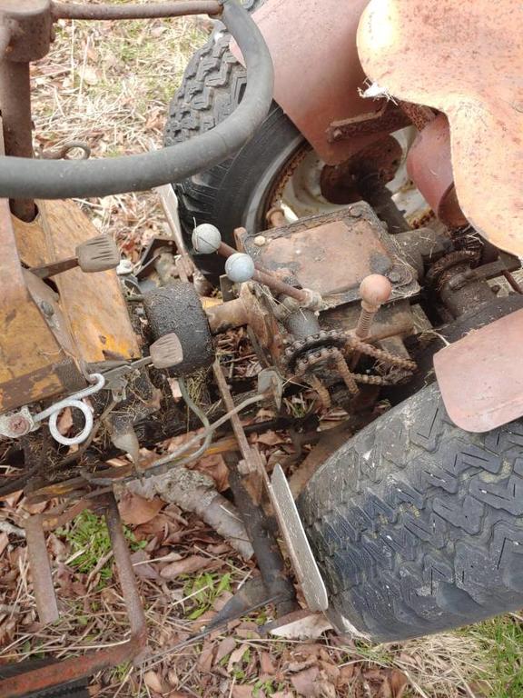

D_Mac 9,339 #51 Posted April 13, 2020 That sprocket on the bottom moves when you pull the handle on the left side. It moves but dosnt lock in place and dosnt appear to do anything. I didnt look at the wagon to carefully. I dont think they are C-clamps it seems very solid but I will have a closer look. We are supposed to be having 70mph winds today so I may not get a chance to do anything to it today since my garage isnt that big so I work outdoors. The chain on the rear wheel has no purpose as far as I could tell either. 3 Share this post Link to post Share on other sites

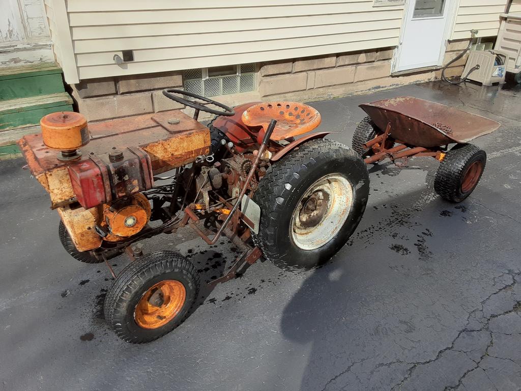

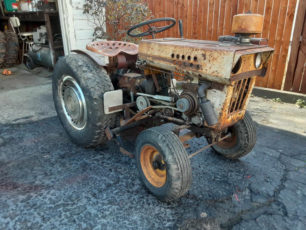

Tractorhead 9,218 #52 Posted April 13, 2020 First just Whow, who ever build that Tractor, set a lot of Brainstorming ahead. I see a several marks and adjustable items, that will become a Interesting Project. This Tractor ain‘t for the dump, in it‘s own Way it is a Beauty like a Steam Punk Art. What it make worth, to fix. Maybe it is a Challenge, but you just can Win a lot of knowledge on the Way until it‘s beeing Working again. Because there is no electrical crap on it, it is easy to fix, just a lot to Screw. With the help and guidance from the Redsquare crowd knowledge, you can bring it back in Service again, i‘m sure. 1 Share this post Link to post Share on other sites

WHNJ701 4,173 #56 Posted April 13, 2020 (edited) 21 hours ago, D_Mac said: Says I only used about 50% of my attachment quota but wont let me load anymore pics. Hmmm there it goes < shrug > Looks pretty safe huh ? How can you possibly get hurt riding this? Better get a tetanus shot. Could the hood be off a Gibson? It does say something under the gas tank. You can read... LAWN then the tank blocks the rest but an R at the end. Lawn Tractor maybe I dont know. what's the chain on the inside of the rim? the trailer looks like a front axle and rims off a case/ingersoll Edited April 13, 2020 by jabelman Share this post Link to post Share on other sites

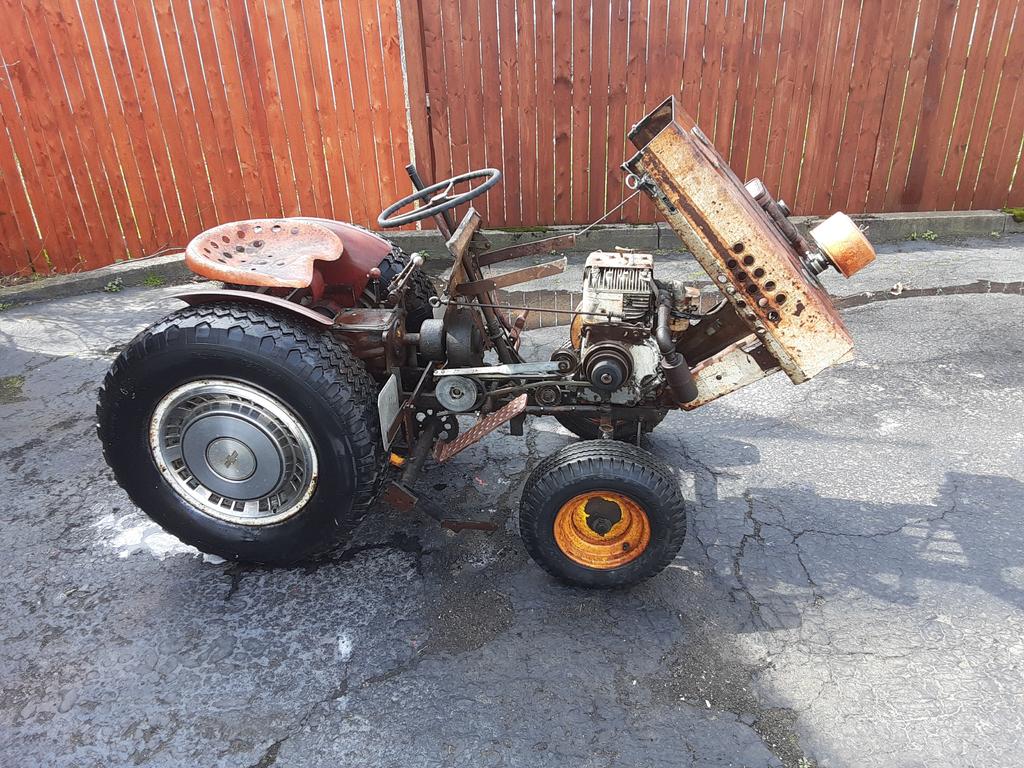

D_Mac 9,339 #57 Posted April 13, 2020 (edited) Yeah I have no idea what that chain is for. On this tractor it does nothing. So yes after messing with the carb and freeing up the cables I got it to run. Now the scary part is getting it to drive. I want to lift the rear end and put it on a couple of jack stands but I dont have either. I am not sure about any shift pattern and there dosnt seem to be any brakes on the thing. The red lever does nothing. Need some help on the other two. I havent tried moving either one just yet. What would your educated guesses be as to what each of them might do? I dont want to lock it up in gear and not be able to roll it. Been there done that before. I am also disappointed that my headlight dosnt work ! Edited April 13, 2020 by D_Mac 2 Share this post Link to post Share on other sites

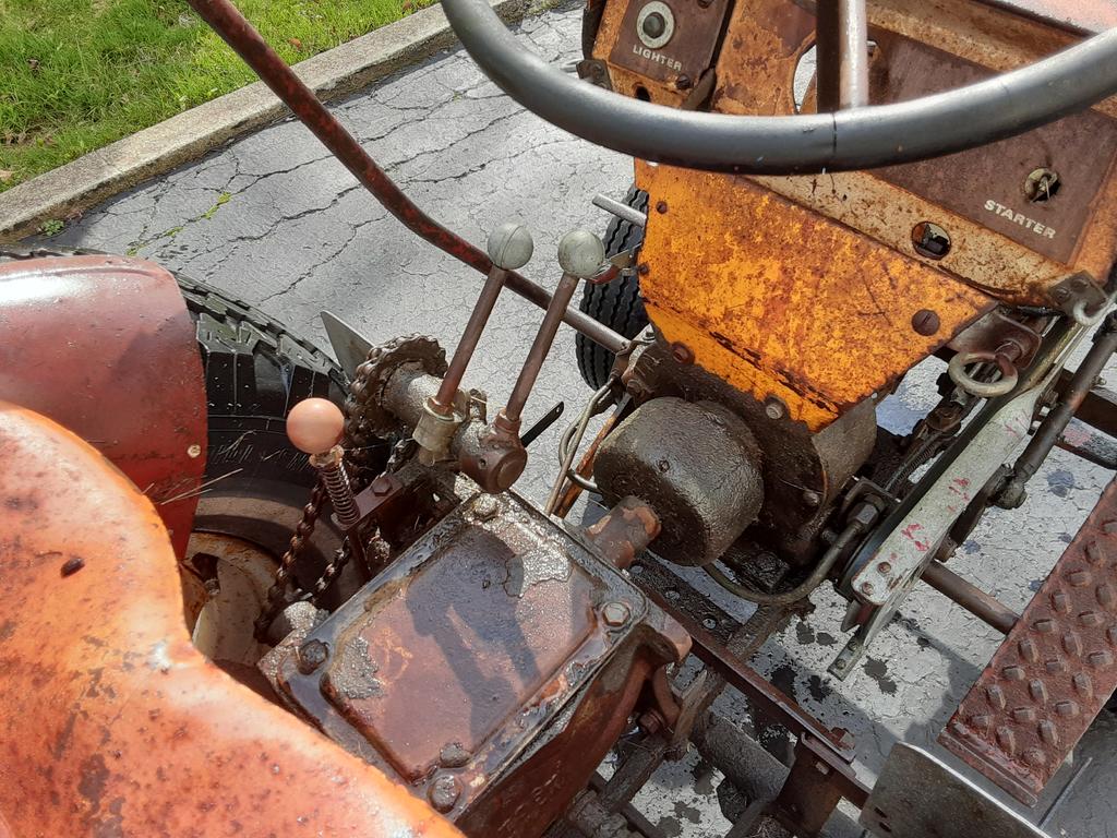

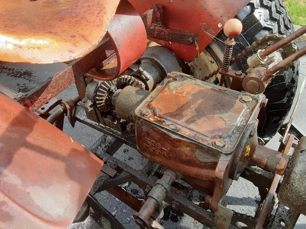

SylvanLakeWH 32,733 #58 Posted April 13, 2020 Just a guess but I'm thinking forward and reverse? They seem to control two separate shafts exiting the transmission, with the pulleys providing the power from the other side... Share this post Link to post Share on other sites
diesel cowboy 263 #59 Posted April 13, 2020 Four bolts and you can pull the cover off the top of the trans and see what happens inside when you move the levers without having to worry about it running away while its running and less of a chance getting it stuck in 2 gears too 1 Share this post Link to post Share on other sites

D_Mac 9,339 #61 Posted April 14, 2020 Well, much progress on the project today. I figured out it does have brakes but the brake cable was broken. So I replaced the cable. Next I got the rear end up off the ground and tried to figure out the gear box. Got that figured out . Smaller lever to the outside is push it forward 1st gear, pull it back reverse. Inside taller lever, push it forward 3rd gear, pull it back 2nd. Next was... you guessed it..... jump on and see if it goes...... SUCCESS !!!! I cant believe its moving under its own power. Saved from the scrap yard !! I wish I had means to improve it further but I am happy I got it this far. I am going back to the gentleman I got it from. He also offered me a roller and a plow frame with a blade on it. I believe the plow fits this tractor. If it dosnt I am going to cut off those brackets someone welded on the tractor. Kind of hard to get on and off it with them on. Also there is no place to put your left foot when your on it. 2 2 4 Share this post Link to post Share on other sites

D_Mac 9,339 #65 Posted April 14, 2020 Thank you ... but I had many doubts. See if I cant find a couple of headlights for it. I never have good luck getting those to work. Comes to electrical work I am clueless. Whats every ones opinion on the rear tires? Leave the ones that are on it ? With or without the hub caps? Tractor tires ? Share this post Link to post Share on other sites
Tractorhead 9,218 #66 Posted April 14, 2020 (edited) Some fellas here changed the Bulbversion of their horses with LED versions in round, that could maybe fit to your Tractor. i dunno if this Engine have a lightcoil or a chargercoil either. how much wires go from the Engine to Dash? is there a unfunctional switch? That could be the light Switch. If there is one cable from the Engine, get a Volt meter and check if there can be measured someting to groung. Btw, i vote for the actual tyres for the moment. Edited April 14, 2020 by Tractorhead 1 1 Share this post Link to post Share on other sites
SylvanLakeWH 32,733 #67 Posted April 14, 2020 I like the tires that are on it, looks cool, but depends on what you're going to use it for - actual work or a show-stopping beauty queen? 2 Share this post Link to post Share on other sites

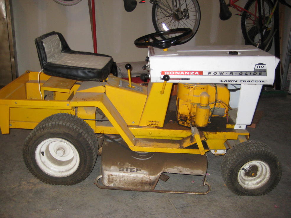

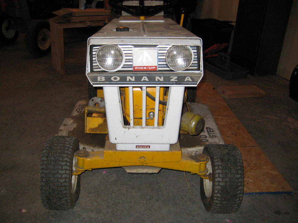

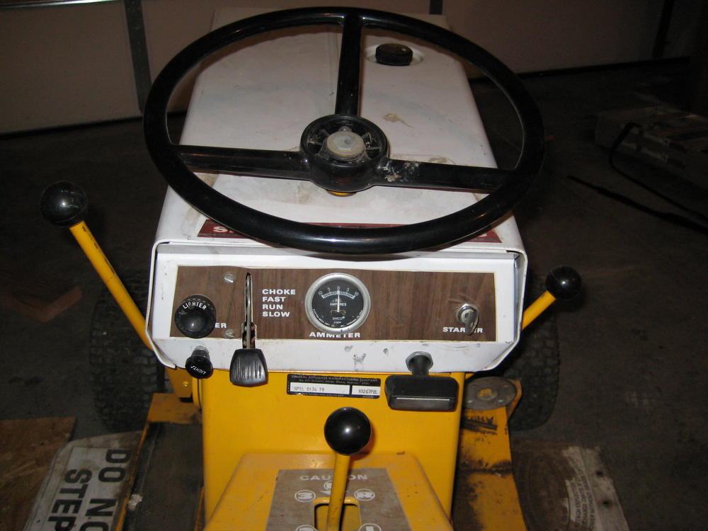

D_Mac 9,339 #71 Posted April 14, 2020 On 4/12/2020 at 10:13 PM, diesel cowboy said: With the new pictures I'm pretty sure the hood came off a Bonanza lawn tractor and the frame and rear is almost definitely Speedex. Can't help on the trans as I've never dealt with any of those other than the T-92. If it was mine I'd get the thing running and enjoy using it, it looks cool and unique @diesel cowboy had it right on the money. The hood is off a BONANZA lawn tractor. Same as mine but this hood lacks the round vent holes that mine has. Otherwise same grill and dash. Mine they moved the steering through the dash and not the top of the hood. Notice the pull cord through the dash. Speedex rear end and frame. Great eye Cowboy ! 2 2 Share this post Link to post Share on other sites
