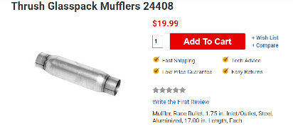

RJR49 179 #11 Posted March 23, 2020 I tried the double muffin idea years ago on a C-100. Didn't do a thing. The only reason the Thrush worked on my Fathers Fiat was that the Thrush was designed for a big American V8. The motor in the Fiat was about the same size as the K341 in my C-160. Unfortunately, it would never fit under the hood. My fear about using it as a stack is the weight. Apparently, you guys don't share my concern so maybe I'll give it a try. Eric's comment about the air vs water cooled engine, and my past experience with the dinghy suggest that I'll still need the Mickey Mouse ears. 1 Share this post Link to post Share on other sites
RJR49 179 #12 Posted March 23, 2020 6 minutes ago, pullstart said: My Cherry Bomb is quite quiet... I welded a baffle in the end from a 2006 Honda Shadow Spirit 750 RS won't let me attach or paste a picture of the Cherry Bomb glass-packs but there are quite a few. https://cherrybomb.com/project/glasspack/ Which one do you have? Also I can't picture the baffle. If you have a picture of it I would like to see it. Share this post Link to post Share on other sites
Pullstart 71,333 #13 Posted March 23, 2020 5 minutes ago, RJR49 said: RS won't let me attach or paste a picture of the Cherry Bomb glass-packs but there are quite a few. https://cherrybomb.com/project/glasspack/ Which one do you have? Also I can't picture the baffle. If you have a picture of it I would like to see it. Becoming a supporting member will take care of your uploading issue. Considering how much this forum helps us all save money on our repairs, it’s the least we can do to say thanks! i will work on getting a good image of the baffle inside the end. The day I bought my Honda, I hole sawed the baffles out of the stock pipes. Loud pipes save lives 2 Share this post Link to post Share on other sites
RJR49 179 #14 Posted March 23, 2020 Becoming a supporting member will take care of your uploading issue. Considering how much this forum helps us all save money on our repairs, it’s the least we can do to say thanks! It never occurred to me that the advertisers weren't covering the costs. Ill do it but RS doesn't make it easy to find out how. I searched for quite a while before i found the right page. A button on the home page would be nice 1 Share this post Link to post Share on other sites
SylvanLakeWH 32,619 #15 Posted March 23, 2020 8 minutes ago, RJR49 said: Becoming a supporting member will take care of your uploading issue. Considering how much this forum helps us all save money on our repairs, it’s the least we can do to say thanks! It never occurred to me that the advertisers weren't covering the costs. Ill do it but RS doesn't make it easy to find out how. I searched for quite a while before i found the right page. A button on the home page would be nice For future reference - "Store (Support RS)" button at the top of the every page - just click on it and it goes right to the options. I have found the site to be worth it. I share your interest in a quieter ride so I appreciate this thread! 4 Share this post Link to post Share on other sites
WVHillbilly520H 10,379 #16 Posted March 23, 2020 7 hours ago, pullstart said: My Cherry Bomb is quite quiet... I welded a baffle in the end from a 2006 Honda Shadow Spirit 750 A true "Cherry Bomb" is not made by Walker... https://www.thrushexhaust.com/mufflers/thrush-glasspack-muffler ... VS ... https://cherrybomb.com/project/glasspack/ ... @RJR49 What you may really want for muffling is this ... http://www.jegs.com/i/Jones-Exhaust/523/AR3012S/10002/-1 ... Or ... https://www.gopowersports.com/rlv-4100-1-exhaust-silencer-muffler-with-hd-ss-clamp/ ... Or ... https://www.ebay.com/itm/173959416431 ... Or lastly make your own with the help of these ... https://www.ebay.com/itm/323374246169. Share this post Link to post Share on other sites

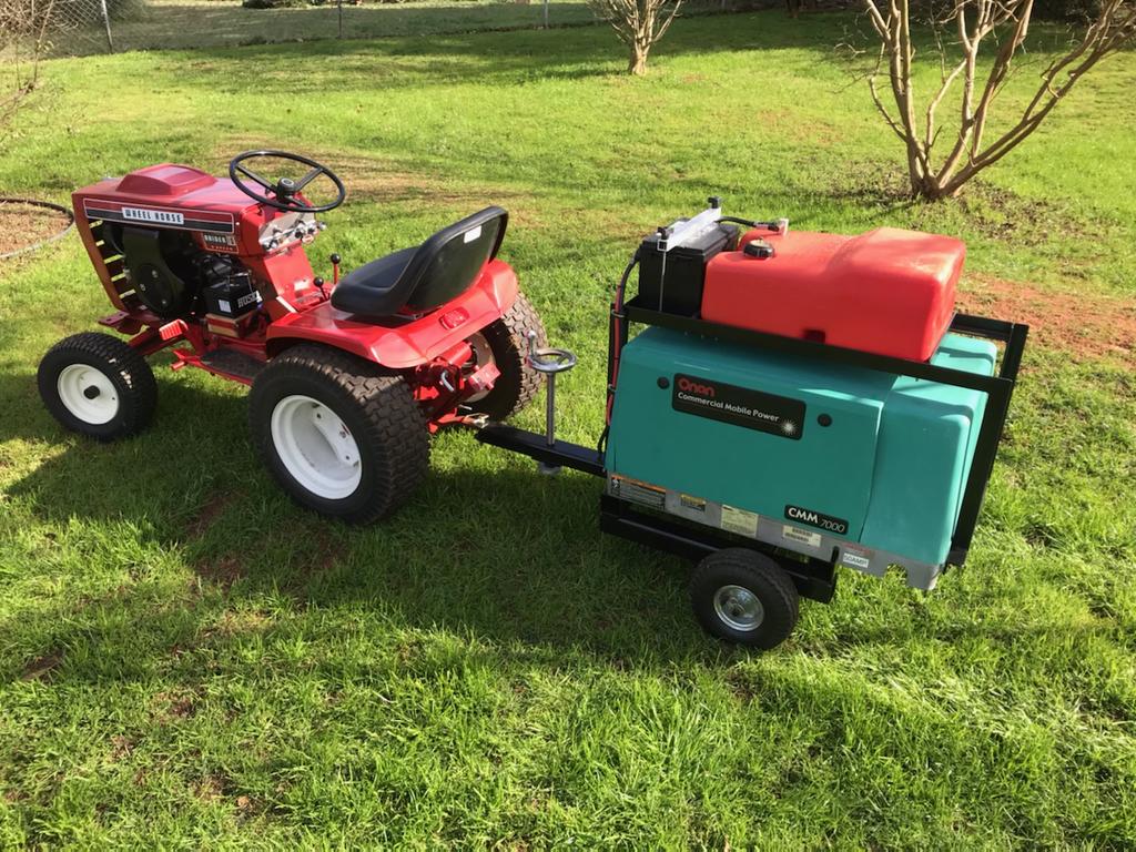

McGrew 461 #18 Posted March 24, 2020 I second (third?) the idea of looking into generator mufflers. I acquired a Cummins/Onan generator out of an RV some time back, and built a trailer for it so I could use it to power my home during outages, It is powered by an Onan V-twin, They don’t advertise horsepower, but it is around 650cc, so I assume it is in the 14-16 HP range. That generator is amazingly quiet! I find it funny tractor guys like to hear our engines run, but campers using the same power plant want quiet... Danny 1 Share this post Link to post Share on other sites
ebinmaine 80,776 #19 Posted March 24, 2020 2 minutes ago, McGrew said: I second (third?) the idea of looking into generator mufflers. I acquired a Cummins/Onan generator out of an RV some time back, and built a trailer for it so I could use it to power my home during outages, It is powered by an Onan V-twin, They don’t advertise horsepower, but it is around 650cc, so I assume it is in the 14-16 HP range. That generator is amazingly quiet! I find it funny tractor guys like to hear our engines run, but campers using the same power plant want quiet... Danny Danny do you know if that generator is encased in anything or has vibration dampeners, different block, anything like that? Share this post Link to post Share on other sites
lynnmor 9,042 #20 Posted March 24, 2020 1 hour ago, ebinmaine said: Danny do you know if that generator is encased in anything or has vibration dampeners, different block, anything like that? You are focusing on the right thing. We all want to alter exhaust systems for more, less or different noise. Much of the sound from an open air cooled engine comes from the engine block. Small quiet generators have the engine enclosed and air venting is controlled both in and out. 1 Share this post Link to post Share on other sites

WVHillbilly520H 10,379 #23 Posted March 24, 2020 1 hour ago, lynnmor said: You are focusing on the right thing. We all want to alter exhaust systems for more, less or different noise. Much of the sound from an open air cooled engine comes from the engine block. Small quiet generators have the engine enclosed and air venting is controlled both in and out. Wide frame "Quiet Line" Cub Cadets, JD, Xi series ect all have encased engines and are quieter as well as having some sort of isolated engine mounts. 1 Share this post Link to post Share on other sites
McGrew 461 #24 Posted March 24, 2020 Eric, The generator is isolated from the frame by springs and rubber cushions, all factory. Plus it is in a fiberglass enclosure that has sound mat inside. Again, all factory. It also has a rather large for the engine size, muffler. When I first fired it up, I could not believe how quiet it was. Special engine block? I have no idea... All I did was to build a cart for it, and add a fuel tank and battery. Lynnmor hit on something as well. The air intake and discharge are both on the bottom. I had to be careful building the cart to not restrict it. Here is a picture: 2 Share this post Link to post Share on other sites
ebinmaine 80,776 #25 Posted March 24, 2020 1 hour ago, McGrew said: Eric, The generator is isolated from the frame by springs and rubber cushions, all factory. Plus it is in a fiberglass enclosure that has sound mat inside. Again, all factory. It also has a rather large for the engine size, muffler. When I first fired it up, I could not believe how quiet it was. Special engine block? I have no idea... All I did was to build a cart for it, and add a fuel tank and battery. Lynnmor hit on something as well. The air intake and discharge are both on the bottom. I had to be careful building the cart to not restrict it. Here is a picture: So the rubber cushions and the housing would certainly explain the quiet factor there. Nice job on that little trailer. Share this post Link to post Share on other sites
