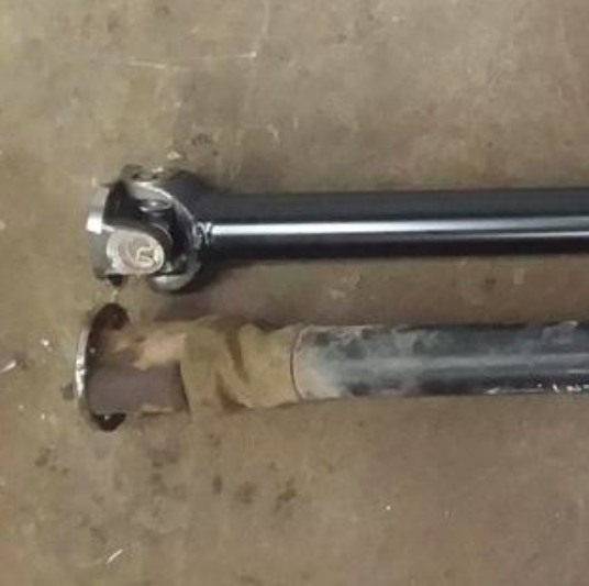

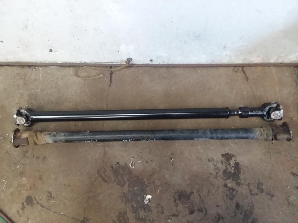

Cvans 1,009 #103 Posted April 4, 2020 Unfortunately one of the parts that arrived today for the differential was wrong and I'm going to try and find another spider gear. After comparing the one that I thought was good with a new one it's apparent that it is badly worn. On a good note the new drive shaft was finished so I drove to Sioux Falls and picked it up. In this photo you can see the new and old shafts together. 6 Share this post Link to post Share on other sites
bc.gold 3,406 #104 Posted April 4, 2020 (edited) Now that is a really neat universal joint, reminds me of an old 1946 Dodge Power Wagon that used large ball bearings sandwiched between the hub side the the driven axle side - sorta like a constant velocity joint. Edited April 4, 2020 by bcgold 1 Share this post Link to post Share on other sites

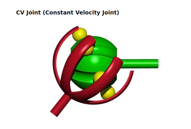

Pullstart 71,020 #105 Posted April 4, 2020 9 hours ago, bcgold said: Now that is a really neat universal joint, reminds me of an old 1946 Dodge Power Wagon that used large ball bearings sandwiched between the hub side the the driven axle side - sorta like a constant velocity joint. Looks like both ends are that way, so the middle can sort of float as the slip joint? 1 Share this post Link to post Share on other sites
Cvans 1,009 #106 Posted April 4, 2020 Good diagram. 1 Share this post Link to post Share on other sites
bc.gold 3,406 #107 Posted April 4, 2020 (edited) The drive shaft used on the 30's DeSoto is very long, to cancel harmonics the engineers used the slip joint, more modern day vehicles use a two piece drive shaft with a steady bearing. Long read full of good information regarding drive-line harmonics which maybe of interest for those who build a drive line to power equipment driven from their tractor. https://www.hotrodhotline.com/md/html/drive_shaft_harmonics.php Drive Shaft Harmonics DRIVELINE/UNIVERSAL JOINT CANCELLATION By Jim Clark, Hot Rod M.D. What: Solving the problem of driveline vibration. Driveline geometry. The process that can be used to address a condition called driveline/universal joint cancellation, often referred to as adjusting pinion angle. This process can be used to eliminate the vibration and premature wear caused by improper orientation and phasing of the driveline. This condition is caused because every U-joint that operates at an angle creates a vibration. It creates that vibration because the U-joint cross rotates with the shaft in a circular motion while also moving from front to rear. That rocking back and forth motion as it rotates causes the cross in the U-joint to accelerate and decelerate. If you could view this as rotating around the face of a clock with the cross rotating in a counterclockwise motion it would show the U-joint when at a horizontal position (3 to 9 o’clock) as traveling in a circular motion. As the yoke arm at 3 o’clock travels counterclockwise towards 12 o’clock and tips to the rear of the vehicle it accelerates. Then decelerates as it continues counterclockwise towards 9 o’clock as it rocks forward again returning to center. Now again accelerates as it continues rotating counterclockwise from 9 o’clock to 6 o’clock and rocking towards the front of the vehicle. Finally completing one rotation as it travels counterclockwise from 6 o’clock to 3 o’clock decelerating as it returns to center. Because the U-joint is connected to the driveshaft and accelerates/decelerates through this full rotation, the driveshaft speeds up and slows down during each revolution. This creates what is called excitation torque. When viewed from the end, the path taken by the bearing cups is an ellipse, rotating forward and backwards as well as in its path around the centerline of the shaft. When viewed from the side, the path taken by the bearing cups would look like an angled line rocking back and forth while rotating around the centerline of the shaft To cancel this excitation torque, the U-joint at the other end of the shaft needs to rotate at an equal but opposite angle in relation to the U-joint up front. By using U-joints in pairs and in phase, and the angle between the driveshaft and the equipment at both ends is the same, the acceleration/deceleration cycles tend to cancel each other. These U-joint angles should always be at least 1-degree to avoid wearing out the yoke bearings. How: When you build a chassis and position the driveline components, you need to orient them so that the angle of a line drawn through the center of the transmission exiting through the output shaft (A) and a line drawn through the center of the driveshaft (B) is equal to but opposite the angle of a line drawn through the pinion shaft in the rear differential(C) and the line drawn through the center of the driveshaft (B). The accompanying drawing illustrates how the lines drawn through the transmission and pinion shafts (A&C) are parallel to each other, though not in the same plane. This drawing illustrates the relationship that needs to be established between the three main driveline components. U-joint operating angles are generally the most common cause of driveline vibration in vehicles that have been reworked. When reworking a chassis or installing a new driveshaft in a vehicle there are basic rules that apply to U-joint operating angles that you should follow. Number-1: U-joint operating angles at each end of the shaft should always be at least 1-degree. Number-2: If you are to achieve cancellation these U-joint operating angles on each end of a driveshaft should always be equal (within 1-degree), but opposite of each other. Number-3: U-joint operating angles should not be larger than 3-degrees. If they are, make sure that they do not exceed the maximum recommended angles. To set up the driveline you need to establish the angles for the transmission output shaft, rear end pinion shaft and driveshaft. A good tool for measuring these angles is an inclinometer. They can be obtained quite inexpensively from a local parts store or tool supplier. First measure the transmission output shaft angle. It should be pointing downward to the rear with the vehicle sitting at ride height on a level surface. At least 1-degree and ideally not more than 3-degrees down. You can alter the transmission angle by inserting or removing shims under the rear transmission mount as shown in this photo. Next step is to measure the rear end pinion shaft angle. It should be pointing upward towards the front with the vehicle sitting at ride height on a level surface. At least 1-degree and ideally not more than 3-degrees up. You can alter the rear end pinion shaft angle by inserting or removing wedge shaped shims under the rear spring mounts or by adjusting the length of the control arms positioning the rear end. See photo below. Finally measure the driveshaft angle to confirm that it is at least 1-degree down from the transmission output shaft angle and at least 1-degree up from the rear end pinion shaft angle. Achieving these angles in relation to each other will cancel out the vibration. Checking to see if you have got it correct: If there is no vibration under normal operating conditions then the angles are correct. If there is vibration under acceleration, you need to add more downward pinion angle preload. If the opposite occurs, the vibrations tends to decrease or disappear under acceleration, you need to reduce the downward angle preload. If the vibration steadily increases with driveshaft speed (either accelerating or decelerating) the symptom is primarily the result of a driveshaft imbalance or yoke runout. Sometimes this yoke runout problem can be improved by rotating the U-joint 180-degrees in the rear end differential yoke. Driveshaft-related vibrations usually occur at roughly engine speed in high gear. Wheel/axle vibrations usually occur at 1/3 rd engine speed or driveshaft speed because of the differential gearing. To determining whether it is the output of the transmission or the pinion in the differential, change gears when the noise occurs and maintain speed. If the vibration/noise changes in frequency, the source is in the transmission or engine. If the frequency remains the same it is a driveline problem. Edited April 4, 2020 by bcgold 2 Share this post Link to post Share on other sites

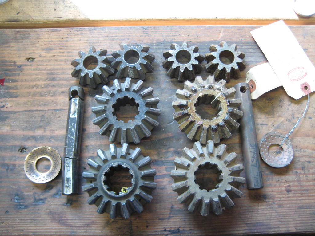

Cvans 1,009 #112 Posted April 18, 2020 Got all the new parts gathered up and checked them against the old ones and everything matches up. Started cleaning things for reassembly (decades old cosmoline). It's really amazing how well that stuff protects from corrosion and how hard it is to get off. Even diesel doesn't make a good cleaner. Ayway decided to pull the pinion shaft and discovered that the outboard bearing is pitted. So now I have to find a bearing and race Monday as nothing is open on Saturday. One of the brake lines is kinked and will need some brake fluid also. I'd sure be a happy camper if I could get this put back together next week. 2 2 1 Share this post Link to post Share on other sites

Tractorhead 9,217 #114 Posted April 18, 2020 Great you find parts, are they Remanufactured or NOS ? In my eyesight it appears the left lower pinion is a little bigger in the inner, than the right one in inner also if i compared on the screen with a caliper, but this could maybe just a distortion on perspective on the pict. Great you have the Parts to reasseble they look good and usable. 1 Share this post Link to post Share on other sites

Cvans 1,009 #116 Posted April 18, 2020 3 hours ago, Tractorhead said: are they Remanufactured or NOS ? They are all new old stock. The boxes were literally falling apart. The hardest part was the pinion shaft. I had to laugh as the original price was written on the tag,71 cents. Cost today was $39.00 + shipping. 4 hours ago, Tractorhead said: In my eyesight it appears the left lower pinion is a little bigger in the inner, than the right one in inner I sure hope it's just an optical illusion. Now you have me wondering. I'll let you know but I'm pretty sure they are the same. 1 1 2 Share this post Link to post Share on other sites
Ed Kennell 46,818 #117 Posted April 18, 2020 It appears the two new small gears are just not placed beside the correct old gears. 1 Share this post Link to post Share on other sites
Cvans 1,009 #118 Posted April 18, 2020 It appears the two new small gears are just not placed beside the correct old gears. Kind of does look that way but they are all the same part number. 1 Share this post Link to post Share on other sites
Ed Kennell 46,818 #119 Posted April 18, 2020 Can't believe everything you see. 3 3 Share this post Link to post Share on other sites
Cvans 1,009 #120 Posted April 18, 2020 13 hours ago, Tractorhead said: In my eyesight it appears the left lower pinion is a little bigger in the inner, than the right one in inner The splines on those gears are the same size. Tried each on both axles and they worked fine. Thankfully! Tractorhead Hope your wife takes all the blankets tonight. Making gaskets now for the axles and the differential and cleaning out the differential housing. Hope no more issues pop up. 1 1 1 Share this post Link to post Share on other sites
Tractorhead 9,217 #121 Posted April 18, 2020 8 minutes ago, Cvans said: The splines on those gears are the same size. Tried each on both axles and they worked fine. Thankfully! Tractorhead Hope your wife takes all the blankets tonight. Making gaskets now for the axles and the differential and cleaning out the differential housing. Hope no more issues pop up. Pardon when i shocked you, that was not my Intention. 🙄 I just see the Pict and my eye tell‘s me they lower seems different, however. Glad that it was only a fail on my side, better than on your‘s. Think i go better, searching the blankets..😂😂 1 1 Share this post Link to post Share on other sites

Pullstart 71,020 #124 Posted April 21, 2020 I’m thinking the illusion of the gears being different size might have been the heavy oil preservative on the surface? 1 Share this post Link to post Share on other sites

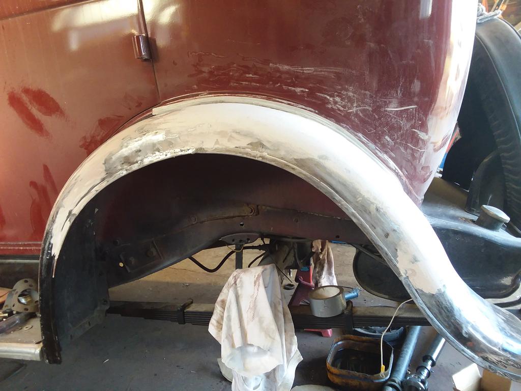

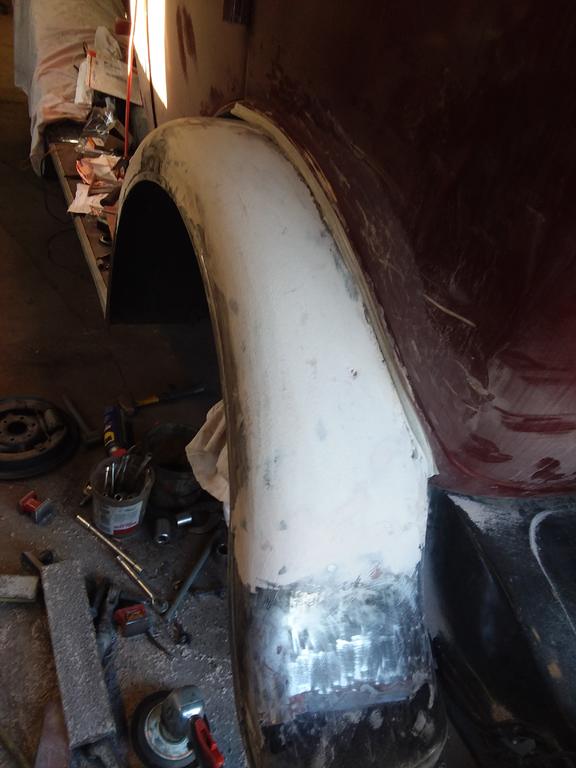

Cvans 1,009 #125 Posted April 22, 2020 This afternoon I spent some time with the hammer and dolly knocking down high spots. Then it was onto the Bondo, cheese grater, and sanding. It's not going to take a lot more and the fender will be removed and the back side done. The underside of the fender will get undercoated. A couple more afternoons and it should be time for paint. Forgot to pick up glazing compound so there will be extra sanding unless I get to town. 2 2 1 Share this post Link to post Share on other sites
