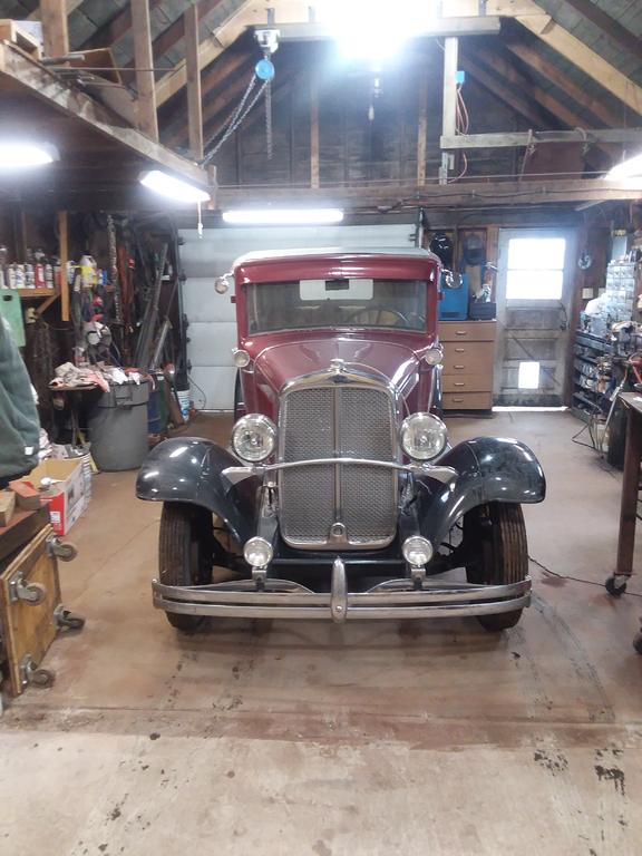

Cvans 1,009 #1 Posted March 16, 2020 (edited) Cleaned the shop this after noon and pulled the DeSoto in for some much needed attention. The U-joints are binding and the E brake doesn't want to stay on. As dirty as the oil is I'm thinking it's still got Non-Detergent oil in it. If working on the creeper goes well I might pull the pan and clean it and check the rod tolerances. I'd like to get it on Detergent oil. Oil pressure is a good 45 lbs at idle so I don't think they are too loose. Here it is in the shop a little bit ago. Edited March 16, 2020 by Cvans 10 8 9 Share this post Link to post Share on other sites

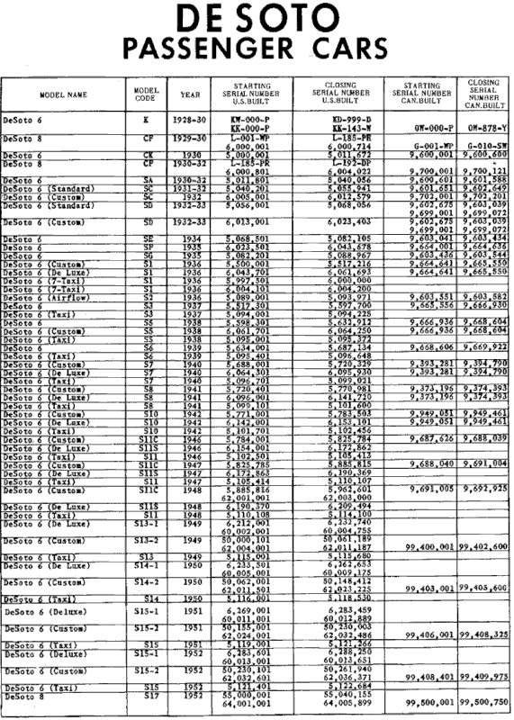

bc.gold 3,406 #9 Posted March 17, 2020 If you contact Chrysler Corp with your vin they can probably let you know the name of the dealer and possibly the first owner. Not sure when warranty's were added to car sales. The 1930 DeSoto CF production numbers begin at 6,000.001 ending at 6,000,714, I wonder how many of those have survived. 1 Share this post Link to post Share on other sites

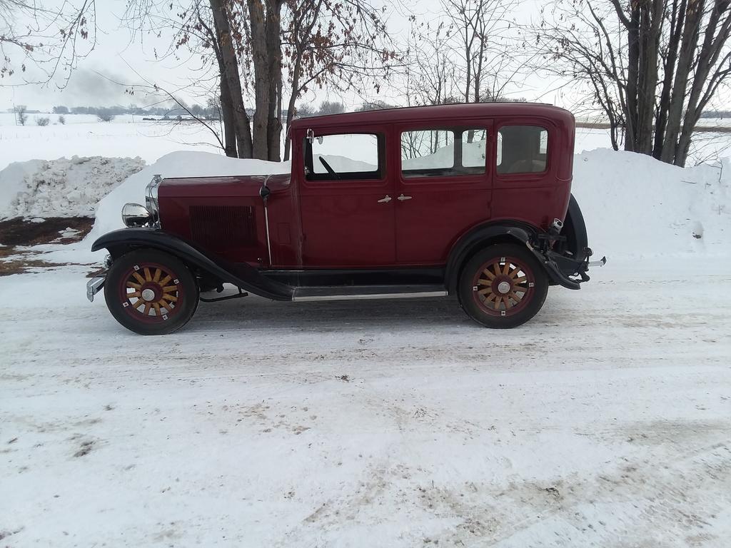

Cvans 1,009 #17 Posted March 17, 2020 Here it is setting in the driveway. The damage to the rear fender is the reason I was able to acquire it. Hit and run driver. 3 1 2 2 Share this post Link to post Share on other sites

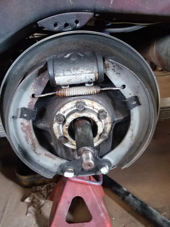

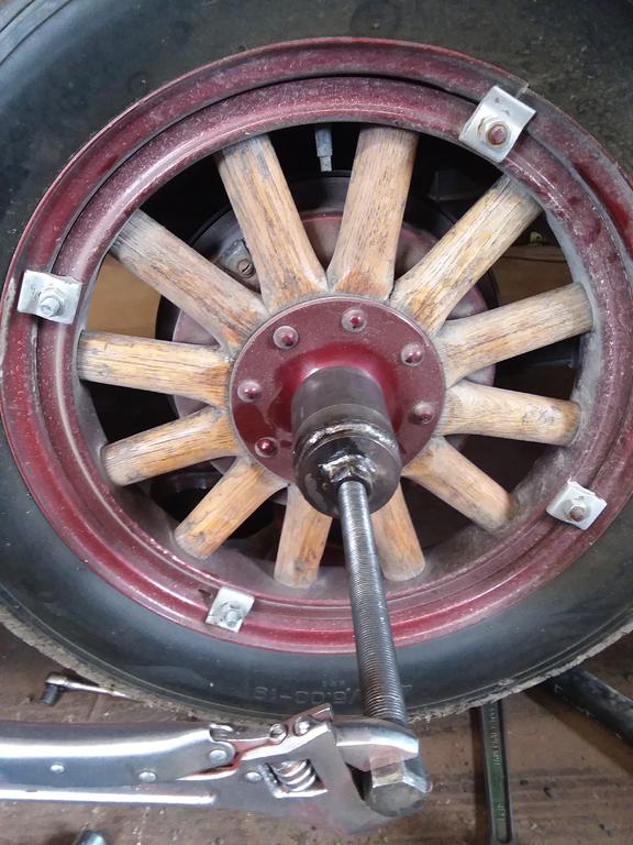

Cvans 1,009 #24 Posted March 18, 2020 Had build a wheel puller that screws onto the wheel. Fine threads. 16 tpi so used a boring bar to cut the threads. 2.304" inside diameter. It's fabricated after one that I saw on the internet. The wheels and brake drums on these vehicles are one unit. They are held to the axle by a self-locking taper and a threaded nut on the end of the axle. Wheels and drums came off nicely but someone for some reason had pounded on the tapered part of the left axle. Going to have to clean that up. Brakes and drums look good. The thing that is amazing me about this project is everything is coming apart without a fight. I'm hoping it continues this way. 4 2 Share this post Link to post Share on other sites
Stormin 9,988 #25 Posted March 18, 2020 (edited) That wheel is really something. Hydraulic brakes as well. Edited March 18, 2020 by Stormin 1 Share this post Link to post Share on other sites
