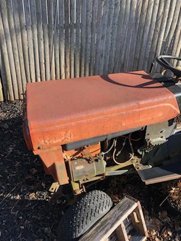

Bill D 2,678 #13 Posted March 14, 2020 The pulley was held on with a key and 5/16" spiral pin. 1 Share this post Link to post Share on other sites
ZXT 2,401 #14 Posted March 14, 2020 Being a hydrostat, that is a MTD/Wizard 990. Good tractors and I've always wanted one. For some reason i just like the way they look. If it were me, the engine would stay on that tractor and I'd make it a worker! Share this post Link to post Share on other sites
Bill D 2,678 #15 Posted March 14, 2020 I was only allowed to take the engine. The owners wife wanted the tractor as a lawn ornament for her garden. Any idea who made the hydro for that machine? It had a filter which surprised me. 1 Share this post Link to post Share on other sites
ZXT 2,401 #16 Posted March 15, 2020 7 hours ago, Bill D said: I was only allowed to take the engine. The owners wife wanted the tractor as a lawn ornament for her garden. Any idea who made the hydro for that machine? It had a filter which surprised me. I'm not sure. I'll have to look! Share this post Link to post Share on other sites
