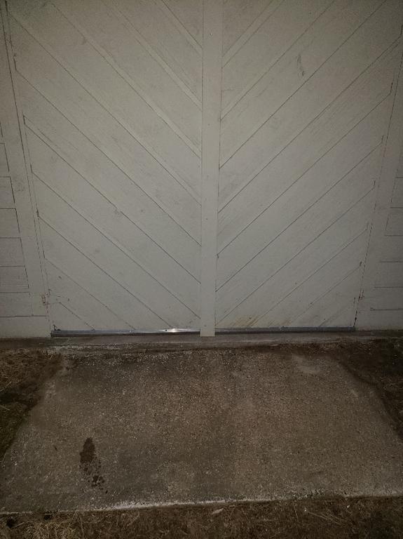

Part of my issue with the water is there is concrete that extends about 4" past the shed. (The whole floor is concrete)
Then there is a small concrete pad about 2" below the door. I am not sure how to get rid of the water that just sits there and doesn't drain.

Pictures would do us bench racers a heap of good to understand the pooling issue.  I imagine improving drainage some how could be done, but not knowing the lay of the land there might be a totally obvious reason it doesn’t work.  It seems there are solid doors that hinge up and out to where maybe only 30% of the door folds into the garage and the rest becomes an overhang?  Is that an option?

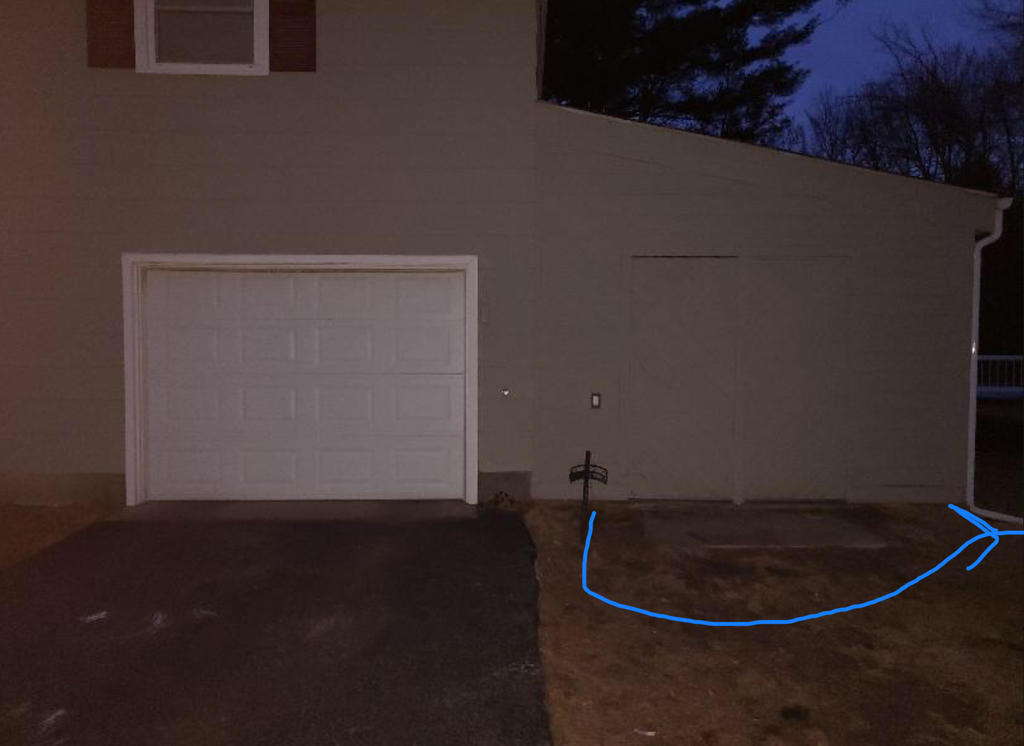

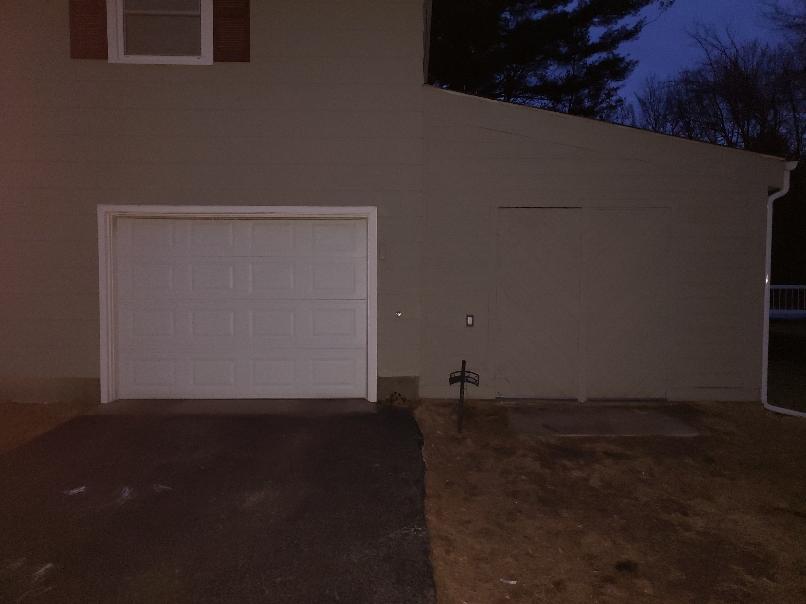

Here are some quick pictures. My wife wants to make sure it "matches" or looks clean with the door next to it. I tried to show how the concrete and different layers work.
It looks like there is ample room around the concrete pad to add drain tile, or as mentioned even pea gravel to assist drainage efforts.  I’d run the tile from between the two slabs around the front of the small one then past the garage to the right to start.

Pic

In addition to what @pullstart suggested, you could mud jack the slab to raise one side of the slab up to meet the garage floor, leaving the other side where it is. This will tip the slab away from the garage and move the water away...
My Dad did this on 25’ of sidewalk 4 years ago to address settlement and it is still perfect. No settling. He paid about $250...
This is a great idea to deal with the water.  I would also go with the same double door, but raise the bottom up 1 3/4 inches.  Under the door I would add a pressure treated 2x6 to raise the entrance.  Tractor then would have to drive over this new threshold, but that would not be a problem.  Door bottom would now be above any standing water.  The extra height would also give you the ability to add a bit of flashing to keep water from seeping between door and threshold.
Edit #1 - Heavy layer of caulking under the new 2 x 6 threshold to prevent water from seeping under it.
Edit #2 - If needed the 2 x 6 threshold could have a front and back taper cut length wise to allow easier rolling.  Would probably keep 1/2 inch square lip edge on the bottom of both sides.
Edit #3 - I foresee one problem with this solution.  If you use a mower deck will it clear a 2 x 6 threshold. Might need a bit of test or additional ramping.

Thanks for the suggestion. I love the threshold idea. I definitely think that would work and could definitely solve my problem. I have done aluminum ones in the past with a lot of success. I have also thought of doing it with concrete possibly as well to make a smoother ramp. Something like this. It keeps it lower and not as tall so I don't snag on mower decks etc. I have had a problem because of the lip from one piece of concrete to the other and was debating on doing an elongated ramp almost.
