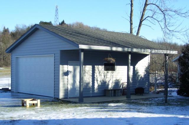

Not a real detailed amount of information but here is the barn that dad put up just over 3 years ago......

My detached garage is 30 x 24 exterior dimensions with a single double wide garage door. I wish it was bigger. I have 2' deep shelving on one side for tools and 3' deep work benches on the other. In the end opposite the garage door it an old kerosene furnace (that I believe is missing parts, it was there when I moved in, I need to get rid of it). That space sure closes in on you fast. If I have stuff stacked on the work bench (which I always do...) and have to set up an extra work table (like I do right now...) and I can't get the 416-8 to start (because the battery is dead... like this past tuesday...) and I have to pull my full size reg cab long bed truck in (because the transmission is acting up... grr.......), it's pretty cramped.
Definitely go as big as you can afford. I think I would go 5" on the concrete, but you could probably get by with 4". Floor drains are a must, especially if you get much snow and plan on parking inside (or parking your Horse in there after you've plowed!). I don't like the single floor drains, I prefer the trough drains that go clear across the floor or even the pre-made floor drains that are rectangular (long and narrow). I just hate rolling my creeper down into that stupid round floor drain.......
