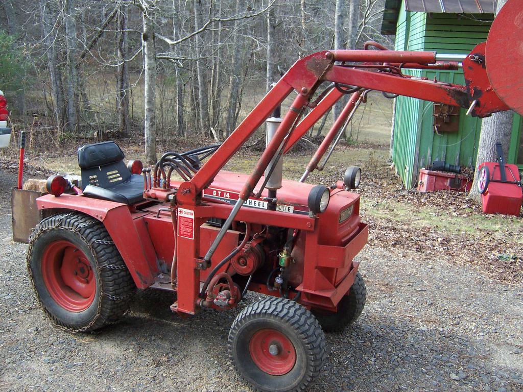

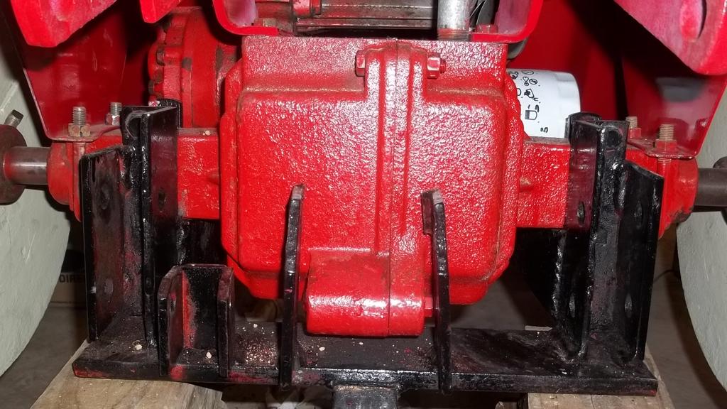

Oldskool 6,678 #126 Posted March 17, 2020 8 minutes ago, 953 nut said: Rear half of the Sub-frame for the GT-14 attaches to the rear axle and bolts to the frame near the center. The other half is attached to the frame at the front and attaches to the uprights making it a rigid unit. The whole idea is to transfer the stress and added weight to the wheels, not the frame of the tractor. Thanks for the pics. Which make/model FEL is that? Share this post Link to post Share on other sites
953 nut 69,147 #127 Posted March 17, 2020 17 minutes ago, Oldskool said: Which make/model FEL is that? It is a Johnson Workhorse which was mounted on the GT-14 when I bought it. 1 Share this post Link to post Share on other sites

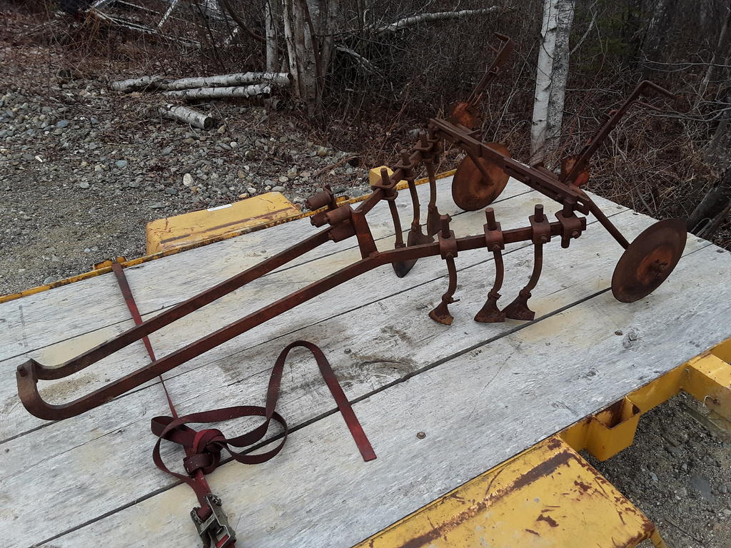

Oldskool 6,678 #144 Posted March 29, 2020 Found another little item today. What is this called? What ever it is it's on it's way to a new home. 2 Share this post Link to post Share on other sites
ebinmaine 80,619 #145 Posted March 29, 2020 Haven't the foggiest but it's cool 1 Share this post Link to post Share on other sites
Oldskool 6,678 #146 Posted March 29, 2020 It's made by David Bradley 1 Share this post Link to post Share on other sites
RandyLittrell 3,945 #147 Posted March 29, 2020 It's a cultivator. It does look like a David Bradley model. Randy 1 Share this post Link to post Share on other sites
Oldskool 6,678 #148 Posted March 29, 2020 1 minute ago, RandyLittrell said: It's a cultivator. It does look like a David Bradley model. Randy It has the DB metal tag on it 1 Share this post Link to post Share on other sites

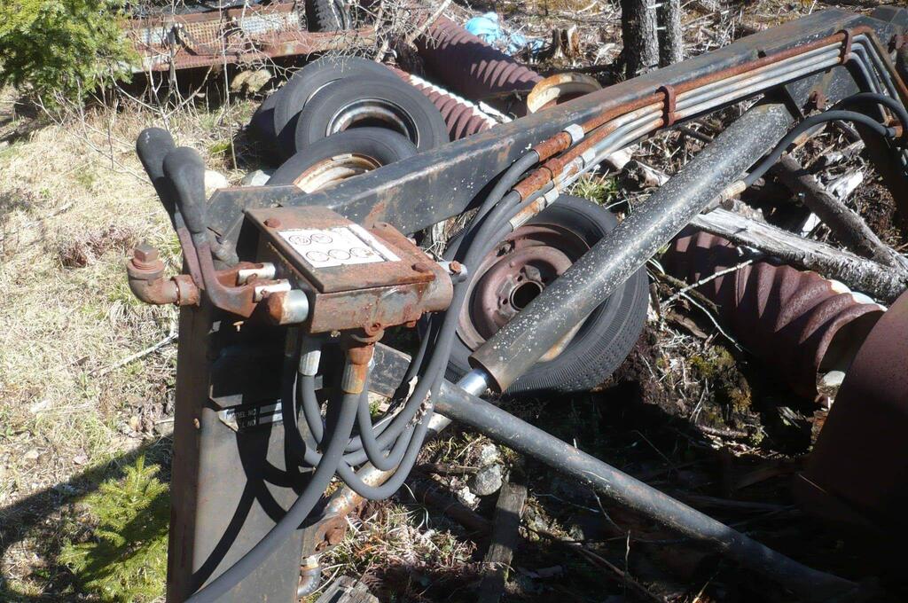

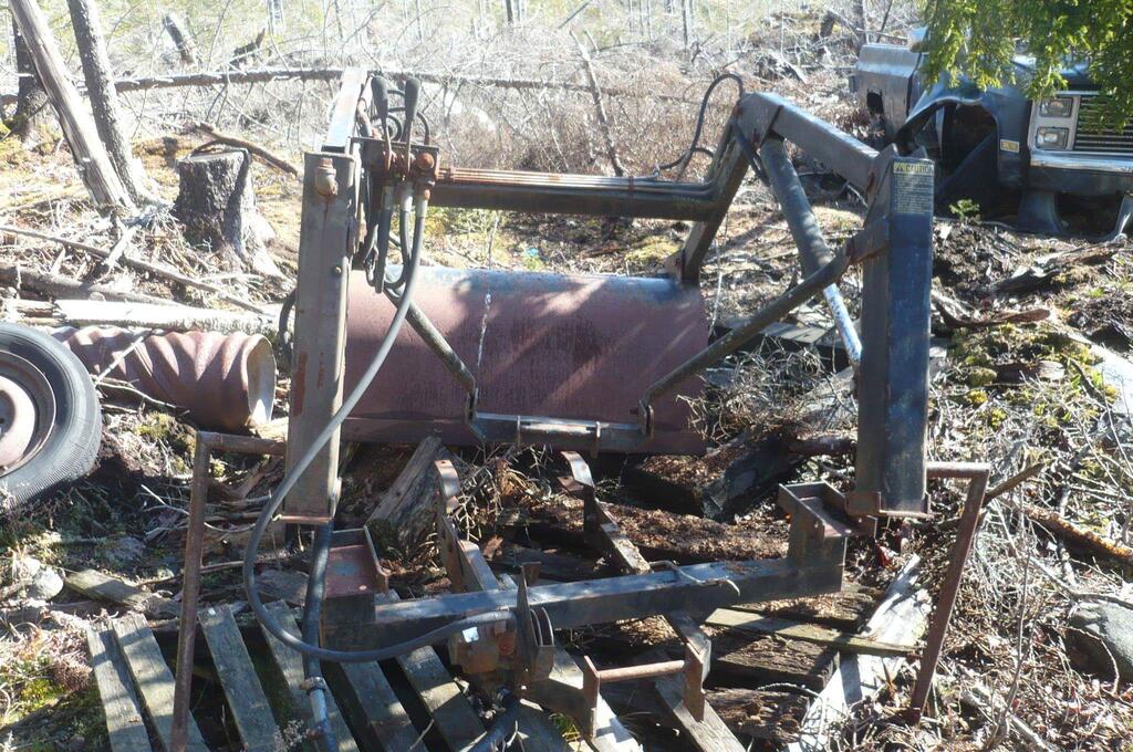

Oldskool 6,678 #149 Posted May 2, 2020 Been pretty busy lately. Not so busy that I'm not looking for parts lol. So this is something I ran across a while back but may have finally secured the deal. 1 2 Share this post Link to post Share on other sites
ebinmaine 80,619 #150 Posted May 2, 2020 The man with the loader.... Super cooooool 1 Share this post Link to post Share on other sites
