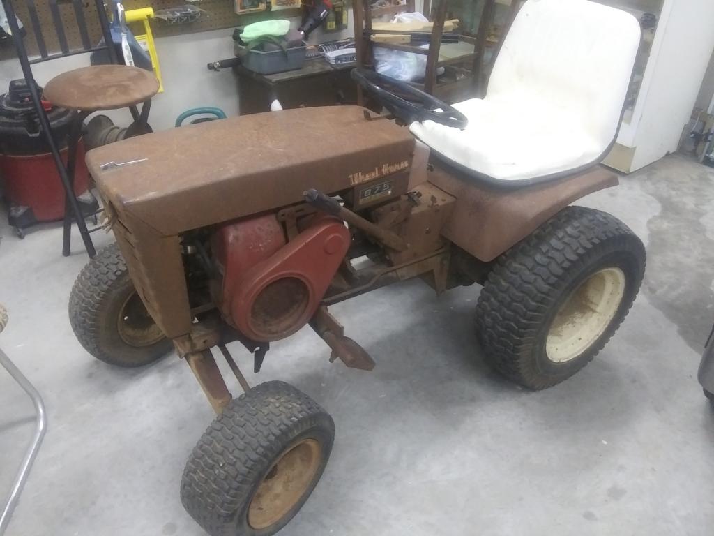

Mowinglife26 1 #1 Posted March 2, 2020 (edited) I am looking for the right size deep lug garden tractor tires for my 1965 875 i am restoring. What are y'all using? Edited March 2, 2020 by Mowinglife26 Share this post Link to post Share on other sites
WHX?? 57,923 #2 Posted March 2, 2020 Wow talk about patina! Carlisle tru powers in 23 -10.50 12's would be my choice as shown here… 1 1 1 Share this post Link to post Share on other sites

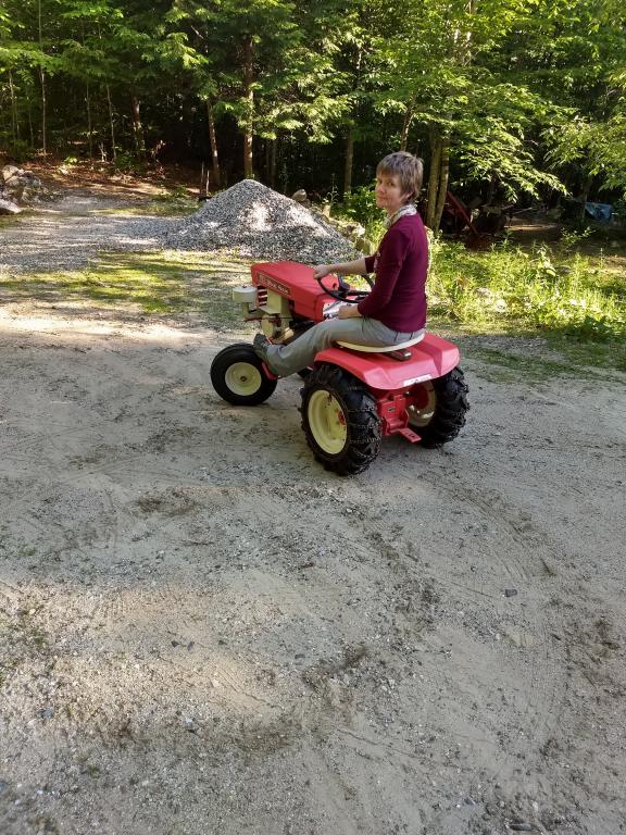

ebinmaine 80,465 #4 Posted March 2, 2020 1 hour ago, Mowinglife26 said: right size deep lug As stated above there is any number of different ways you can go. When you say deep lug I think of AG tires. I'm not sure what the actual correct size was for your make and model. 6 - 12 is what we put on My Honey's Pony tractor. Share this post Link to post Share on other sites
Achto 32,523 #5 Posted March 2, 2020 23 - 8.50 x 12 would be the stock size for the rear but 23 - 10.50 x 12 will fit well also. Carlisle or Firestone would be my brand of choice. Here is a source for both sizes. You can let your budget choose the brand that's right for you. https://www.millertire.com/categories/lawn-garden-tires/23x-8-50-12/ https://www.millertire.com/categories/lawn-garden-tires/23x10-50-12/ By the way I noticed that your tractor does not have the correct rims on the front. Those deep dish front rims were used on the later model 's. No need to change them if you like them, just thought I'd give you the heads up in case you were looking to completely original.. Share this post Link to post Share on other sites

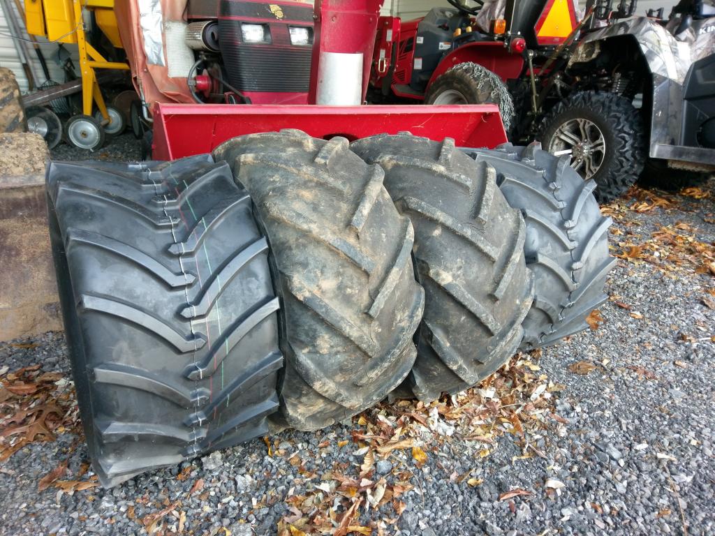

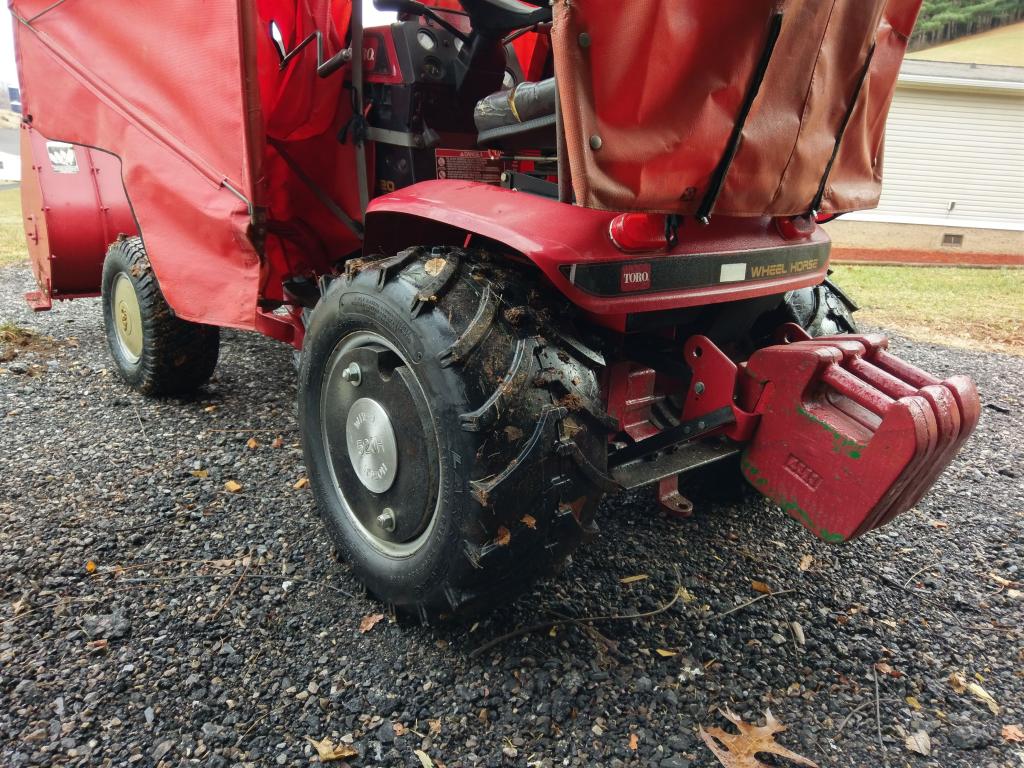

WVHillbilly520H 10,379 #8 Posted March 3, 2020 Those OTR Lawn Trac R1 IMHO are the best balance between traction in ALL conditions and budget... And they don't tear up the sod any worse than turf tires slipping and spinning out...Along with fluid filled and iron weights I have yet to need chains for any season with the OTRs. 1 Share this post Link to post Share on other sites
JCM 11,407 #9 Posted March 3, 2020 @WVHillbilly520H I have never ran anything but Turf tires but those R1's are some nice lookin rears on that 520. Could I use those tires and my wheel weights on my 520-H and not have to use chains when running my 44'' 2 Stage without any traction issues here in Maine, I have a long Gravel driveway. I would like not to have to deal with tire chains if possible. Share this post Link to post Share on other sites
ebinmaine 80,465 #10 Posted March 3, 2020 17 minutes ago, JCM said: @WVHillbilly520H I have never ran anything but Turf tires but those R1's are some nice lookin rears on that 520. Could I use those tires and my wheel weights on my 520-H and not have to use chains when running my 44'' 2 Stage without any traction issues here in Maine, I have a long Gravel driveway. I would like not to have to deal with tire chains if possible. Jim with enough weight you'd be fine except on icy spots and maybe on the hill near the road. 1 Share this post Link to post Share on other sites
WVHillbilly520H 10,379 #11 Posted March 3, 2020 1 hour ago, JCM said: @WVHillbilly520H I have never ran anything but Turf tires but those R1's are some nice lookin rears on that 520. Could I use those tires and my wheel weights on my 520-H and not have to use chains when running my 44'' 2 Stage without any traction issues here in Maine, I have a long Gravel driveway. I would like not to have to deal with tire chains if possible. @JCM... When I first bought my first 520H the Dicos would not hold air so the dealer had new Carlisle turfs on it that I ran for many years with just fluid weight and chains then I got the older AGs (also fluid filled and 70# iron wheel weights then the weight bar and 3 suitcase) seen in my last pic above but still had to run chains even on pavement then changed over to these and yet to need chains with the deuce or plow and the front ones really seem to help with the steering as well. VIDEO0124.mp4 VIDEO0125.mp4 2 1 Share this post Link to post Share on other sites

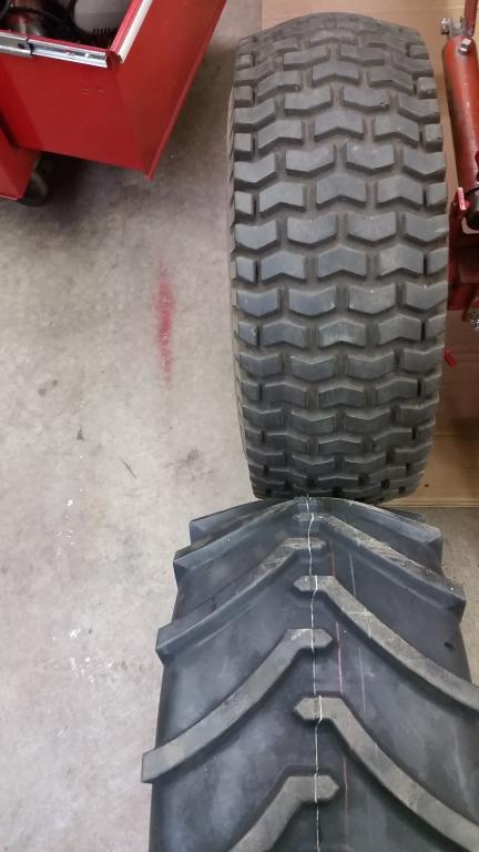

WildmanC120 615 #12 Posted March 3, 2020 How well do the tru powers in 10.5 fit a standard 7" wheel? Share this post Link to post Share on other sites

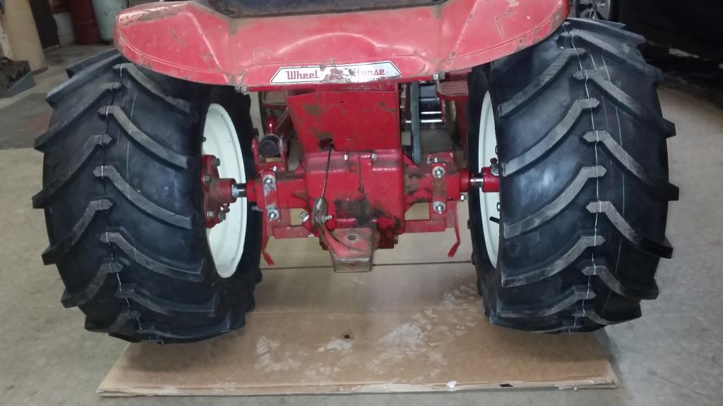

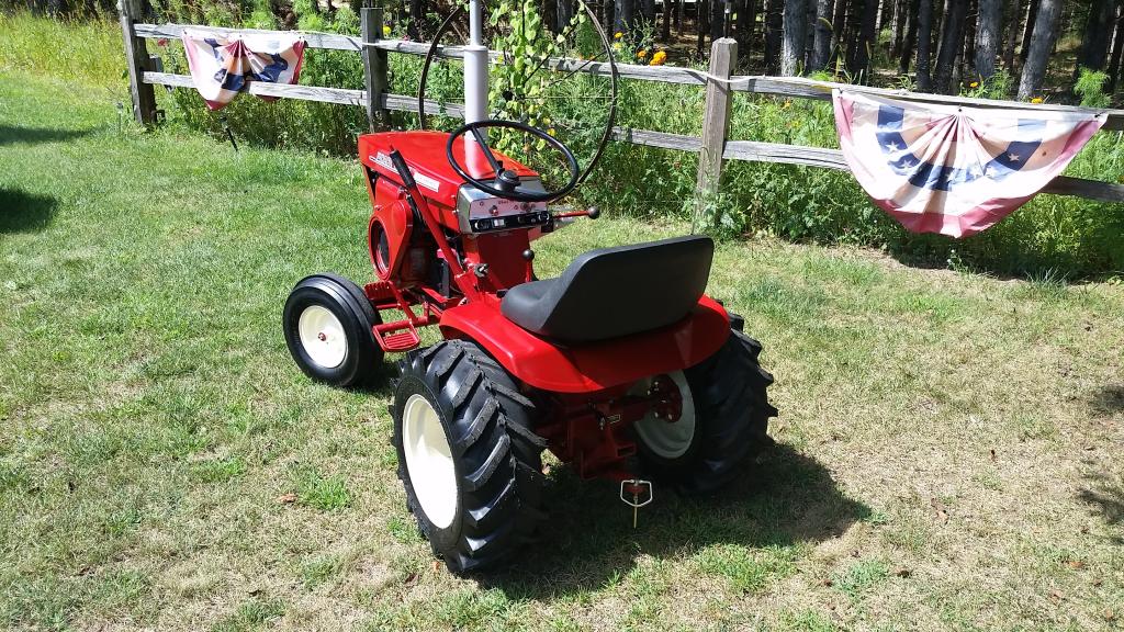

Mowinglife26 1 #13 Posted March 3, 2020 On 3/2/2020 at 12:04 PM, WHX24 said: Somewhere here Josh @PeacemakerJack has got a bunch of pics of his dad's restored 875 with ags on it...not sure what size. Here is one of it. So right here is the setup of the wheels and tires I am wanting. Where do i find these? Share this post Link to post Share on other sites

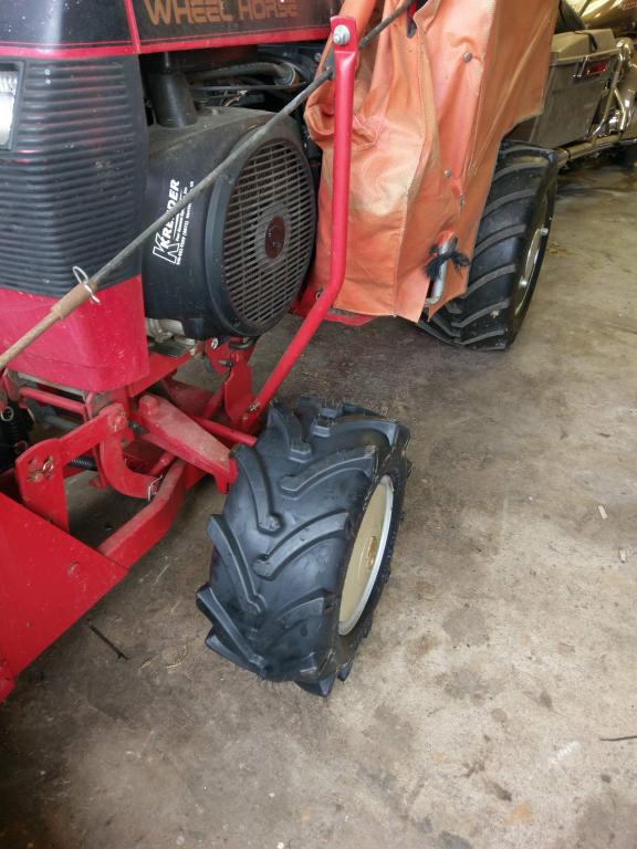

ebinmaine 80,465 #14 Posted March 3, 2020 29 minutes ago, Mowinglife26 said: So right here is the setup of the wheels and tires I am wanting. Where do i find these? The fronts are just like what's on Trina's Pony. I'm pretty sure those are Carlisle try ribs that she got on Walmart.com. Those are ears look like Carlisle's in the 8.5 wide. @PeacemakerJack would have to chime in for sure. He's been busier than a one-armed wallpaper hanger with an itchy back lately. If you search around a little bit you can find those online with free freight and still at a very reasonable price. Share this post Link to post Share on other sites

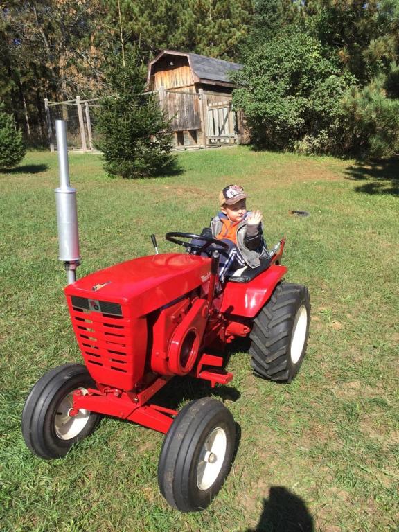

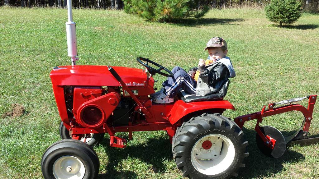

WHX?? 57,923 #15 Posted March 3, 2020 (edited) Yes those are tru powers on the rear in 23-8.50-12. they can be had just about anywhere including here https://www.millertire.com/products/lawn-garden-tires/23x-8-50-12/23x8-50-12-carlisle-tru-power-4-ply/ I thought the fronts are firestones EB??? They look like they have the higher center rib but maybe the Carlisle do too?? Got a pic of them EB?? Jack would know but yes busy. The Firestones are a real man's tire ….very beefy and command a price to match. Better suited for larger C series but look good on anything. https://www.millertire.com/products/lawn-garden-tires/16x6-50-8/16x6-50-8-firestone-3-rib-front-4-ply/ Those are what's on the front of my pic post 2. Nother pic of Jack's boy on a 875 Edited March 3, 2020 by WHX24 Share this post Link to post Share on other sites
ebinmaine 80,465 #16 Posted March 3, 2020 5 minutes ago, WHX24 said: Yes those are tru powers on the rear in 23-8.50-12. they can be had just about anywhere including here https://www.millertire.com/products/lawn-garden-tires/23x-8-50-12/23x8-50-12-carlisle-tru-power-4-ply/ I thought the fronts are firestones EB??? They look like they have the higher center rib but maybe the Carlisle do too?? Got a pic of them EB?? Jack would know but yes busy. The Firestones are a real man's tire ….very beefy and command a price to match. Better suited for larger C series but look good on anything. https://www.millertire.com/products/lawn-garden-tires/16x6-50-8/16x6-50-8-firestone-3-rib-front-4-ply/ Those are what's on the front of my pic post 2. I'd have to double-check her tires to be honest but I'm fairly sure they are in Carlisle. I don't have a great picture of the front of the tractor handy but they are what's on the front in the picture earlier in this thread that shows her on the tractor. Seems to me they were only about $30 or $35 each, shipped. Share this post Link to post Share on other sites

WHX?? 57,923 #18 Posted March 3, 2020 (edited) Just got a text from @PeacemakerJack he says they are indeed Firestones 16x16.50- 8 He did a big thread on that tractor if you a 875 fan. Tire sizes are all listed there. Edited March 3, 2020 by WHX24 1 Share this post Link to post Share on other sites
