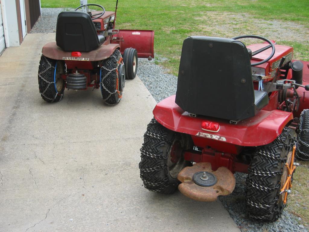

pfrederi 21,095 #8 Posted February 21, 2020 First off a hydro is a better choice for snow blowing especially with a single stage blower. You can vary your speed to keep the blower full. Single stages do not throw well if they are not getting enough snow. OK if you only have an 8 speed you can make it limited slip. You will need a 10 pinion differential and if your tranny has a one piece mushroom gear you will need to get a two piece one also. As pointed out above WEIGHT and chains will be a huge help. Front wheel weights and chains will make controlling things when the blower is on the ground better. Lots of weight on the stern also. When you raise the blower (like to back up ) you unload the rear end. Turfs and chains are good Narrow tires and chains are better.... 5 1 Share this post Link to post Share on other sites

pfrederi 21,095 #15 Posted February 21, 2020 35 minutes ago, AHS said: @pfrederi what do you have for rear tires? What size are they? They are narrow!!😁👍 6.00x12 the chains are US Army surplus for jeeps 6.00x16 cut down. Weed made in US an tough... 1 Share this post Link to post Share on other sites
AHS 1,698 #16 Posted February 21, 2020 1 minute ago, pfrederi said: 6.00x12 the chains are US Army surplus for jeeps 6.00x16 cut down. Weed made in US an tough... Ok! I was gonna say, they look like some old tires for my fathers 63 Jeep!😁 Share this post Link to post Share on other sites
