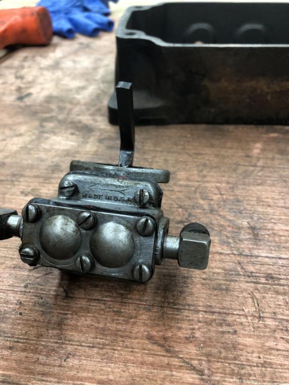

The Tuul Crib 7,354 #3 Posted February 18, 2020 I do have an old metal original fuel pump that I'm sure that I can get a kit for it to rebuild it from then and now automotive. I'm just wondering if I should just go to the electric fuel pump route instead. Share this post Link to post Share on other sites

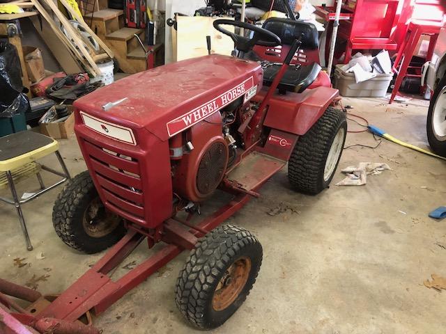

The Tuul Crib 7,354 #6 Posted February 18, 2020 8 minutes ago, ebinmaine said: What model tractor? It's the 14 horse that I just got done going through. It's on my 1067. I went to change the oil and there was a lot of gas in the oil. Not good! I've been looking at several electric ones and what I understand that you need no more than 3 pounds PSI at one amp. 1 Share this post Link to post Share on other sites

ebinmaine 80,772 #12 Posted February 18, 2020 4 hours ago, ZXT said: I would suggest rebuilding the original metal pump that you have. Electric pumps are unnecessary, especially on tractors that have tanks under the hood. They could pretty much gravity feed if they had to. On one with the tank under the seat, I could see where an electric pump would be helpful for priming purposes if you let the tractor sit for a long time. That's the thought I had as well. Definitely agree that an underseat tank should have one. If it was running ok with the other pump I'd rebuild the old metal one .... 1 Share this post Link to post Share on other sites
