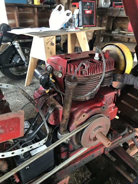

dv800special 5 #34 Posted February 24, 2020 Ok, if I am reading the ignition diagram right, it shows the b+ going to the ignition. So on a conventional 5 prong ignition switch would the “M” prong or magnito prong be the correct connection spot for the b+ from the rectifier? Share this post Link to post Share on other sites
ebinmaine 79,513 #35 Posted February 24, 2020 1 minute ago, dv800special said: Ok, if I am reading the ignition diagram right, it shows the b+ going to the ignition. So on a conventional 5 prong ignition switch would the “M” prong or magnito prong be the correct connection spot for the b+ from the rectifier? No no no..... There are two types of standard 5 prong ignition switch. Do you have a points, battery ignition? Have you verified that you have the right type of switch? M is magneto. B is battery. R is rectifier / regulator. S, solenoid. A, if it has one is accessory. 1 1 Share this post Link to post Share on other sites
dv800special 5 #36 Posted February 24, 2020 I don’t know. It has an external coil and condenser. Does that mean it doesn’t have points? Share this post Link to post Share on other sites
dv800special 5 #37 Posted February 24, 2020 11 minutes ago, ebinmaine said: No no no..... There are two types of standard 5 prong ignition switch. Do you have a points, battery ignition? Have you verified that you have the right type of switch? M is magneto. B is battery. R is rectifier / regulator. S, solenoid. A, if it has one is accessory. Also this is the ignition type from the previous motor, which had points. And a generator. Share this post Link to post Share on other sites
pfrederi 20,827 #38 Posted February 24, 2020 Based on the picture of your engine if you have an ignition switch with an M terminal it is the WRONG switch. You need one with an I terminal. The B+ wire from the rectifier goes to the R terminal. 3 Share this post Link to post Share on other sites

ZXT 2,402 #42 Posted February 26, 2020 2 minutes ago, dv800special said: @953 nut awesome diagram, very easy to follow. I bought a new ignition with the R. I’ll let you guys know how it goes I'm not sure how your tractor was running at all with the wrong ignition switch. On your new one, make good and sure that it has an I instead of an M. 1 Share this post Link to post Share on other sites
dv800special 5 #43 Posted February 28, 2020 (edited) On 2/25/2020 at 8:53 PM, ZXT said: I'm not sure how your tractor was running at all with the wrong ignition switch. On your new one, make good and sure that it has an I instead of an M. Well it was working bc I had a separate toggle switch with constant power that I could switch to allow the coil to function. But anyway I got it all rewired. Everything is on the new ignition switch and the battery is being charged. So thank you guys for the help. It was a great learning experience as well! @ebinmaine @953 nut @ZXT Edited February 28, 2020 by dv800special 1 Share this post Link to post Share on other sites
