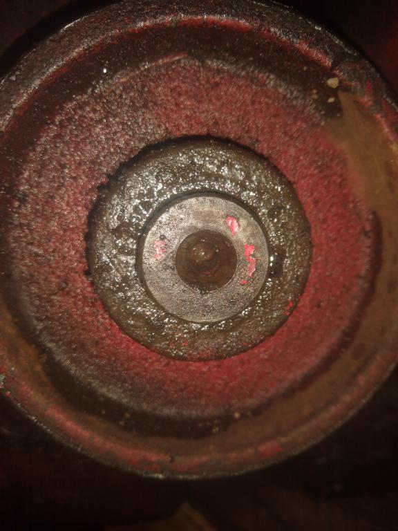

Psychonova68 36 #27 Posted February 6, 2020 I don't see a bolt or anything on the brake, what am I missing? And should I try to get the pulley off from the outside, the hubs weren't too bad? Share this post Link to post Share on other sites
pfrederi 21,095 #28 Posted February 6, 2020 Your brake with a round shaft and keyway "should" have had a snap ring. Looks like it is gone can you see the groove on the shaft it would have been in??? 1 Share this post Link to post Share on other sites

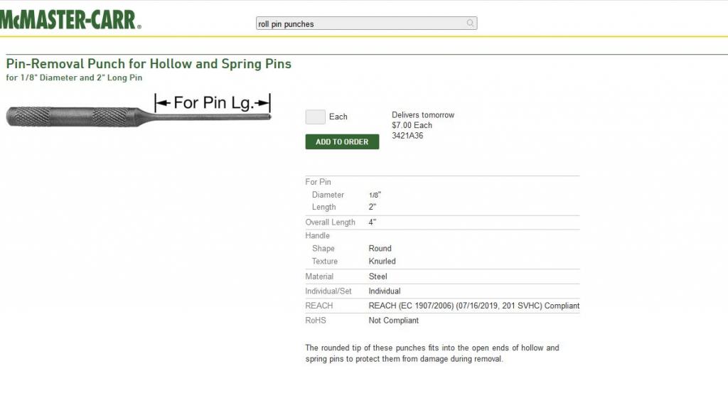

Psychonova68 36 #33 Posted February 6, 2020 The hi lo shift lever looks to be held on with a roll pin, any advice? I have had a lot of bad luck with roll pins with guns. Share this post Link to post Share on other sites
ebinmaine 80,456 #34 Posted February 6, 2020 1 minute ago, Psychonova68 said: The hi lo shift lever looks to be held on with a roll pin, any advice? I have had a lot of bad luck with roll pins with guns. Leave it set. No need to remove it unless removing the specific gears it's attached to. Share this post Link to post Share on other sites
pfrederi 21,095 #35 Posted February 6, 2020 (edited) 5 minutes ago, Psychonova68 said: The hi lo shift lever looks to be held on with a roll pin, any advice? I have had a lot of bad luck with roll pins with guns. It is a roll pin. a true roll pin punch is your best weapon.... Edited February 6, 2020 by pfrederi 1 Share this post Link to post Share on other sites

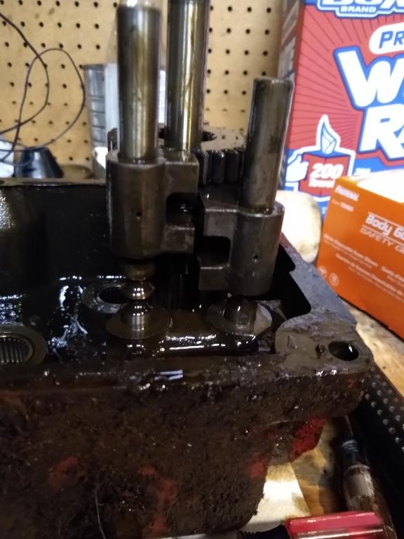

Psychonova68 36 #42 Posted February 8, 2020 (edited) How do the shift forks and associated gears come out? How does the detent ball plug come out, I think that's where my problem is. Edited February 8, 2020 by Psychonova68 further thoughts after looking at schematic Share this post Link to post Share on other sites
ebinmaine 80,456 #43 Posted February 8, 2020 8 hours ago, Psychonova68 said: How do the shift forks and associated gears come out? How does the detent ball plug come out, I think that's where my problem is. I can't remember if that was a well plug/freeze plug on mine or if they screwed out ... Steve's videos may show it. I can check in the shop later this morning. Be VERY aware of the position of those during disassembly. Those have been known to fly across the room and land in the most inconvenient non accessible place within a 40 mile radius. Share this post Link to post Share on other sites
oliver2-44 11,710 #44 Posted February 8, 2020 If the shifter worked fine before you took it apart, and the rails aren't rusty, you might try cleaning up the shift forks and rails in place. Getting the detent balls back in place on the rails can involve lots of frustration and losing the little balls (which you can get at the hardware store). Share this post Link to post Share on other sites
stevasaurus 23,816 #45 Posted February 8, 2020 You want Section III in this manual. It does a nice job of explaining the process... 1 Share this post Link to post Share on other sites
Psychonova68 36 #46 Posted February 8, 2020 I can't seem to shift either fork much, I can lift the R &1 fork a little, but I can't push the 2&3 fork down to put it in neutral and start pulling the forks out. 1 of the detents on the R&1 fork should be engaged, but I don't see what's keeping me from pulling it out. Any ideas? Share this post Link to post Share on other sites
ebinmaine 80,456 #47 Posted February 9, 2020 I didn't get it looking how the detent balls come out the end. Were you able to find them? Share this post Link to post Share on other sites
Psychonova68 36 #48 Posted February 9, 2020 I got it, I didn't realize I had to allow the shaft, I think it's the input shaft to go down. When I picked the case up and repositioned it, it allowed me to shift it into neutral and pull the forks out. The BBs just fell into the grease pool in the bottom, made sure to have my finger over the hole so they couldn't fly out. Just have to clean all the old oil out and inspect it now. 1 1 1 Share this post Link to post Share on other sites
